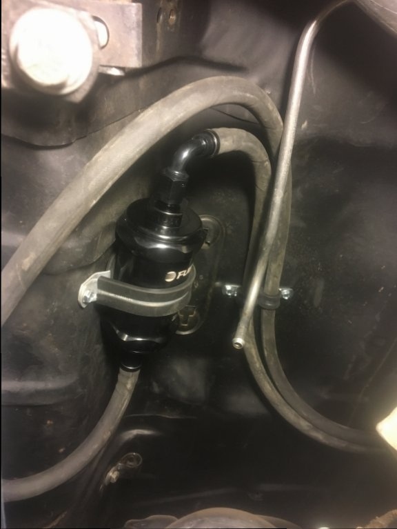

Right now I have a efi tank with a efi pump but I have a carb on it at the moment. So I have a regulator that returns the access pressure back to the tank, one line. I did buy 2 lines so when I finally switch over to the efi, I will add the other line.
