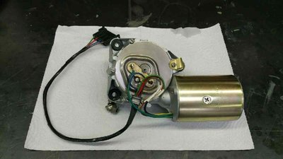

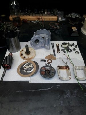

I redid my own. Pain in the *** but its done. Can be time consuming but very rewarding. I picked at it a little at a time, sometimes shelving it for months at a time while i repaired other parts.
I have maybe $150 in it in wire, winding paper, winding tape, shrink tubing, new firewall rubber gasket, new spades for plug, new stainless phillips screws for iron poles, brass flat stock sheet to fab a new ground strap, and fresh gold tone zinc cadmium replating of the motor cylinder.
I am going to build one more up for my sons car. Took 2 cores to make this 1 motor up. Make sure you use same years for parts. Running changes made every year.
Tested great on low, high, and park. Will only test that way on a bench because no rheostat to test with. Used Aeroshell 22 for the grease. Smooth and quiet.

What paint did you use on the motor case? Looks awesome.
I sandblasted the aluminum gear case , spray primered it, then painted it with krylon dull aluminum. The motor cylinder i had cadmium plated

Heres the thing, these motors arent rocket science, snd dont require any oddball tools to assemble that the aversge auto hobbiest wouldent have.
Remember stuff like this was built on an assembly line by low skilled labor. These had to be made easy to assemble, and ID10T proofed so stuff could not be put together wrong.
The wiring is a bit of a bitch, but not too much. Theres schematics.out there, and also use pix of restored vspeed motors to see what attaches to what color code wise. Passion4mopars does have a page dedicated to testing these, snd what to hook up to what to test 3 functions. Low, high, and reverse/park.

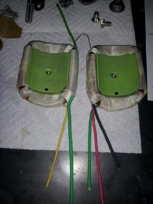

May I ask if you rewound the field winding?
And if so, did you just eyeball the wire size and number of turns or are there specs on them?

I carefully removed the messed up winding paper, and cloth wrap, and made new winding paper pieces to wrap the wire coils and rewrapped them with fiberglass cloth tape. I essentially rewrapped the original coils.
