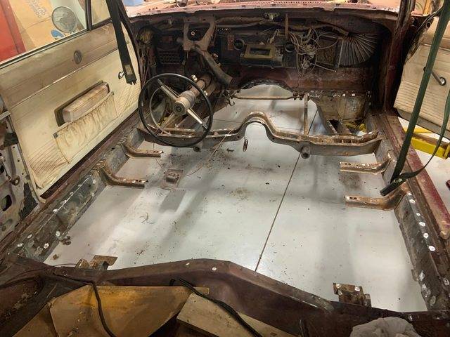

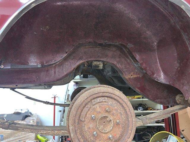

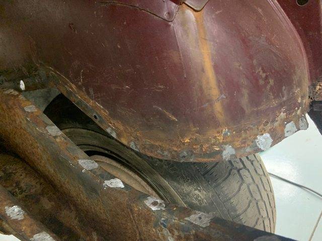

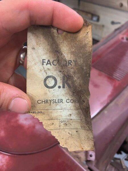

I pulled the dash frame yesterday so I could clean the window channel and firewall a bit and found a Chrysler inspection tag on the A/C box. I thought that was pretty cool. I ground down a bunch of spot welds in the cabin and trunk. I was surprised and pleased with the overall condition of the wheel tub lips. They were all solid except for where the two tub halves meet at the very back.

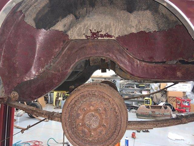

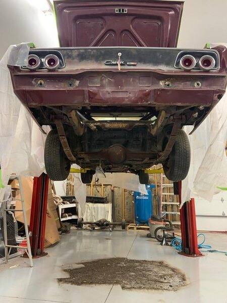

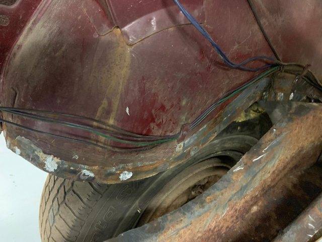

I've been putting off removing the undercoating from the rear wheel tubs because its such a nasty job but I finally started in on it yesterday. Small areas of the undercoating had fallen out over the years. This way I can seal and undercoat everything from the firewall back.

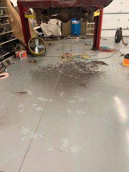

I used a $30 ebay needle scaler and if you haven't used one to remove undercoating, you really need to. It FLIES off....which is why its so messy!

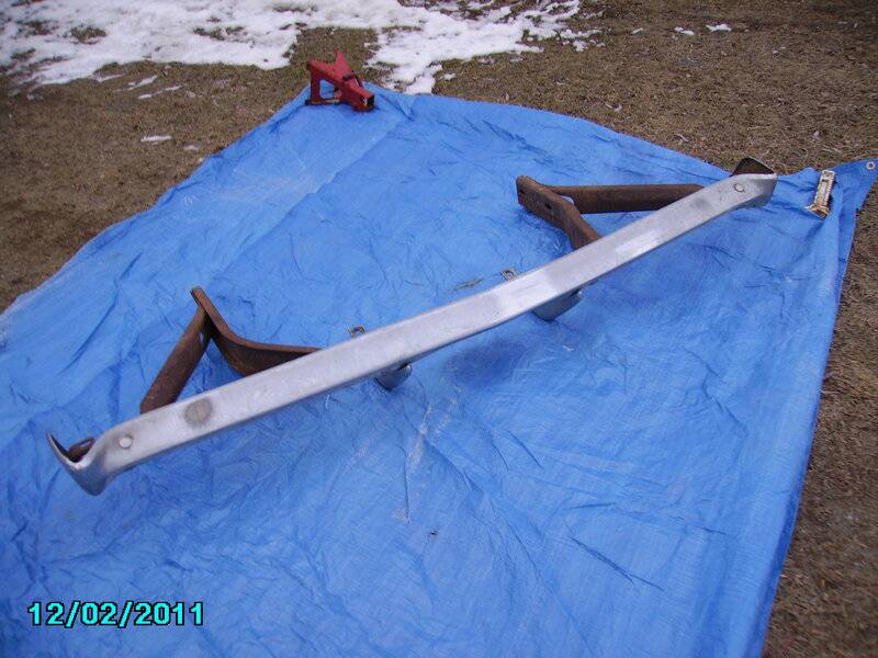

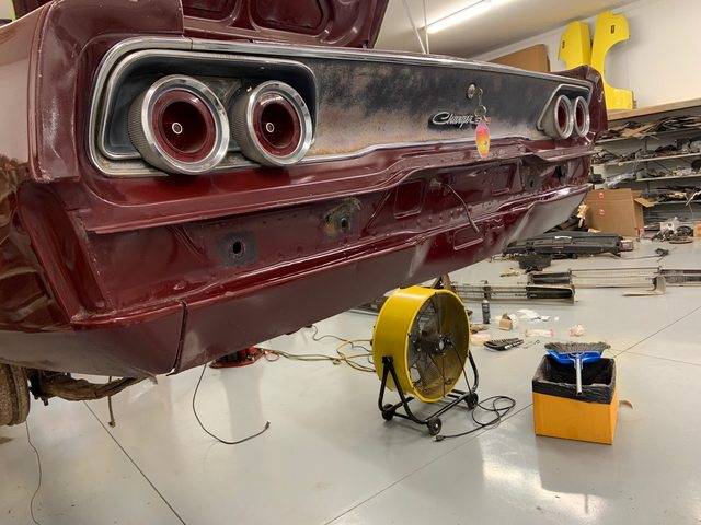

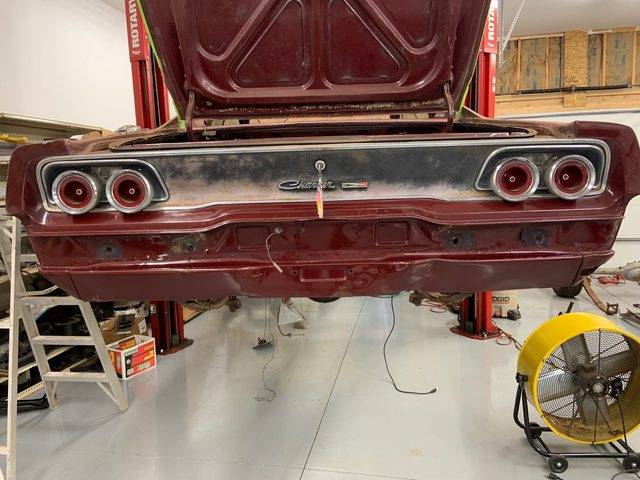

Since removing the rear bumper, the oxidized paint that was behind the bumper has been annoying me. Sounds stupid...but its polished now!
Dang, talk about the snowball effect. And here the way you started out this thread it sounded like you were just going to be able to clean things up and drive it. Par for the course on these old Mopars though, and I would be doing the same as you if it was in my garage. Just love the color combo of this car.

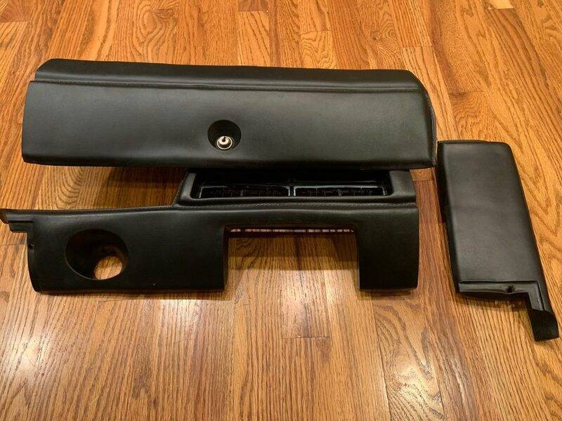

I'm finally getting back on this one. I am going through the dash now. I cleaned up the dash pads....so nasty. Just cleaned them and used saddle soap to condition them. They turned out better then I expected.
Those came out great! I can't believe those are the same ones.
After cleaning the pads did the saddle soap make a difference in the softness?
Or is there something better to soften the dash pads?
The saddle soap does soften them some. There may be a better product out there but this seems to do the trick.
