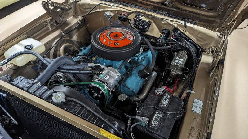

I'm seeing an Edelbrock Torker intake in the picture, which is a single plane intake. The Performer RPM would work really well but probably not fit under the hood with a stock air cleaner. I had almost the same engine combo and ran a Holley Street Dominator, and it was a great intake.

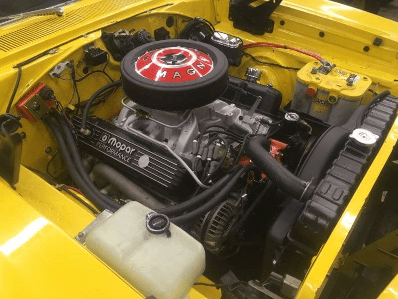

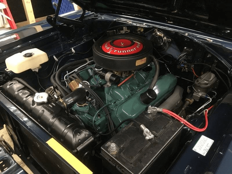

I have an RPM performer in my 68 Charger using the drop base from mancini racing to clear the hood on the stock air cleaner. Thats a 440 block stroked to 500" so you might be able to get away with the stock air cleaner base being a 383 low deck motor. I also run one in my Roadrunner with the 383 setup and a shorter air cleaner element with the stock base.
That looks great, thank you for the pics! Did you run either set up with a different intake before? And if so, did you notice any significant performance improvement?
The current intake is a Performer 383. I had a Street Dominator on the 505 ci stroker in a green '68 Charger I owned a few years ago and it cleared, but then I added a Sniper system and hit the hood. Ugh.
The charger I did not. That engine was built from scratch by myself. The roadrunner I did and it seemed to definately pick up some steam from the intake swap. The 383 in the Runner has 68 906 steel heads that have some serious port work and blending done and always ran really strong. It did however pick up a bit of the seat of the pants when I used this intake when I restored the car. I did nothing to the engine other than a teardown and inspection with new gaskets and timing chain installed at the same straight up timing as the previous chain which wasn't worn much. Figured while I was in there I'd do a new double roller. I'd say its worth the money and the strongest street/strip intake you will find while going to get ice cream and doing burnouts ha! It passed the test in my wedding collection burnout wise!
Great pic!! That is good info, thank you!!
