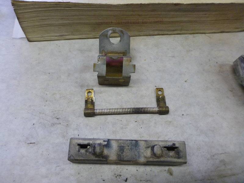

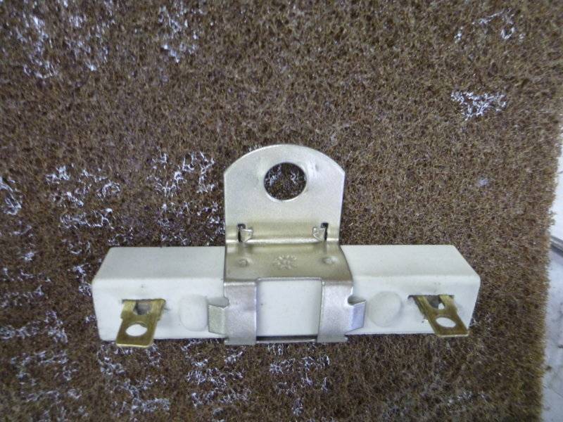

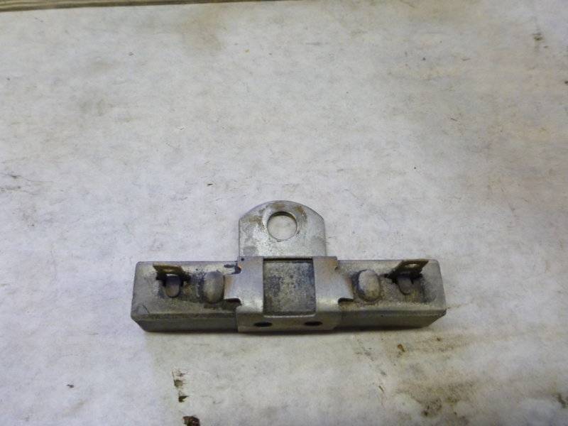

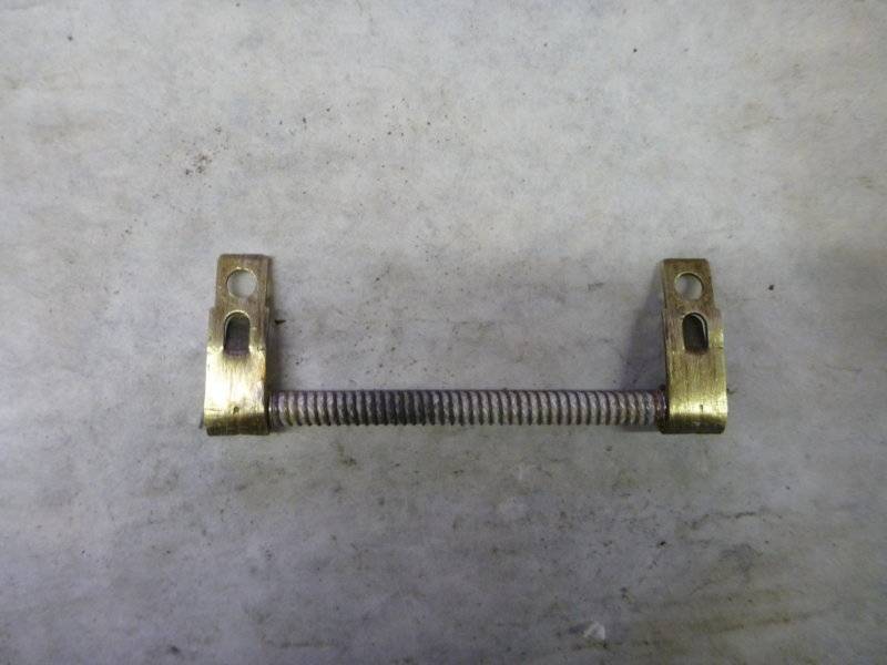

Yep, as Jerry says.. just take a spare, cut the resistor out of the back and replace it with a piece of wire. Pics show the parts.. apart. Cut the resistor out and reuse the tabs, then put the stuff back into the heat sink block.
Just pics I had when I restored my OE ballast. So remove the resistor and replace it with a solid piece of #10 or similar.

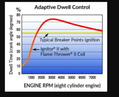

If I remember correctly, looking at the voltage chart Pertronix provides on their advertising/web site, it looks to me that a points ignition actually provides more voltage at very low RPM, then the pointless systems jumps right up and bypasses the point distributor like no tomorrow.
