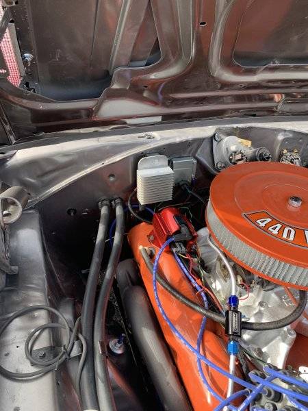

Please perform the celebratory burnout.My car had its original module, over 50 years and 150k miles, was working fine. I swapped because I wanted to play with an EFI system I picked up. Their instructions said I needed an ignition system that did not have a ballast resistor. Thats it. No expectations that it would add 50hp, just looking for some entertainment time from something i enjoy.
Thanks to everyone who responded with assistance. I'm up and running.
Great, what coil are you using now?Thanks to everyone who responded with assistance. I'm up and running.

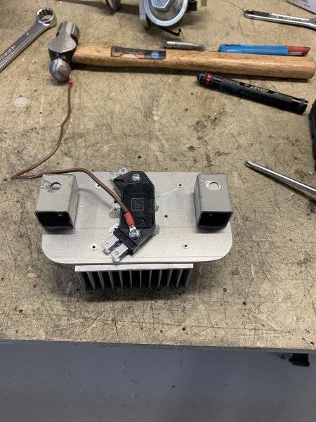

Thanks for the heads up, I wasn't tracking that. I was a bit gun shy to reorder another Pertronix 44011 so I looked for one that specifically said I could use it without a ballast resistor. Hopefully the additional heat sink I added to the mount helps keep it cool. If it burns up, I have a spare and will look into alternative solutions.Hope it works for you, I have read that these modules want 0.5 resistance coil though, but I am just experimenting myself.
Yes. But I ended up exchanging the 40111 (1.5 ohm) for another Pertronix 44011 (0.32 ohm). After a bunch of reading last night, it seems that it should work ok with the HEI module and no ballast resistor. The reading also suggested that the 1.5 ohm coil would shorten the life of the module. I'm going to just trust that the shipping damage to my first unit was the root cause the failure of both the coil and the module. The 44011 gets installed tomorrow. I already swapped to an AC Delco D1906 HEI Module from the Delphi unit.Are talking about a heat sink for your coil or the one you added to my 3d print for the module ?
