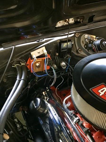

And do I still use the ballast resistor?

I run 3 ohms (1.5 coil + 1.5 resistor) in my Pertronix electronic ignition. They say you can remove the ballast and run 1.5 ohms but there is no harm (and it's actually good in reducing the stress on the IGBT switch in the module) and I saw no performance or signal difference on the oscilloscope with 3 ohms (coil + resistor) or 1.5 ohms (coil) total. Then again I never rev it past 4000 RPM either. The only real benefit is if you wind the snot out of it. At really high RPM 3 ohms limits the current enough you can't get the coil charged up to full potential in the time frame between firings.
Which new electronic ignition?
Summit brand
