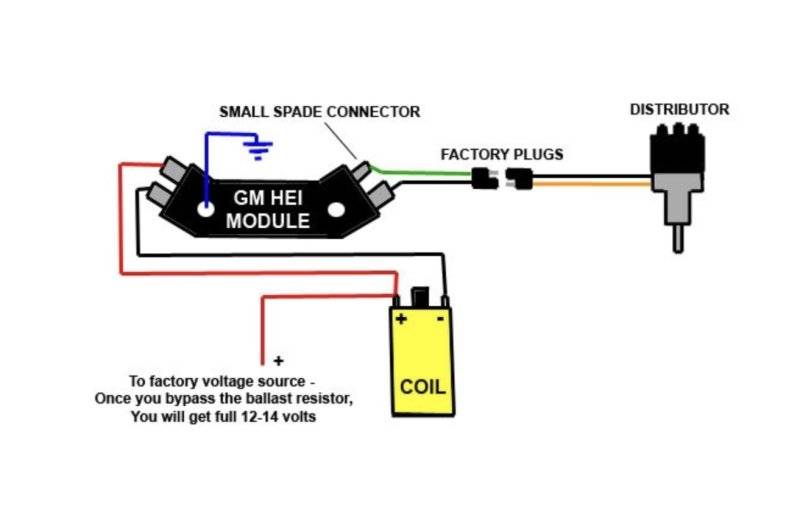

- If you want to improve your ign system, run bigger plug gaps, you need an ign system that eliminates the bal res & uses an E core ign coil. This can be done using the Chrys stock elec ign dist to trigger a GM 4 pin HEI module, diagrams on the net. Very simple hook up.
- the mag p/up is very reliable, but if the vac adv has been hooked up, they can fail after high mileage. This is because VA operation flexes the p/up wires.
Here is the wiring connection for an GM HEI Module to the Chrysler ignition systems. The one Geoff 2 referred to above.
Ron

If you want a better ign system than the Chrys ECU, use the GM 4 pin HEI module. See post #26 & others.
No, you can retain the coil for use with HEI but you have to use the bal res with it if that coil is designed to use a bal res. You will not get the best out of the HEI unless you use an E core coil with 0.4-0.6 ohms pri resistance.
