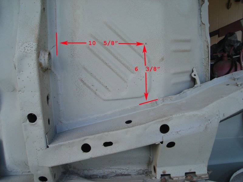

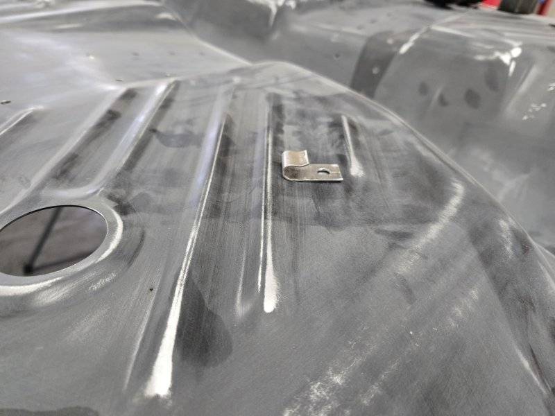

Need pic of this bracket and location and pic, diameter and dimensions of gas pedal holes in the front floor pan.
I took one off the original pan but it was rusty and had to make a new one so just want to make sure it looks like the factory one.
OK, I thought I found a blurry pic that showed double hooks. Mine must have had one side rusted off, I guess I`ll have to remake it. If you find better detailed pics that would be great. Thanks!

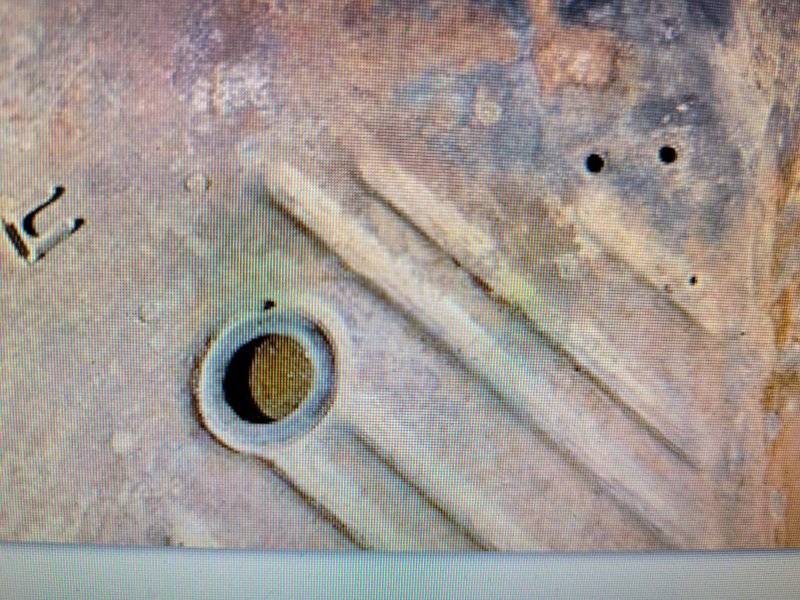

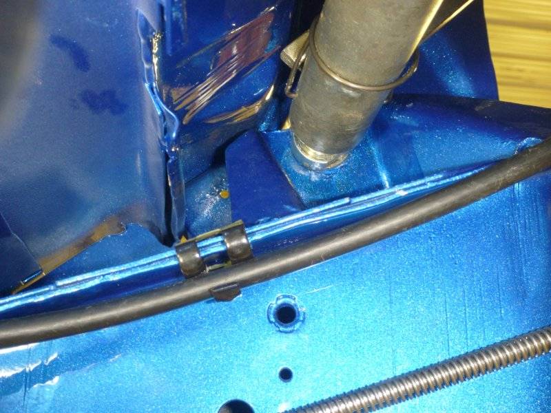

Not sure why my desk top won't load this one. Took a shot with my phone off my monitor.. Gas pedal left bolt hole is straight fwd from the last pan "roll"

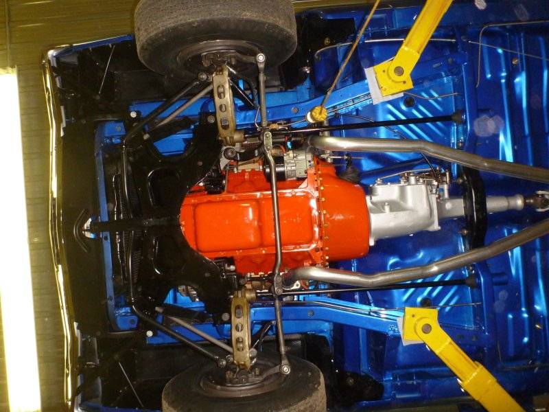

My 70 RR has original floors - they were surprisingly in good shape and did not need replacement.

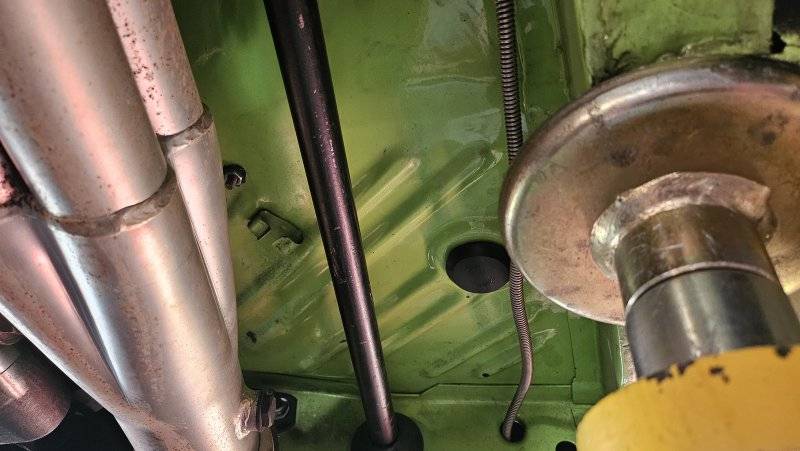

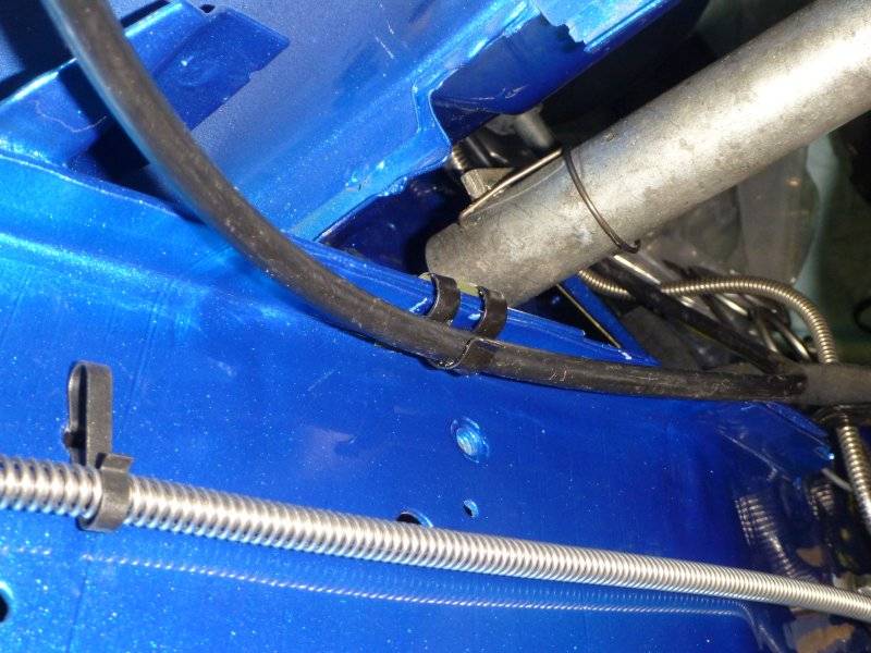

It is hard to get a good picture with the car on the lift. I can confirm what @dadsbee said that it is a double hoop. Note that mine is not used now because I have a Passon A-855 overdrive and the speedo cable is attached on the opposite side of the transmission.

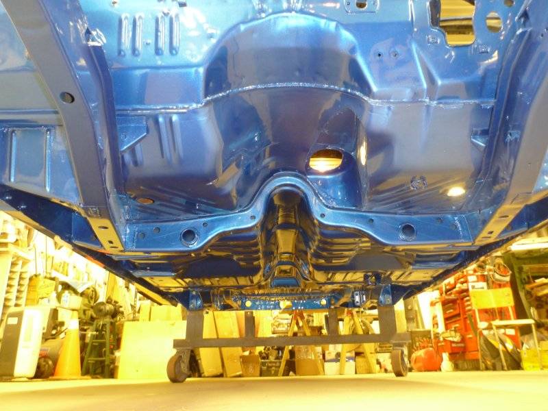

Here is a picture of that same floor prior to restoration:
Thanks! I really thought mine was only one loop as it didn`t look like the other part was rusted off as it was a straight, clean edge. Unless there were two different versions - what plant was yours built at?
My car was built October 1969 in Los Angeles.
