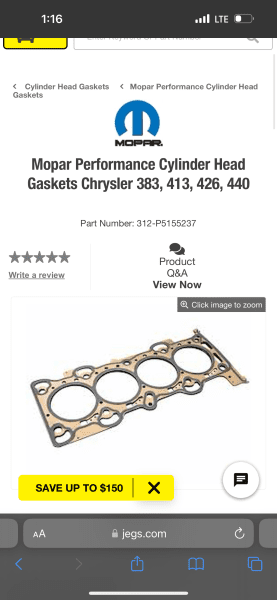

Also, are mopar performance ones any good? They have a set at .025 which would bump up my CR a bit. With a 0.039 head gasket, I should get 10.4:1. I would assume the .019 difference would make it 11:1 or so? The cam manufacturer recommended a minimum of 10.5:1.

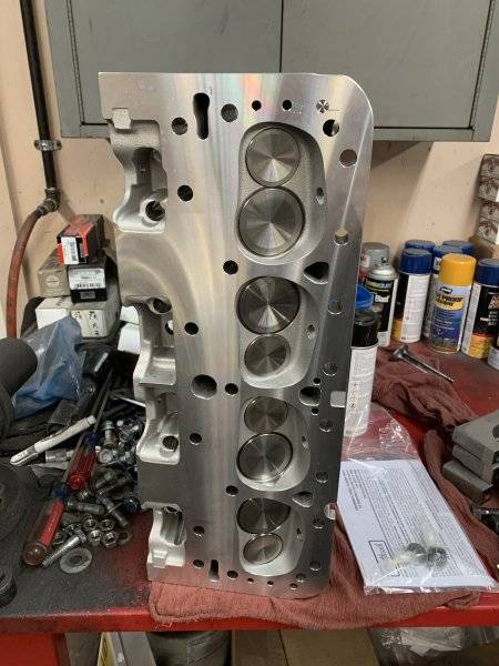

What heads? Myself I would not use these. I would use a composite.

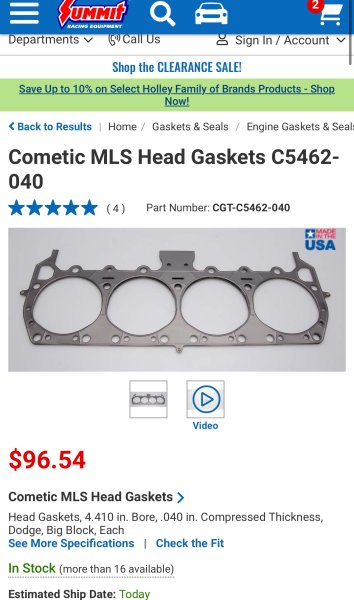

Something like this?
Yes, 4.410" @ 0.040" Thk. If no one has any in stock, call Cometic at 800-752-9850
