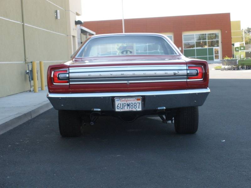

Hey guys, I think I want to put sprint mags on my coronet, but wanted to see pics first. 15x8s in back and 15x7s in front with 275 60 15s out back (10 3/4 wide) and 225 60 15s up front. Opinions on fitment and need for relocation kit of springs. Thanks for pics guys!

I have 265- 50- 15 on the back. 10" wheels 4.5" back space no problems . springs in stock position.
Yeah, you don't need to mess with the springs to mount a 275 60.
I have 275 60r15's on my 68 coronet. They are mounted on wheel vintiques, 15 by 8 in size.

295 50 15's on the back of my 69 Coronet. Plenty of room. 8" rims. Waiting for pics.
