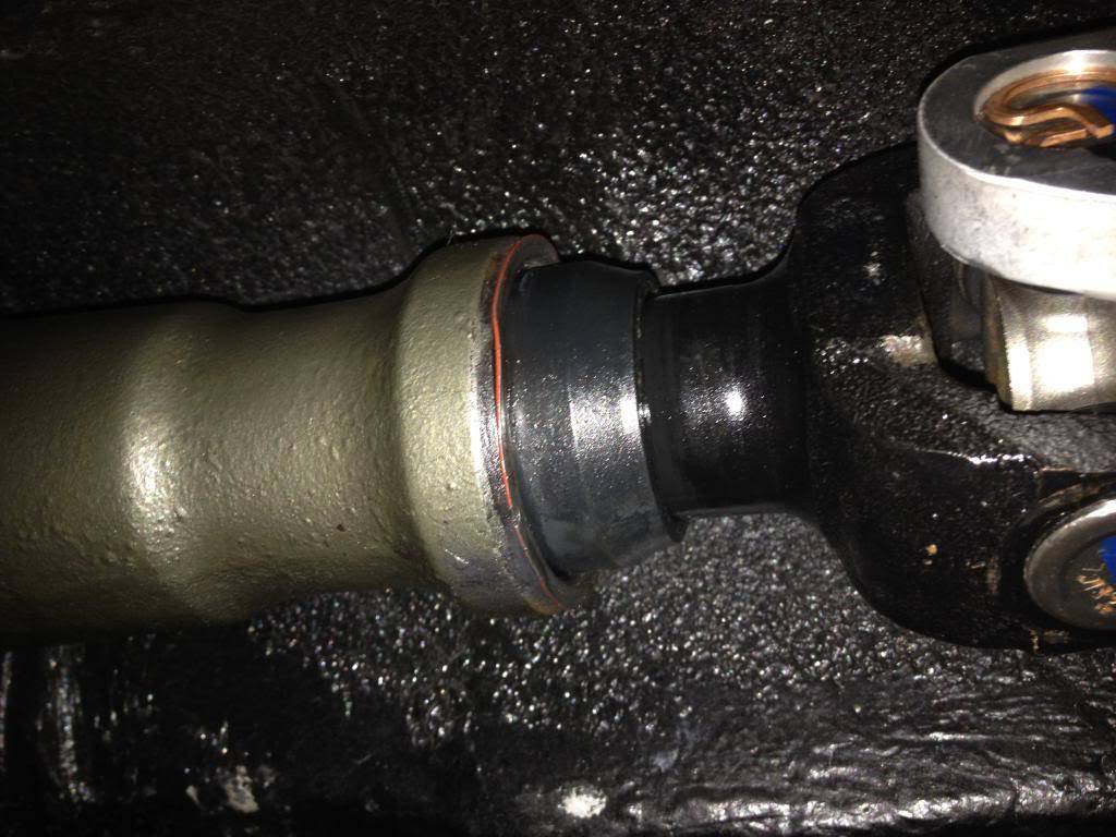

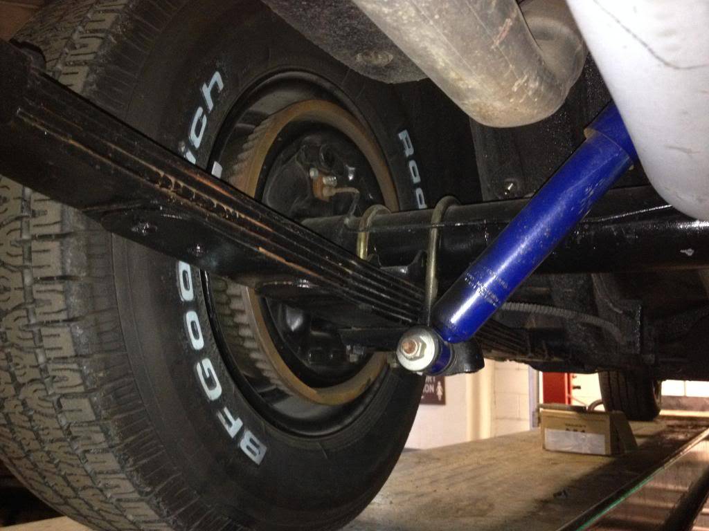

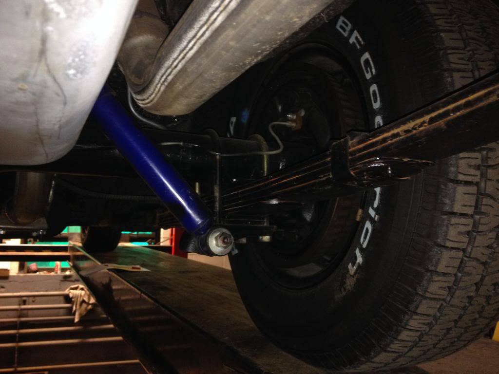

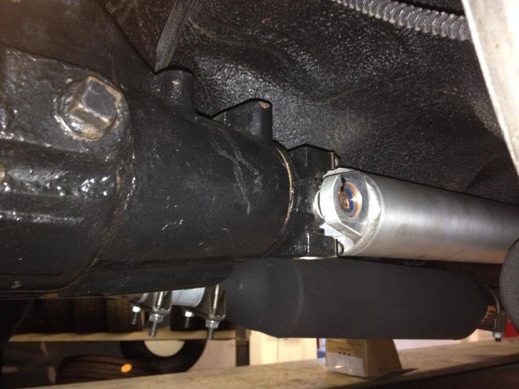

Yesterday I was finally able to get the car on a lift and the pinion angles are within about one degree of each other..all the mounts look good and are tight. I've attached some pics so if anyone sees something obvious please chime in. One thing I did find was there is some play in the tailshaft area of the tranny. If I hold the driveshaft try to move it, there is some vertical play in the slip yoke area. The U joints are brand new so it isn't that. When I move it there's an audible "clunk" and it can be heard all the way up in the transmission when standing directly under it. Would this be indicative of a worn tailshaft bushing or bearing?? Like I said earlier, the transmission is the only part of the car that isn't brand new or rebuilt very recently. I have no idea if it's ever been worked on, in fact. It does shift perfectly fine, however.
The pinion angle shouldn't be where it is right now, it should be below the angle of the shaft
So you're saying to lower the rear right? It's tough to get a good pic of the slip yoke area up front but it's pretty much level/up just a hair.
Yes point the diff down some, right now it looks just over the shafts angle and when you're driving its way beyond that, lower it a few degrees
Ok. I have the mopar wedges, think I should just go straight to the 3º or go in little increments?
Thanks. I only have 1,2&3 deg ones so I'll try the 1deg and see what it looks like. I have no idea how much they actually wrap up under acceleration. With a totally stock setup is it normal to ever have to correct the angle? Maybe the springs are tired and allow it to move more than usual? I'll keep you posted, thanks again for your help.
You want the pinion to start angled down so that when it's under power it ends up more or less level. One degree down from where you are now won't even get you level at rest IMHO.
You're wasting your very important time with STARTING with a 1 degree.
Start with 3/4 degree based on that pic, and if i was to put a angle finder on the shaft and joint at the end yoke i'd probably say more, but based on the pic start with a 3/4
Sry maybe I'm not reading this right...do you mean 3 or 4 degree or 3/4 of a degree as in .75? Lol that why I said start w the 1 degree.
