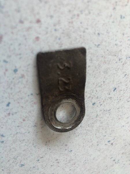

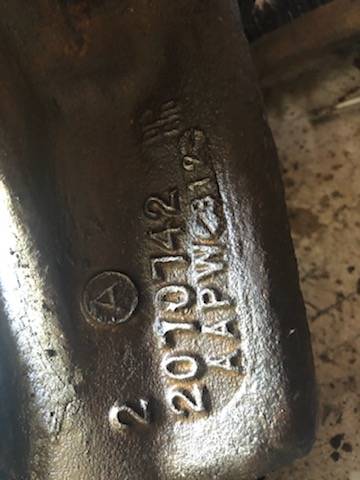

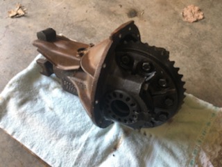

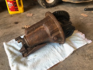

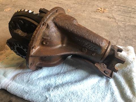

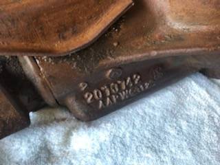

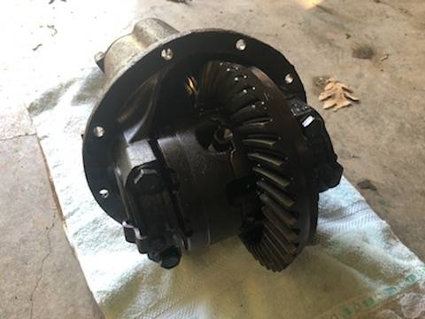

Can anyone please help me confirm/identify this third member which came out of a 1962 Imperial. I suspect it is a 8 3/4 SURE GRIP with 3:23 gears which is what the tag (not pictured) has stamped on it. Any help greatly appreciated.

742 case is the stronger one for the bigger cars or HP motors so I think you are correct on your assessment.
You say you have the tag that says 3.23 and SG ?
It is a 742 housing with a clutch type sure grip. The ratio should be stamped on the ring gear. It is a strong unit, and new clutches are available if needed.
Great unit, no matter where it came from.
That is the best set up there is for an 8.75.
742 housing & clutch SG.
be careful interpreting the ratio on the ring gear
there are several numbers, some of which are valid or very close to valid ratios but are NOT the ratio of the gear
