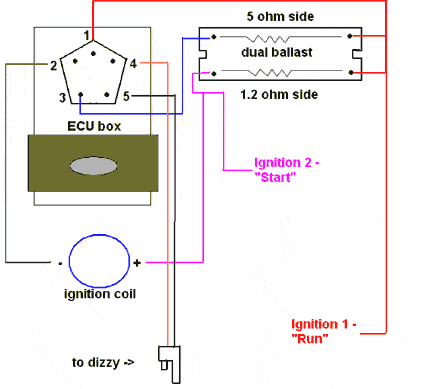

need help/info from any one that has went from points(mallory yl) to electronic ignition--67 440 motor--any help sugg. appr.
I've had good luck with the Mopar conversion kits. Everything you need comes with. Jegs has them for $225.
here. you need an EI distributor , EI box, the ballast , and the wiring pigtail. they sell complete kits

I really like the Mopar stuff too. I see MSD this and MSD that all the time, but that Mopar conversion is hard to beat IMHO.
Geez 225? Been a while since i had to buy one. I think I paid 125 last time. That was a while ago obviously. They are a breeze to install and worth every penny. The only drawback to the factory dizzy is fine tuning the advance curves is a bit of a pain since they are deep inside the thing.
Pertronics works great if you want to keep your original looking distributor. Other than that Mopar Performance is the way.
