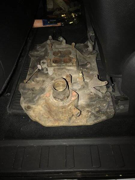

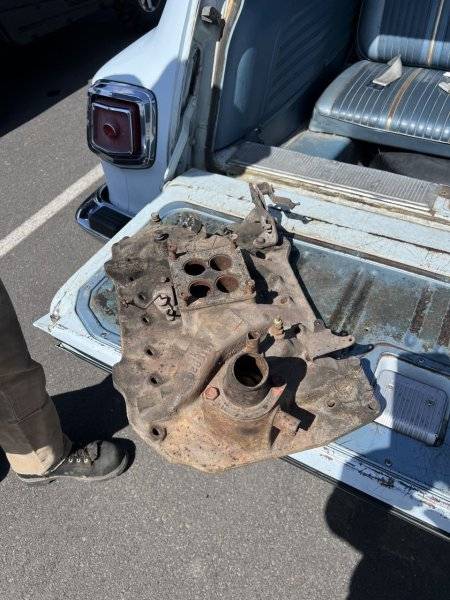

I know this is has been dormant for a bit, but I figured I'd let you all know I found a poly318 four barrel intake and I purchased it. I only have one crummy picture.
It looks dingy, but I think it'll clean up nicely. My plan is to do the work this winter and have it ready to go once the nice cruising weather rolls around this spring.

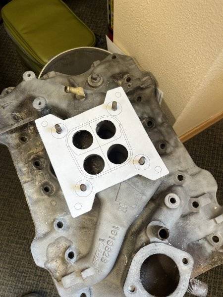

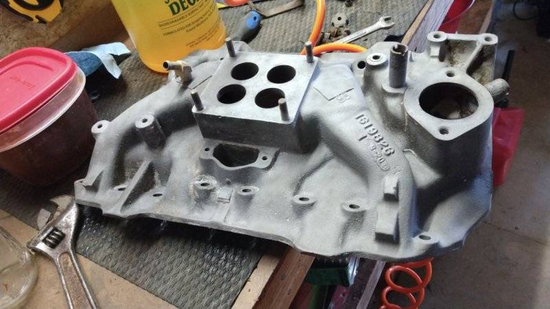

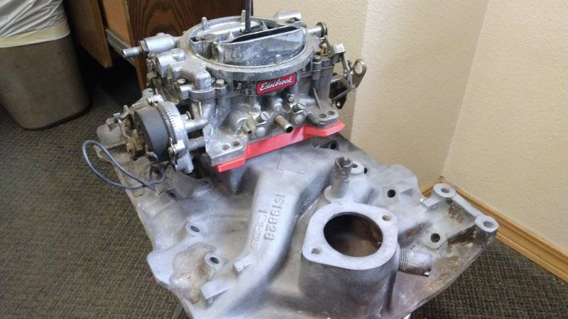

I am finally ready to get this leg of the journey started!
My buddy from work took the intake home last Friday to do a little cleanup on it.
It cleaned up pretty good.

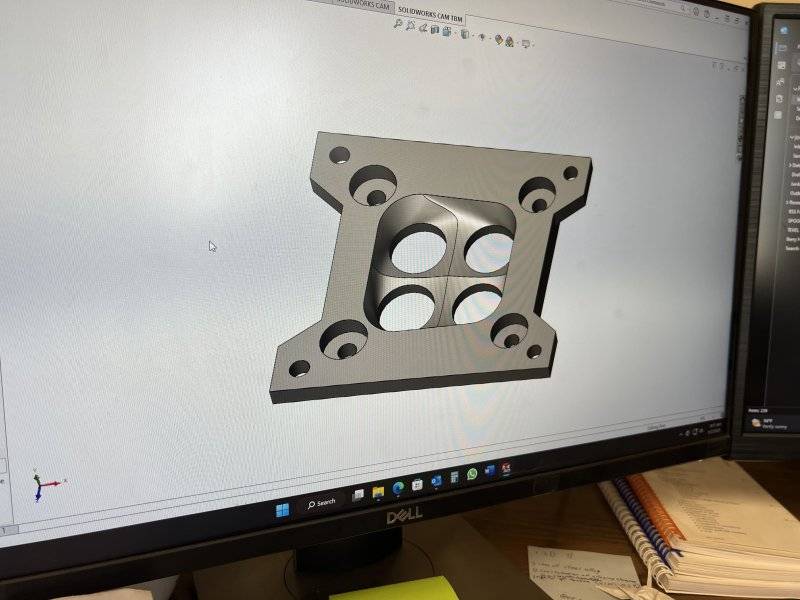

He 3D printed a carb spacer to ensure fit and finish.
We're going to CNC one out of aluminum for the final product.

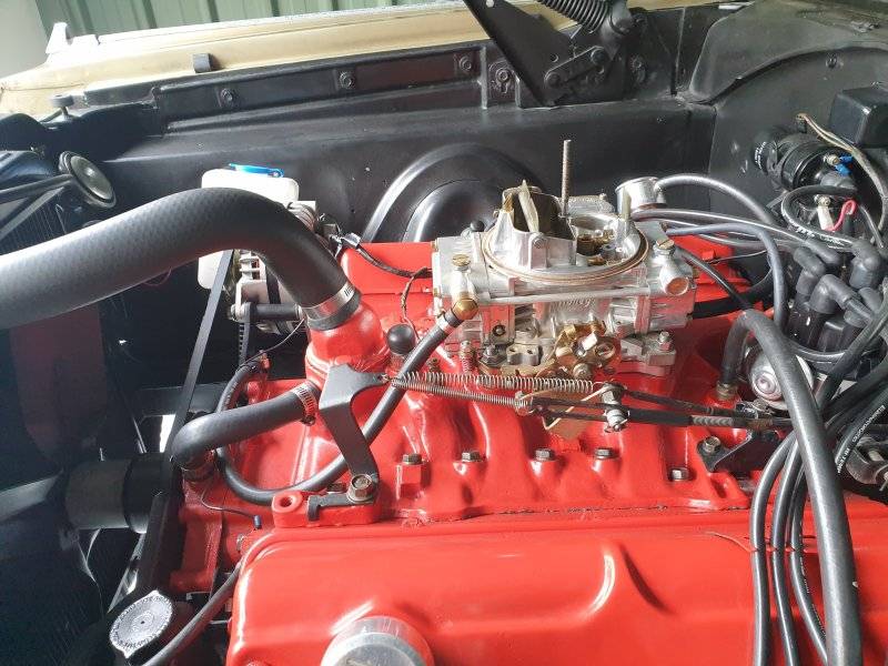

Hey, Evan....I tried pming you...but it's full. Just curious if I could talk you out of some pictures of your throttle bracket on your four-barrel intake?

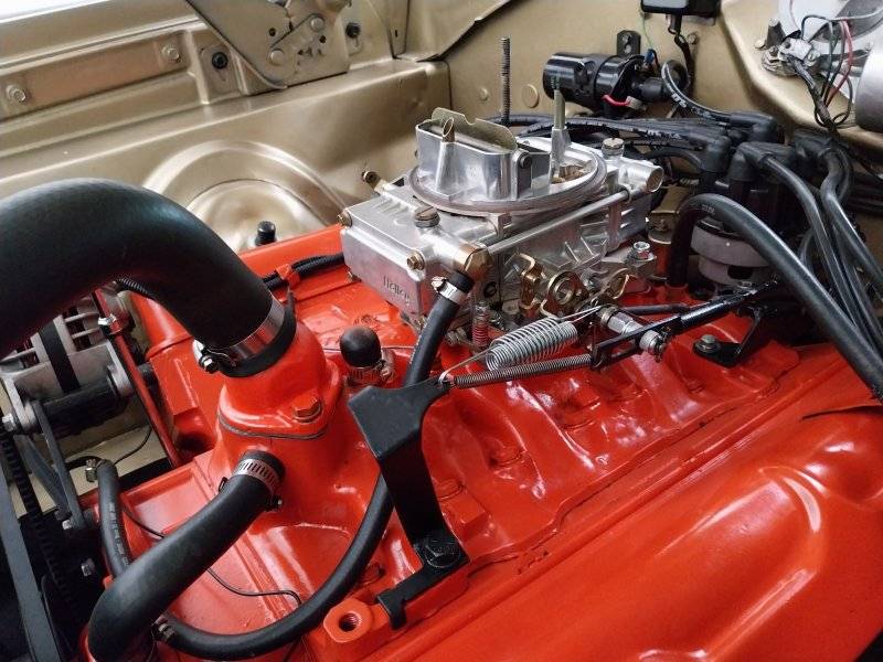

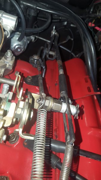

I put a 4bbl on a 65 318 pickup. Here are a couple pictures of the linkage. The throttle spring bracket is from a LA318, just cut a leg off it. The throttle spring came from a can of parts I have, no idea where I got it. It was originally a 4 speed so the trans linkage is a combination from eBay and some parts I already had. I had to do a little welding to make some pieces work but it is dialed in very well now. Kick down and secondary's come in exactly as they should.
A few photos of a similar set-up. First photo has throttle open. Last photo shows dual return springs for safety.
NICE setup you have.

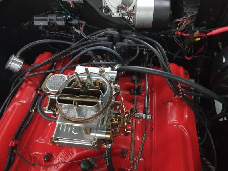

I was able to reuse the 2bbl cable and kick down linkage when I swapped to a 4bbl.
Little tweak here,some bending there,trial and error,works !
