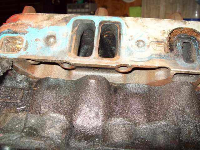

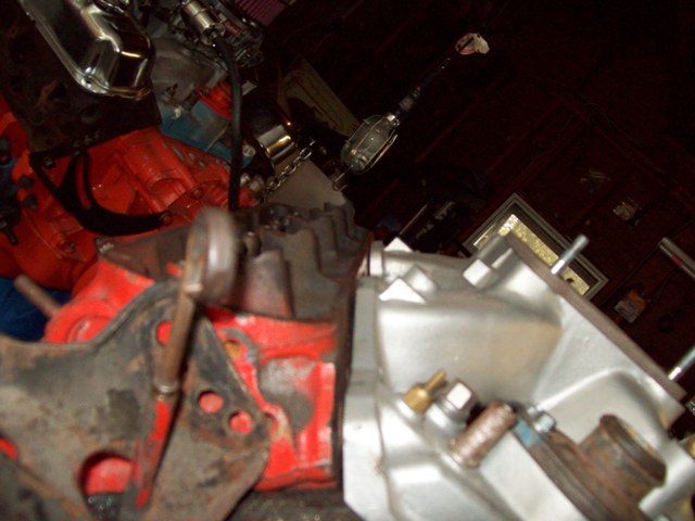

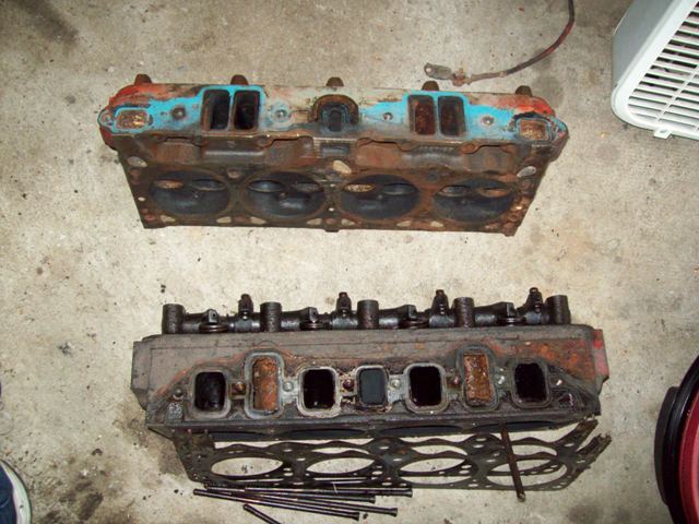

Here are a few photo's of "LA" heads on a Poly block with a "LA" Holley Strip Dominator on top just to show that it fits.
First shot is a "LA" head and the problem area of the Poly block. Between the two intake ports is the water passage I mentioned. It is huge and would take a "REAL WELDER" to do the job right.
Next is the Strip Dom and the LA head on the poly block. It fits, wont work.
Third is a comparo of the "LA" head on the Poly. Think about what your looking at. Where exactly is everything located?

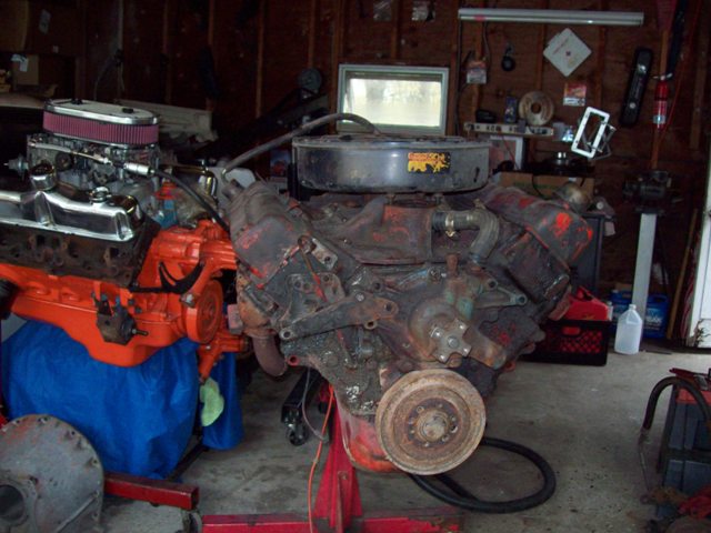

$th shot are just the engines on hand to fiddle with.
