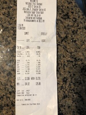

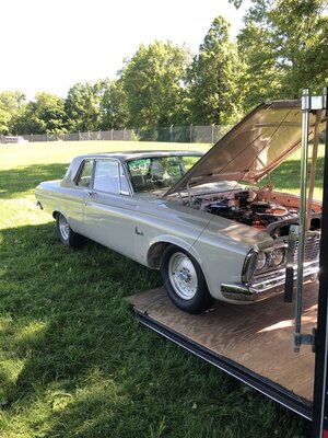

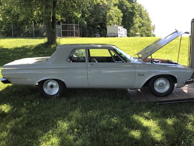

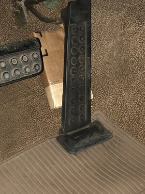

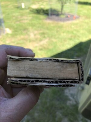

Raced the "Tan car" at National Trail Raceway 2 weeks ago. Had a fuel pressure problem and came up with a shitbox engineering solution and was pleased with the outcome. This is a stock Max Wedge engine that's been in the car since 1991 along with the trans and converter (10" Coan), 2" Hooker headers, 4.56 gears and 9" M/T radial slicks. Ended up with a 12.33 at only 105 mph due to the restricted fuel pressure. I'm thinking the fuel pump has seen better days since it's been in there since 91 also. The car has been sitting for many years. Came up with a hillbilly throttle stop that seemed to help me get through the weekend.
Wow that's really keeping up with social distances you parked way out there.. Lol
