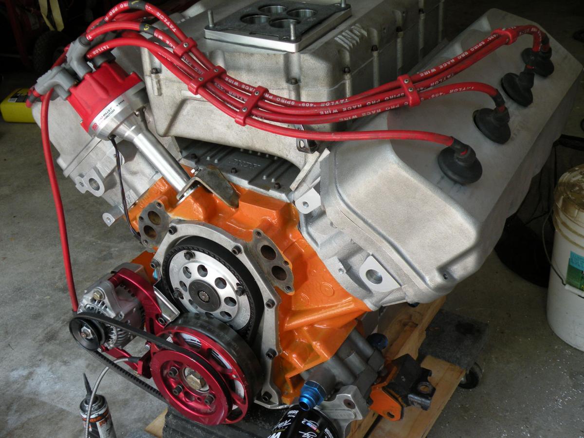

Drove it two hours to the track with a mild 572 pump gas hemi, built 727, dana 60, 373 gears, 4250# race weight with lots of ballast in the trunk and a 300 shot. Went 9.98@140 in the heat. I've taken out nearly 250# since and just got the new heads back from being CNC ported. Looking for low nines next year and with the new overdrive, should make the road trips much nicer.

Good luck on your low 9's pursuit, a little {or allot} of weight shedding couldn't hurt, that for damn sure....

Thanks, we'll get there. The additional port volume on the new heads alone will make a big difference. The old combo was a low buck deal using junk MP pistons (heavy, single pin oilers, big rings, etc. ), chunky Manley H-beams, etc. This new combo will using top shelf items. Lightweight diamond pistons with .043/.043/3mm rings, 7.100 Oliver rods, and the K-1 crank if it can be saved and a Callies if it can't. We're looking for another 100hp on motor and a bigger gain from the 300 shot with the additional volume.

Sounds like it will be a fun ride for sure... Looks like a top notch build... An additional total 400hp will always help, if you can get it to the ground especially... Any photos of this beast {car & combo}...
