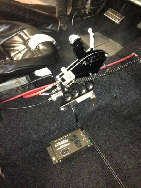

Put a new performance shifter in.

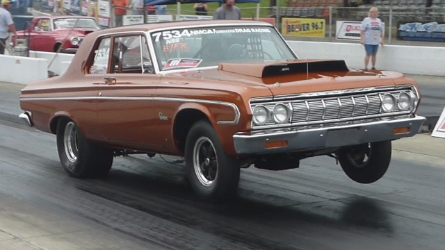

And a new high flying picture.

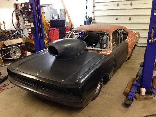

Sneak peek at new 7.50 cert car.

Womanator very cool pass, I'd tame it down some thou, get it to move forward instead of up...LOL... probably run better, less wear & tear too, looks like it comes down pretty good, not too violently thou... I'm sure you know that already... The CROWD loves it I'm sure..... Hey, What's the deal about the 7.50 cert. Duster ? is that your car or you building for someone else ?, you should start a thread about it too, hell any of your cars I'd like to see them... Charger Dart Duster whatever...

This is kinda like the 3 bears story.
First pass of the year after some mods I had a 3000 rpm launch chip in and bogged off the line and the car ran terrible.
next pass the one in the video,3900 launch chip on the bumper for 250 ft.
next pass 3600 rpm chip,car lifted 18 inch's in the air.
That pass we dialed a 9.61 and the car ran a 9.610 on the stop.
1.21 60 ft time.
Been pulling the front tire's all last yea,this is the first good 60 ft we have to go on with the front tires.
We were using the 60 ft using the rear tire time.
When the Dart with a Duster front clip and tail panel is done the Womanator will be for sale.
Hoping for 8's out of the box.
Maybe late July-early August.
Car is being built one tube at a time off a NHRA book.
Car actually runs and is being taken apart for paint.

Very cool keep us posted, she looks like she'll run

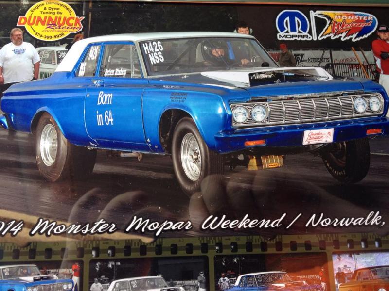

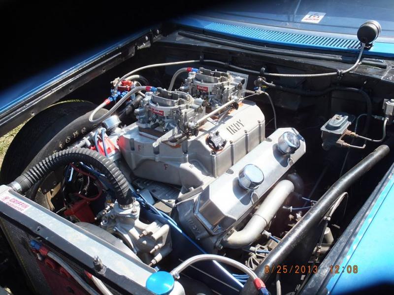

64 Plymouth 9.88
440 +.06 4.15 stroke Indy 440-1uUltra-dyne .660 roller Indy 440-25 Bathtub intake with Dual Elderbrock 800 CFM 9.88 @ 138 in Norwalk
Motor

bishop nice & congrats
Motor
Congrats, Norwalk was a blast, nice meeting you.
