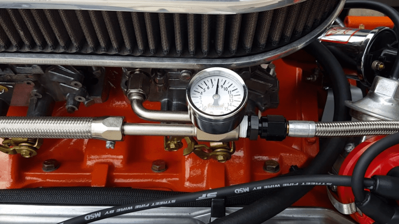

Are those fuel lines and single feed enough to feed the hungry animal? Been many moons since I had a Maxie!

Lots of folks asked me that question Al. I think it is as I have 6 psi all the way through the finish line. A buddy said pressure doesn't equal volume. I plan to replace the filter with a high-flow job. I also need to replace some of the fittings with high-flow units, rather than the plumbing fittings I used from the hardware store. More to come. At least it's driveable and raceable!
One line feeds plenty. Way more area in the line than the 2 needle/seat assy's. Take a look at S/S AH carbs. Though they're Holley's they are single inlet
