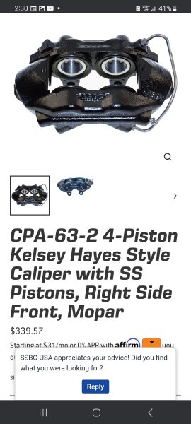

The issue is it's not parallel - the rotor is centered in the caliper at the bottom (other end) but is offset and rubs at the top
Is it this one?
looks similar but no. Bleeder is at other end - and outside. You have to bleed with wheels off - weird huh?
If you look a little closer, the bleeder is on the outside. Not weird because how else would you bleed the outside pistons. They are at the end of the fluid circuit. Bleeder position depends on which side its for.

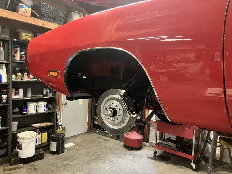

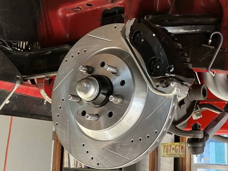

I want to thank everyone for all the input. To better align with the rotor I used a 1/4' spacer on top (5/16 was original). Before I could bleed the system the replacement caliper showed up and fit sightly better. I bled the system and test drove. It worked as it should but I'm struggling with the manual proportioning valve. I have it fully restricted and can still lock up the rear brakes doing a power stop (from 50 MPH) on pavement - Anyone have any ideas about that? Otherwise operation seems gd. I will never do business again with SSBC-USA, poor quality and worse service - there are better options. I'd rather hear bad news than be lied to.
