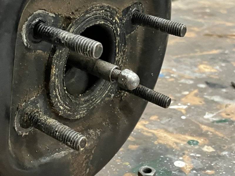

I got that tooll to adjust the power booster rod and put it back together and the brakes work great feel a Hugh difference with the power assist
so the booster rod adjustment was the only thing wrong? That's good news!
How's the pedal feel? Any spongyness at all?
I have been through that as well.
That threaded nub is about 3/4" long. I've seen them threaded all the way in most of the time but a few times I've seen them with about 1/4" of the threaded shank exposed.
They can be adjusted to reduce the free play in the pedal but it can be tricky. If you adjust it to eliminate all of the slack, it may actually result on some preload. I made this mistake and it ended up putting my front brakes in a bind when the pads heated up. I had to pull the master cylinder and back that nub back in a little.
