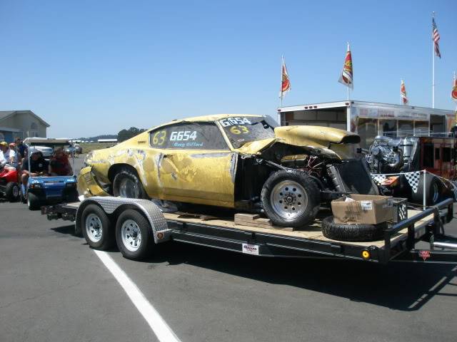

This picture the car ran over his own oil.

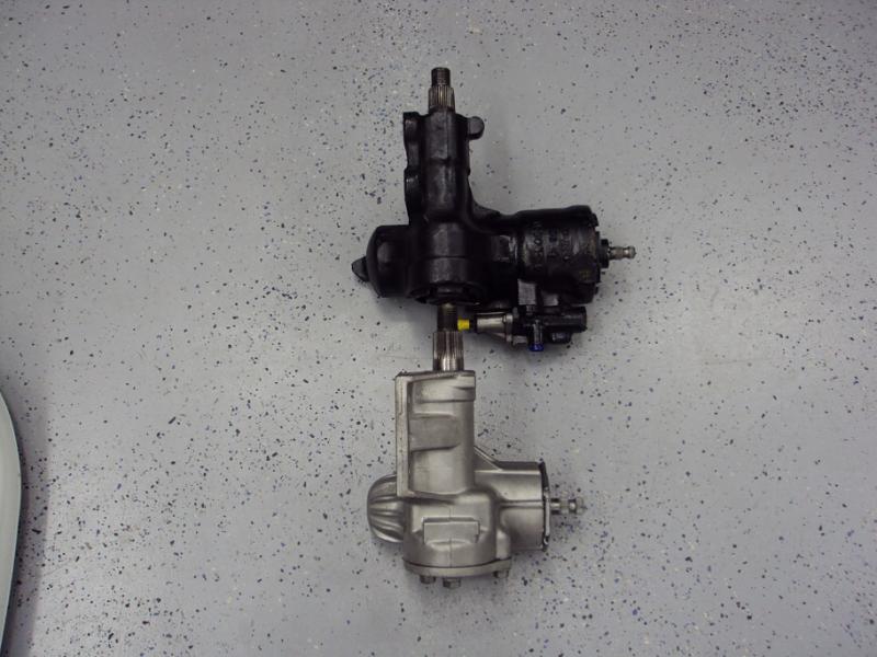

There is no such thing as a "firm feel" manual box. That nomenclature applied to P/S boxes only. If you are going from a power box to a manual box, you will have to lengthen the steering shaft because the box is shorter. steering shaft length.jpg

There is no such thing as a "firm feel" manual box. That nomenclature applied to P/S boxes only. If you are going from a power box to a manual box, you will have to lengthen the steering shaft because the box is shorter. View attachment 211978
Box compare.View attachment 211979

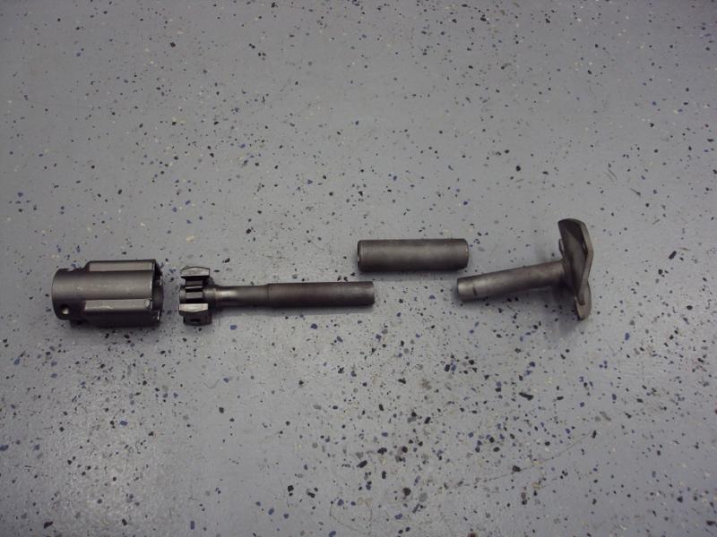

Yes the manual box is shorter and thats why I just bought this extenter from Mancini which I think is from Firm Feel ? As long as your steering coupler is ok as mine is in great shape then this just takes up the extra lenth needed on the shaft and worked fine for me. Ron
Flaming River also makes coupler adapters. I went to their site, did the research, then ordered through Jeg's. Mancini was out of stock on theirs. Flaming River was suggested to me by Stephen Daurity, son of former KOS racer Mike Daurity and it is what they use on their cars.

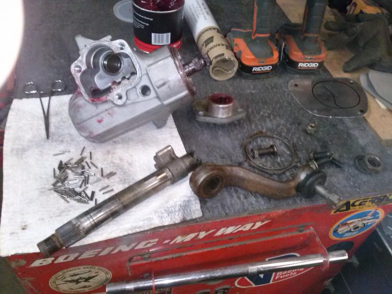

Swapped my bud for the manual box. I think I came out pretty good on that deal, since I see that Classic sells the power for $200 and the manual for $560. But it felt a little rough so I took it all apart and cleaned it for inspection. It all looked good inside, so I'm thinking maybe they may feel kinda rough when turning thru (by hand on the bench) even when they're good., or is that wishful thinking?
Anyway, putting all those needles back in should be fun!
