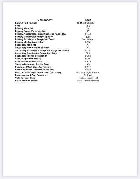

It’s def got a second PV. I was gonna order the Holley 750 from Summit but it was a week or so out so they suggested their Summit brand that is built by Holley but branded for them. It’s all Holley parts, only diff is instead of having the side bowls come off, the whole top of the carb comes off. Aside of that, everything is the same and how you tune it is the same. This was the spec card out of the box
