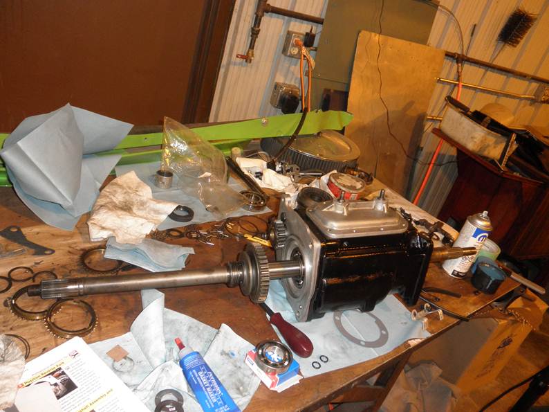

Here is that list of parts I needed for the auto to manual swap. Since your car already had a 4 speed, some of the parts my still be in the car. I decided to go with the 23 spline instead of the more expensive 18 spline (Hemi) trans. I am not drag racing or taking my car to the track. I also have a mild built 440. That trans is strong, so I should not have any problems. Others may not agree but that is ok. It all depends on what you are going to do with your car. You might still even have the Dana rear end. I believe all 4 speeds came with this unit. If it has a hex type cover with bolts on the back of it, it's still in the car.
the reason I stay with the BW T10 in my "63
