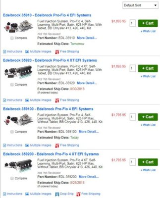

I saw an That they raised the price $100 since you first wrote about this. Also backordered? Maybe they underestimated the market and got flooded with orders???

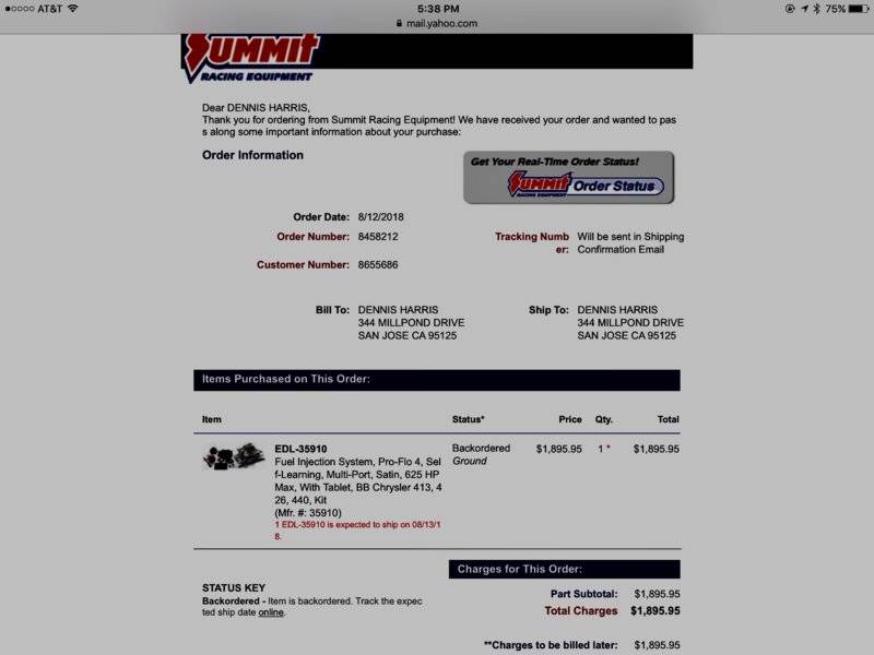

Should ship tomorrow. The back order line is confusing.
The 100 buckw is with or without tuning tablet.. Not needed if you have an android tablet sitting around.

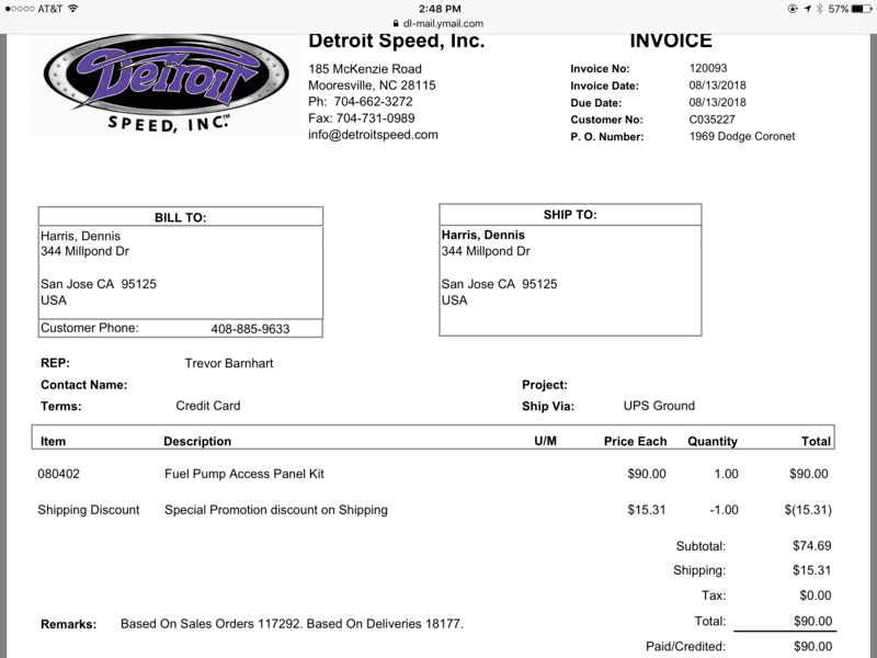

Detroit Speed, North Carolina for a trap door to acess the pump. Trevor. (704)662-3272. On the way. My wallet. OMG.

Pro Flo. 1895

Trap door 90

Did they just subtract the shipping then add it back in?
