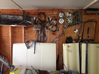

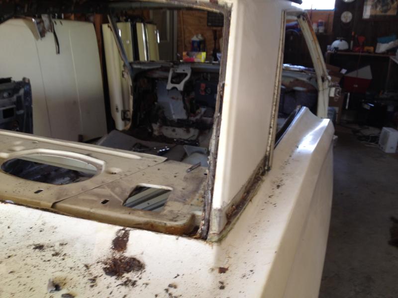

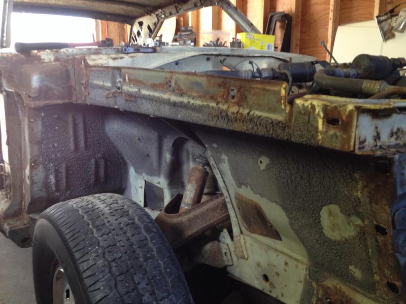

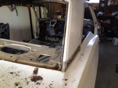

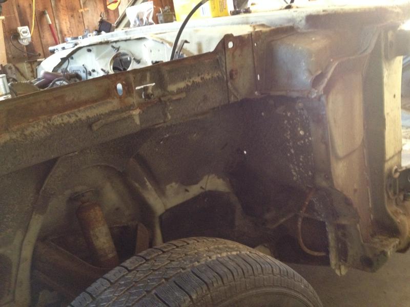

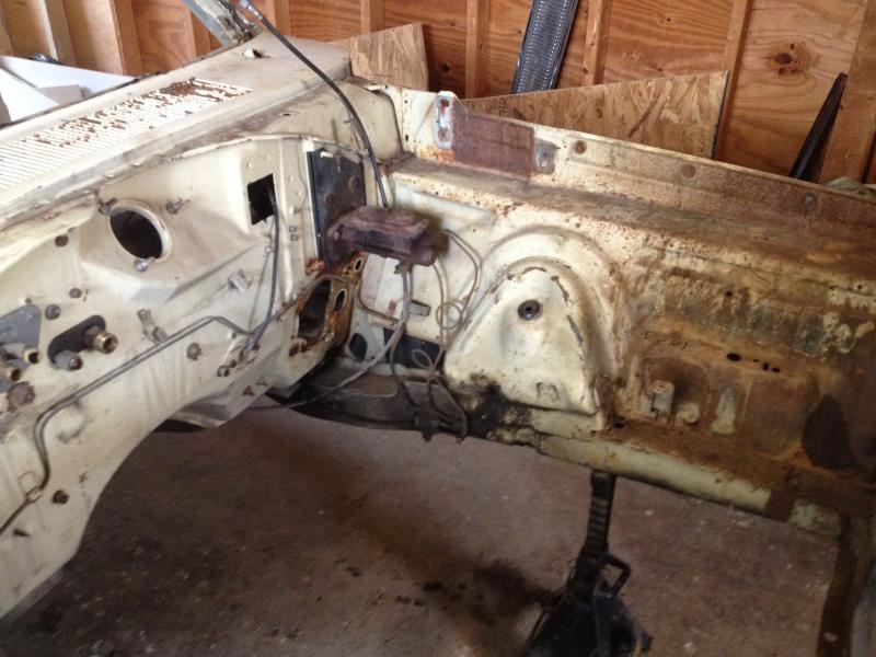

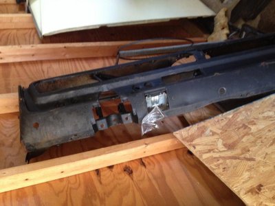

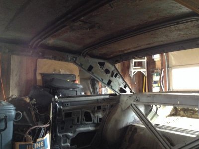

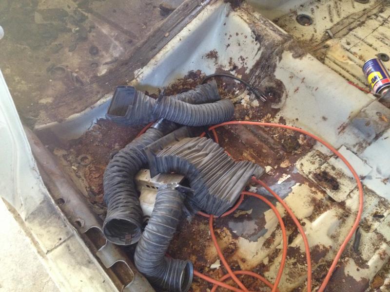

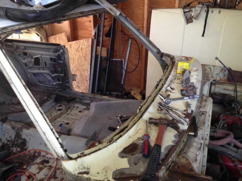

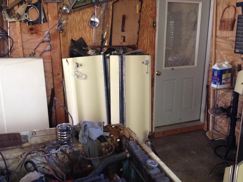

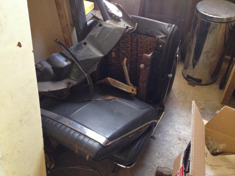

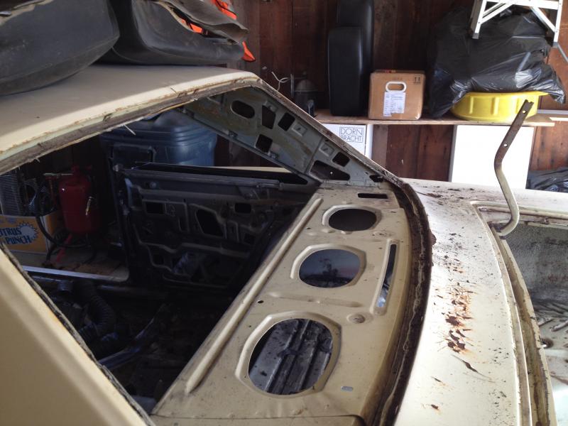

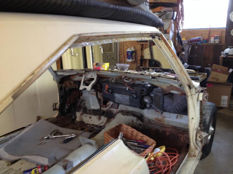

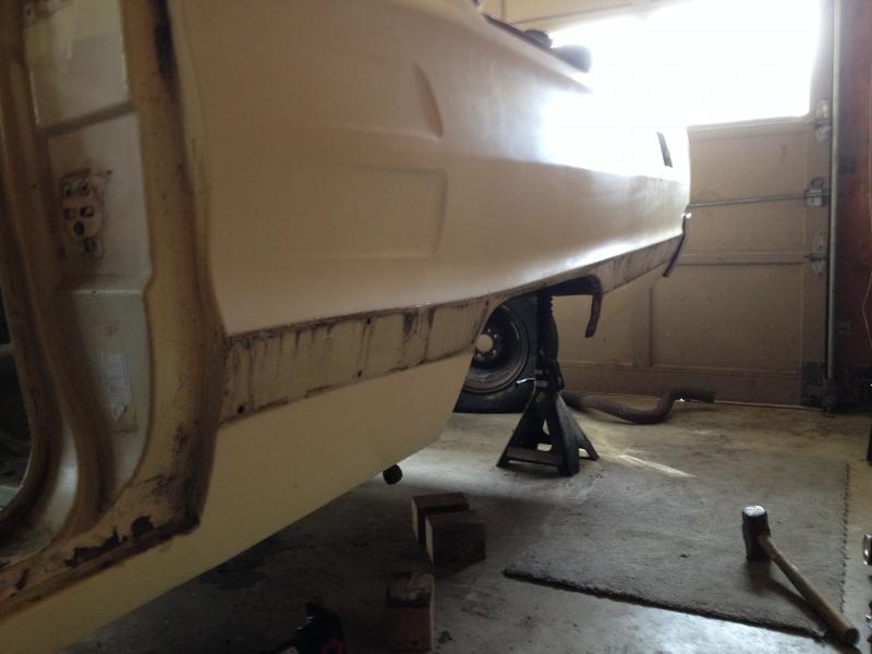

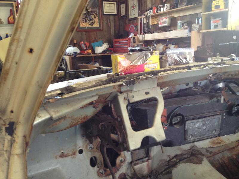

Got some more done...I think it was hit in the right front. draining fluids tomorrow and put it up on stands to start the rear axle/suspension removal. View attachment 220052View attachment 220053View attachment 220054View attachment 220055View attachment 220056View attachment 220057View attachment 220058View attachment 220059View attachment 220060View attachment 220061View attachment 220062View attachment 220063View attachment 220064View attachment 220065View attachment 220066Bump, I got the windshields out today. Just sliced the rubber along the outside edge of the glass and peeled it out of the channel and then peeled the inside rubber out to the inside and they popped right out. Got the wiring harnesses out all the under dash a/c and heat gear, ducts etc, the parking brake assy,the bumper mounts,and some of the firewall things. The wiper motor and arms are out. Jacking it up in the morning and draining everything and unhooking the A/C and heater lines. Coming along!

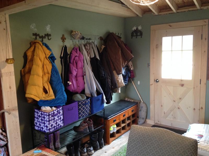

Okay, here's some more.....it's a nice day here. I included a few of my recent addition to the cabin, an enclosed entry/mudroom in between the cabin and the garages. Used to be just a small passthrough with sliding glass doors on both sides. Cold in the winter.

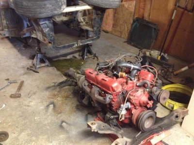

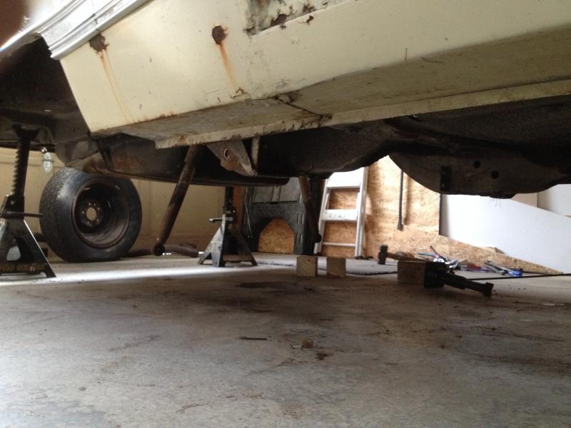

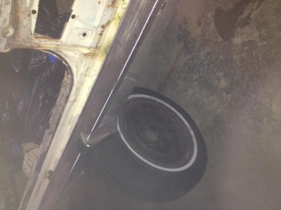

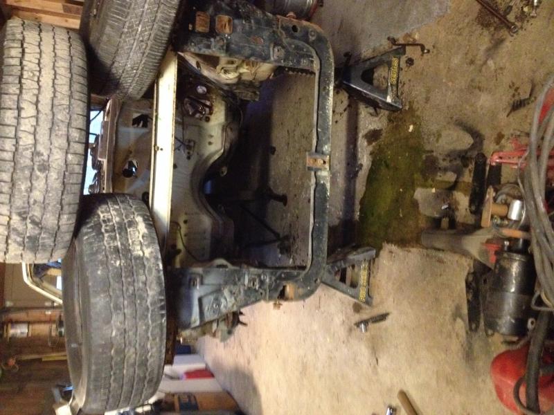

Today I was able to remove all of the major parts and panels down to my full basement. I also put the shell up on 6 ton jack stands and began the removal of the front suspension/ t bars. LCA's and wheels. Also I removed the trans/AC cooler, radiator, AC pump and hoses, fuel line from pump, alternator, fan, tranny mount bolts( two out two loose), and the tires. Now I can pull the heater box etc, from under the dash. Going to drop the 318 and K plate with trans all at once and slide out from under the front end. I placed the stands just in front of the LCA on frame box and just forward of the rear leaf mounts on the frame box. Is this correct?
Thanks everyone.
Biz.
PROGRESS REPORT.

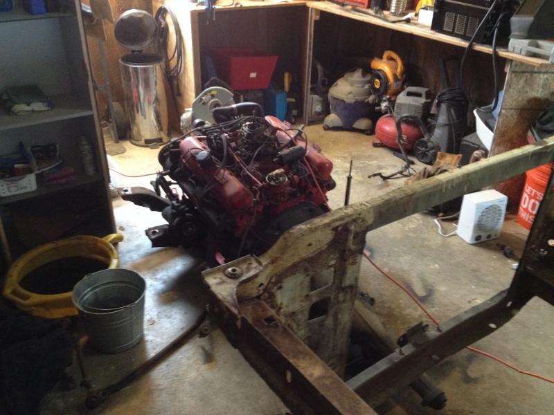

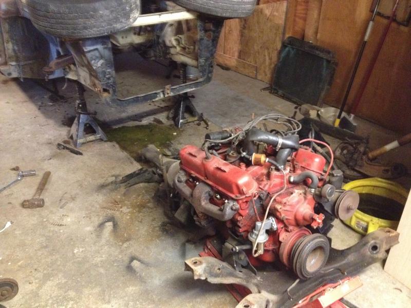

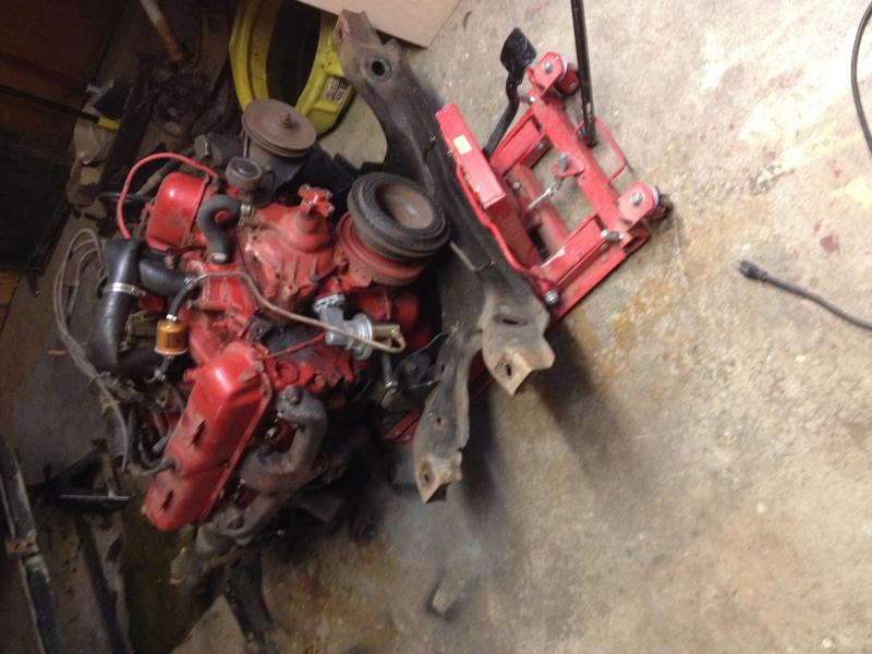

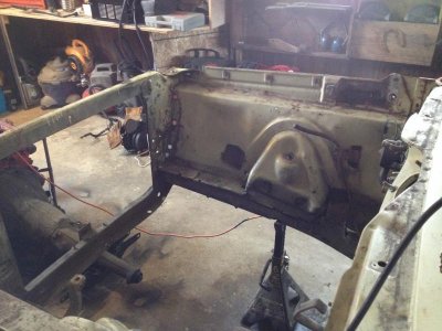

I pulled the K frame with the motor and trans attached, after I pulled the torsion bars and the LCA's.
I calculated where the tipping point was for the shell with rear axle attatched and hanging, and then placed the two jack stands there. So, when I let the engine and trans down slowly with my motorcycle lift the body shell tipped up and the rear end had a soft landing on two tires. This gave me ample room to slide the whole shebang out from under on the lift. I put one hand on the front radiator cross bar and pushed lightly down and it tipped back down to the jack stands on the front. I put three tires and the rims on the top to hold it down. I also placed a soft tire under the rear bumper to keep it fromtipping again. I then called it a day. here's the pics. I'll move the stands rearward in the morning to balance it out for pulling the rear axle.IMG_0801.jpgIMG_0802.jpgIMG_0794.jpgIMG_0803.jpgIMG_0800.jpg

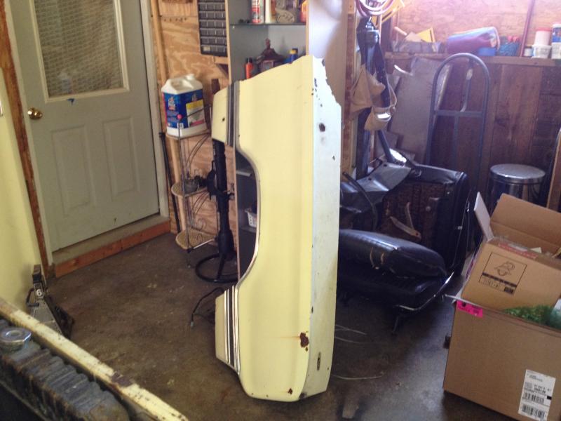

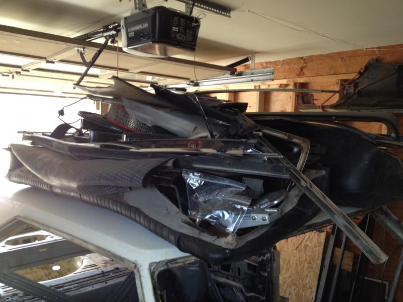

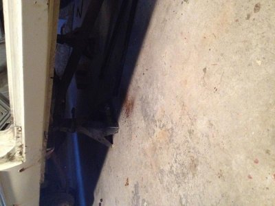

Ok guys and gals, I made some progress today on taking it apart. The rearend came out along with the leaf springs and driveshaft. Pulled the parking brake cables. Moved the jackstands further to the rear now that the axle is out of the way. Next is gas tank, rear shocks and then tip it up to get at the brake lines and trans lines. A little more side trim to remove and also the rear bumper. Then on to media blasting!! Yahhhhh!IMG_0835.jpgIMG_0834.jpgIMG_0833.jpgIMG_0837.jpgIMG_0838.jpgIMG_0839.jpg

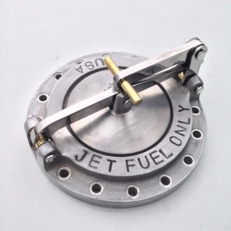

it appears that I have two resto threads going. Here's an update on project YANKEE EXPRESS. I got the fuel filler neck and housing out and cut a piece of the old trunk floor for a patch panel to shave off the outer fuel filler door. Got it tacked in place. I slid a 10 gallon fuel cell up under the package shelf in the trunk to see how big I can make the fuel cell I need after the tubs are done and the spare is in the trunk. Just sat looking and thinking. Weighing all of the options. I ordered this jet fuel filler cap to place in the front center of the trunk deck and thought out the placing of the filler neck/materials/measurements etc..
