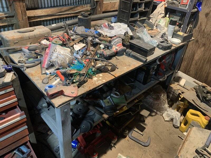

Here’s the shop tonight. Bosco in snooze patrol. It’s 1:07 here.

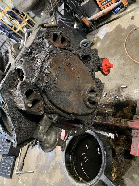

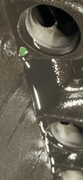

Some more anomalies… I’m reverse engineering this as alien writing for counter fact with fiction. Wierd light and shadow. Goodnight y’all.
7A041DE1-4E30-4114-B81A-770F50BC99D8.png AB5B8977-0BA0-4FAE-B9F5-3ECC26832C17.png
That’s pretty cool natural artwork that shows so many ideals. The natural world works wonders with gravity and molecular structure-one of the purest form of artwork is photography of earths gravity at work.

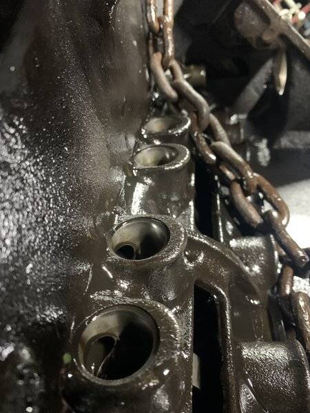

that their is more alien drawings I’ve found of a celestial visitation where they the white lines came from space to thr green planet of bora-bora. It’s a antifreeze droplet with light and oil cool artwork sight.

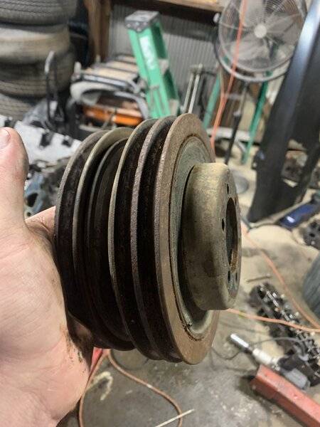

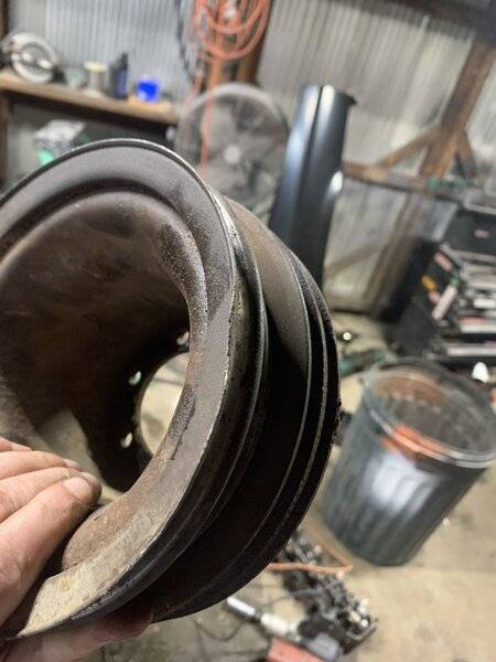

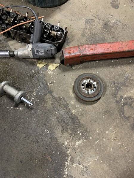

Air conditioning pulley to add to my collection. It dropped, It was really nice not much pits,man.
so far I got this off. I just started.

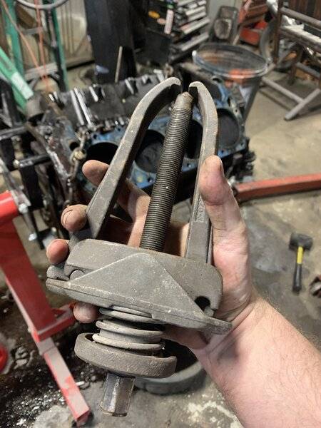

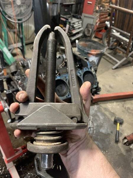

This ole puller is a piece of engineering marvel. It’s been there through thick in thin for me and dad over the years.
This reed I wouldn’t sell this for a 1000 dollars it’s so rare. Someone told me never to restore paint a old tool because it decreases in value. My dad has a old machine table with a late 1800s vice. I messed up and painted it long time ago when I restored the machine table.

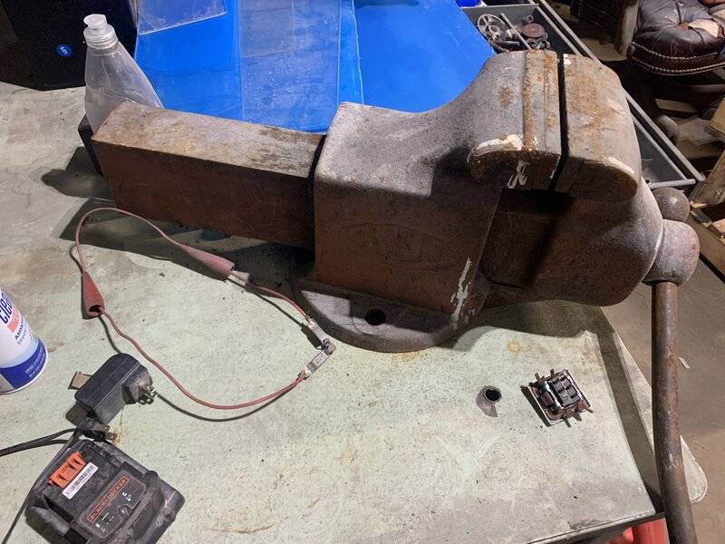

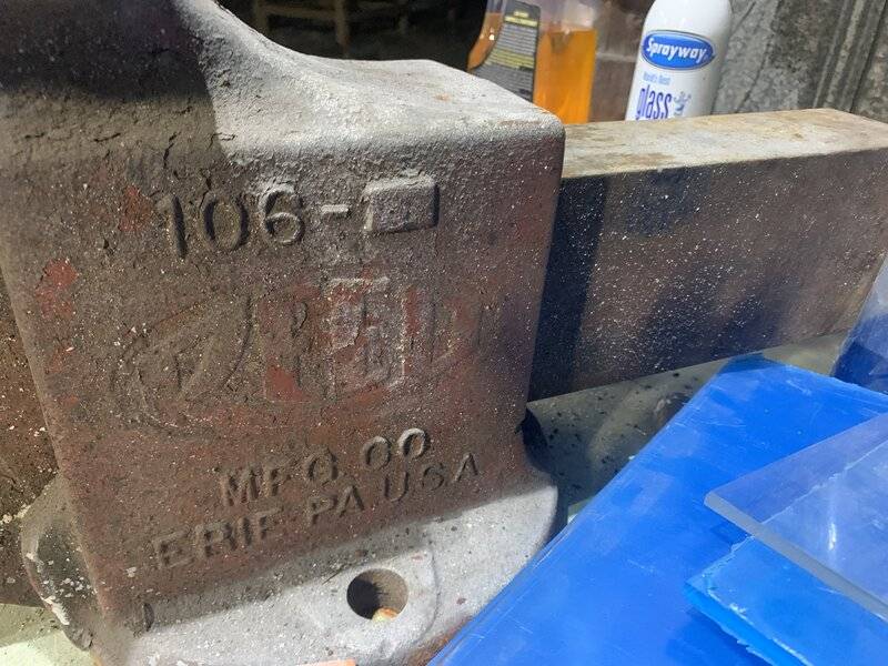

This is that 1800s vice that I restored years ago when I restored the machine table that was rusted out. We rarely use it.

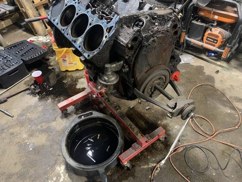

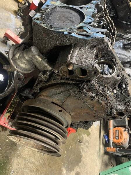

this new pulley set had been through so much with me and dad. I have to figure something out because dad asleep and i forgot it turns over so I’m probably going to break and drink a few and smoke and chill and might go to sleep.
8A112D26-8D79-43DF-9A61-D72437CCE84E.jpeg 486EB84E-1C52-4B66-9F99-0B96E452D309.jpeg D000824C-6D08-4E28-9955-194358339FF7.jpeg 7684CDF2-A369-4A64-903E-C304D425BE27.jpeg

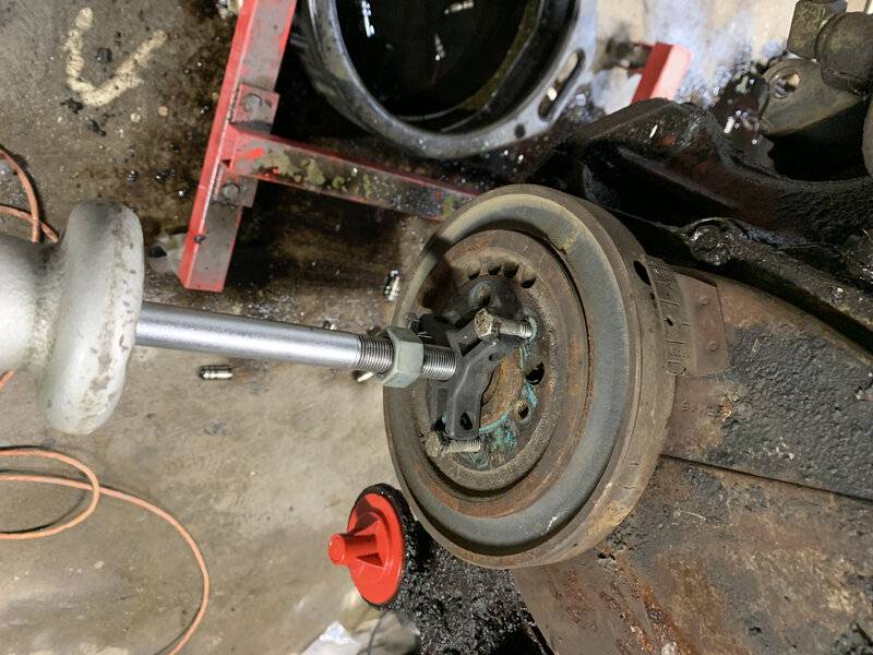

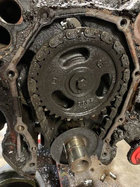

Figured out I can use the tri piece in the puller set like I did with the 383 I forgot about.
This is the easiest way to get one off when not stuck. And the 1967 threads are fine. I made sure not to mess up the threads.. it’s about 1/16 to 1/8 smaller than the crank bolt hole.
8FFEECD1-50C6-4A05-B669-4FB9CFB1D206.jpeg 18E08A72-BFCF-4C33-ACE9-884421054C73.jpeg 21B5E819-FBEB-4BE8-9E10-FDC1B5470EC8.jpeg
Looks good so far. Doesn’t have silent timing technology i forgot what year they got rid of that because the timing gear wouldn’t last 50000 miles.

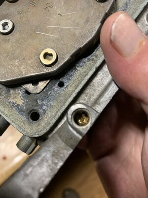

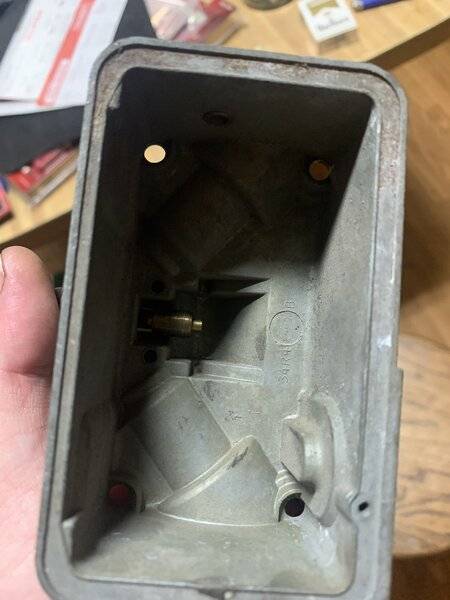

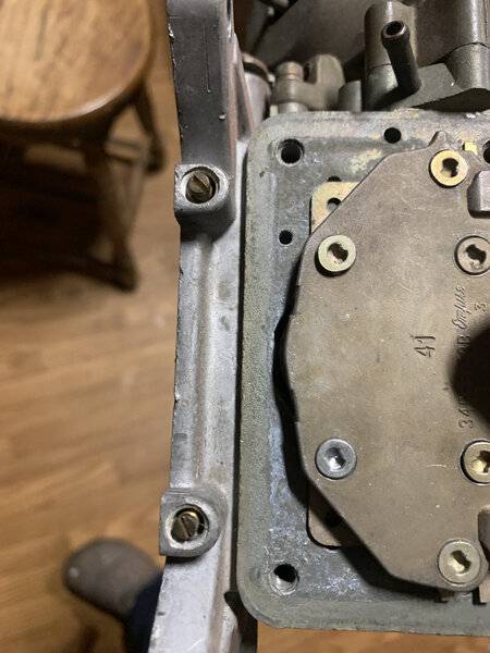

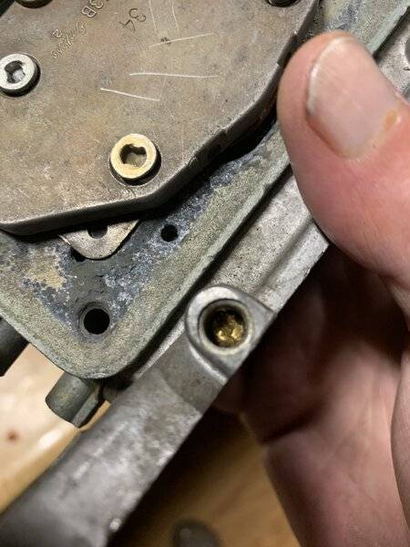

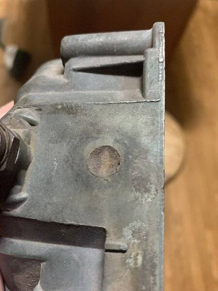

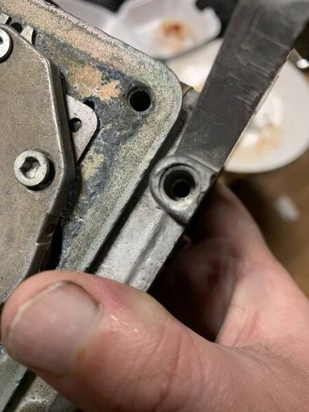

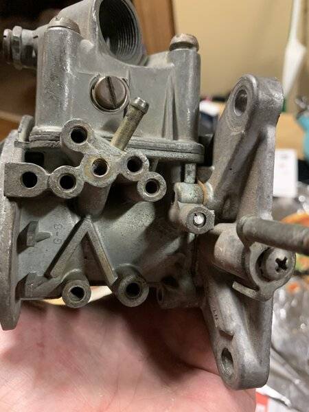

This is the when I understand I got a fair deal not a great deal. The bowl with the odd hole is really a pre 1970 center 350 cfm bowl. The idle mixture screw was corroded at one time and someone tried to drill it out it seems.
the base is ruined that’s a 150-200 dollars new.
the bowl is ruined that’s 150 dollars.
One bowl doesn’t have a float either.
And another problem is a broken off bolt.
I’m sending them off next week to the same guy to trade or to restore.

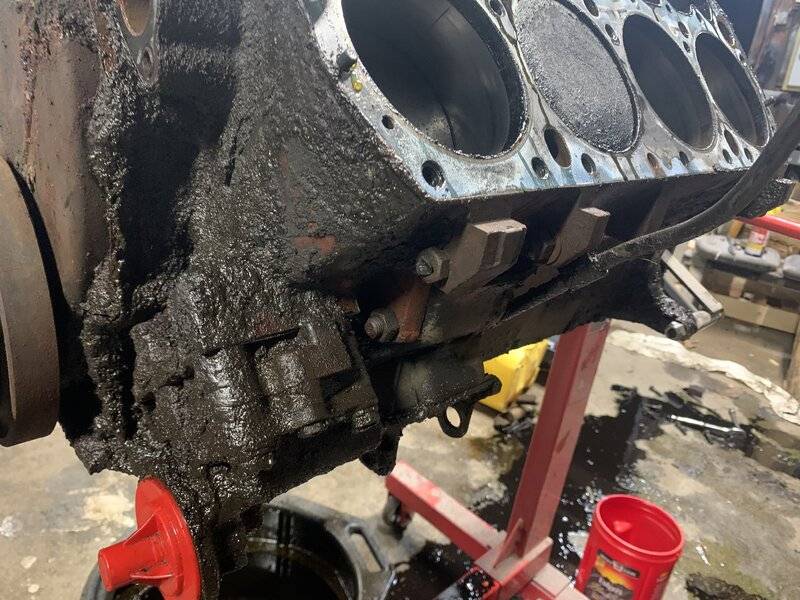

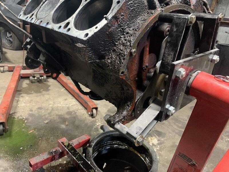

I have a 1971 block that I want to match this with. havent taken a picture but the 1971 440 has been gone through-it has 10 over rod bearings-meaning the crank has been turned.
this is most likely a 40 over block. It does have the a code-it’s was .20 over from factory.

I’ll take pictures of the 0.10 bearing tonight. Dad doesn’t want me to take the crank and rods out just yet because someone didn’t number them appropriately when putting the rods back inside the engine and we aren’t ready to send the engine off to walnut Mississippi yet to have it restored.
8 is in the right place. 1 is. 3 it’s two 3s it seems 2 3 stamped rods I forgot but will take pictures.. whoever built this engine didn’t do that well of a job.
