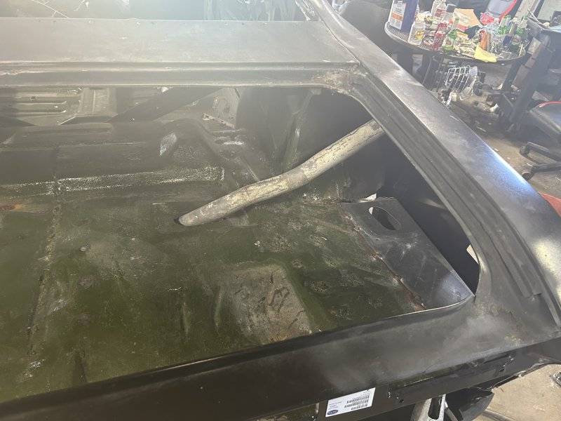

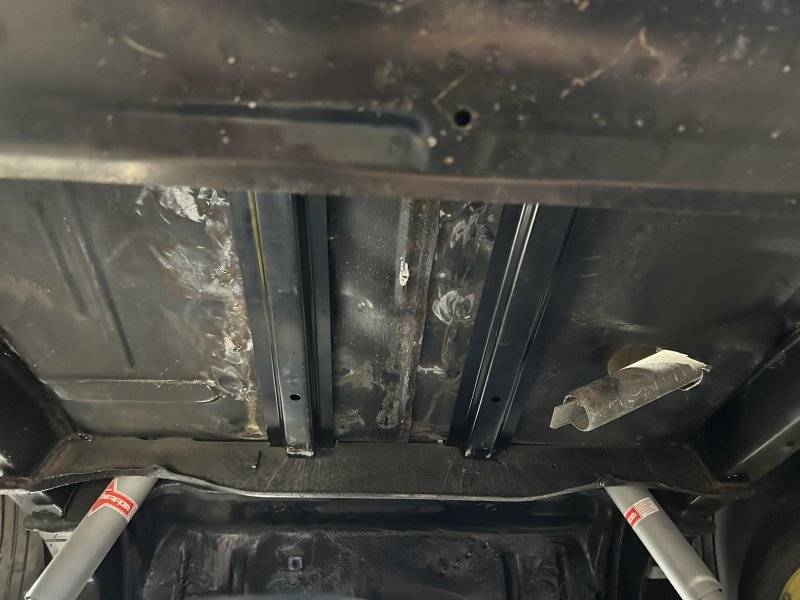

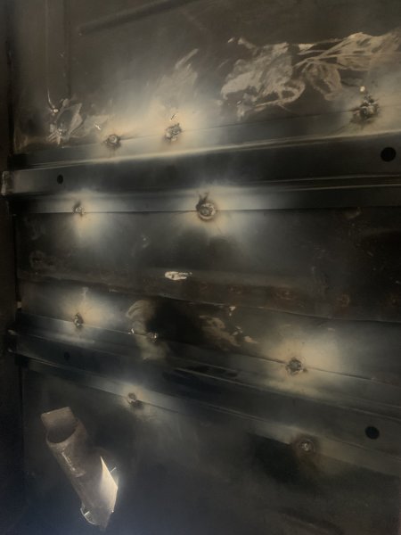

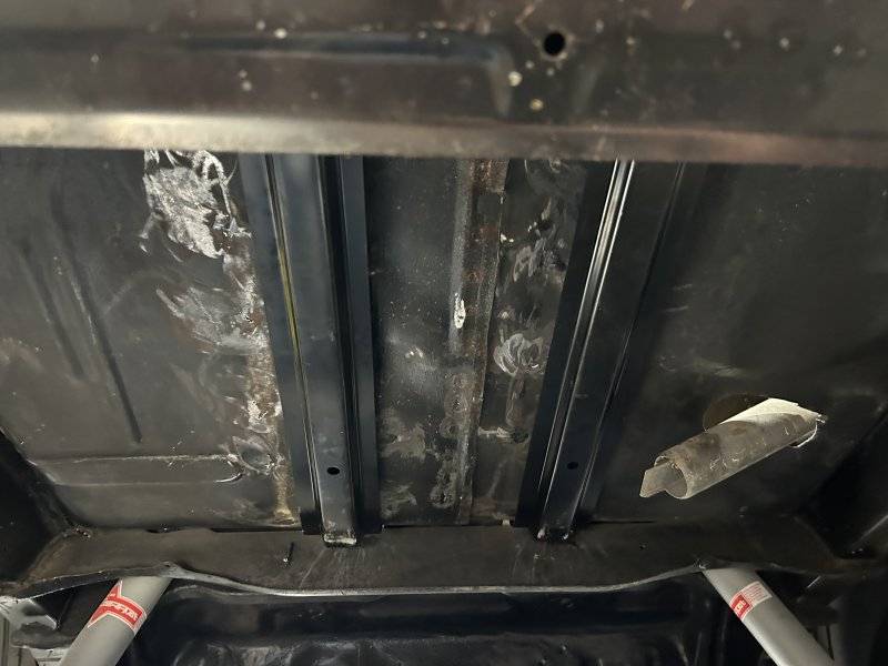

Got tacks holding the two gas tank support rails in and the right place-I had to measure the frame rails at one area, 41 inches apart from the inside diameter of the frame rails and I halved that,and measure 6 inches and 1/4 inbetween both rails..tank fits right inbetween the gas tank rail valleys and the filler hose lines up..
I’ve got the J bolts,and tank straps..

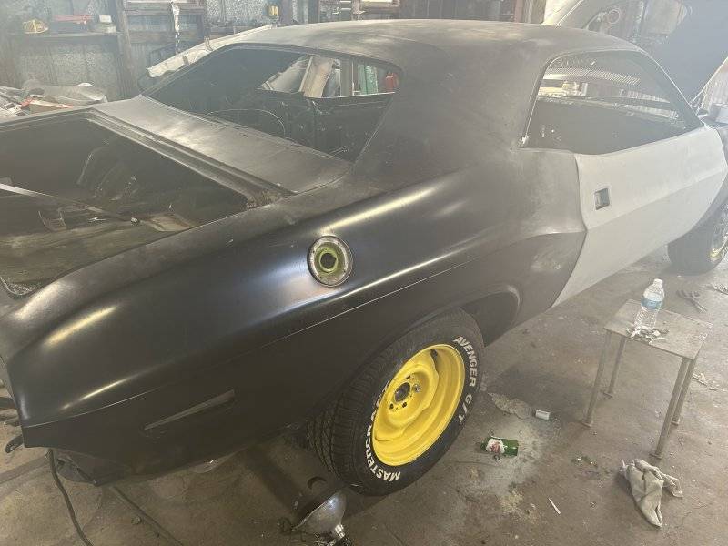

Man, had a bunch of Challengers since 1980 and forgot all about that gas tank fill being on the passenger side. Never ever liked that and don't understand why the factory decided to put it like that....

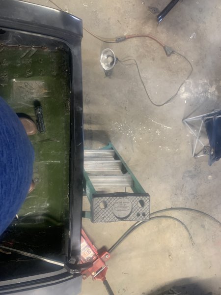

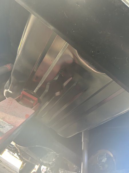

Me standing in the trunk of the challenger. And the tack welds flush to the trunk pan..

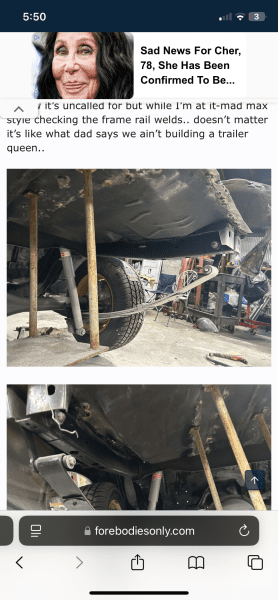

Update.. from forebodies.. tires off the ground and the frame rails not swaying inwards-a possible sign the frame rails are secure.. Iam 340 pounds..
