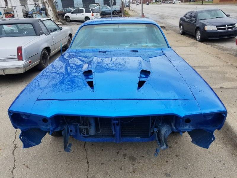

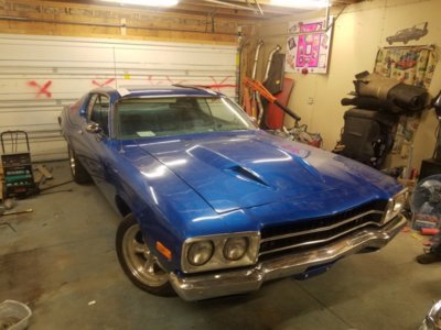

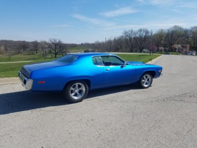

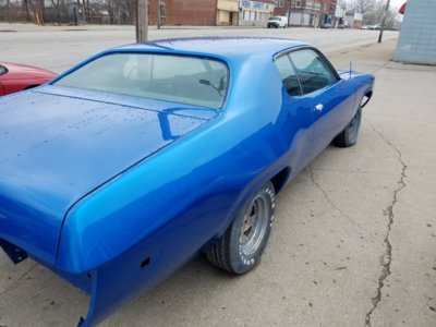

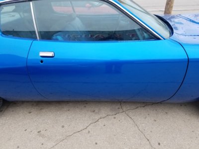

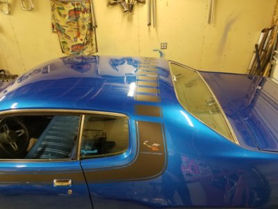

project daily driver

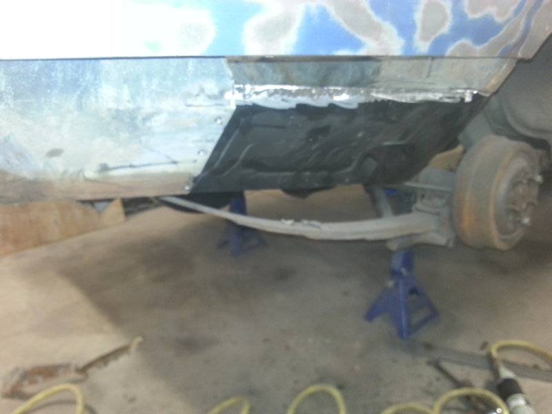

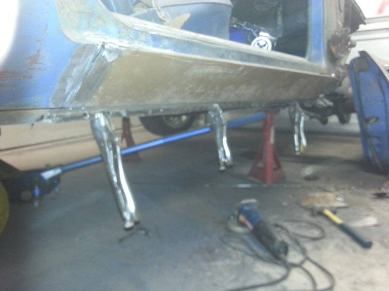

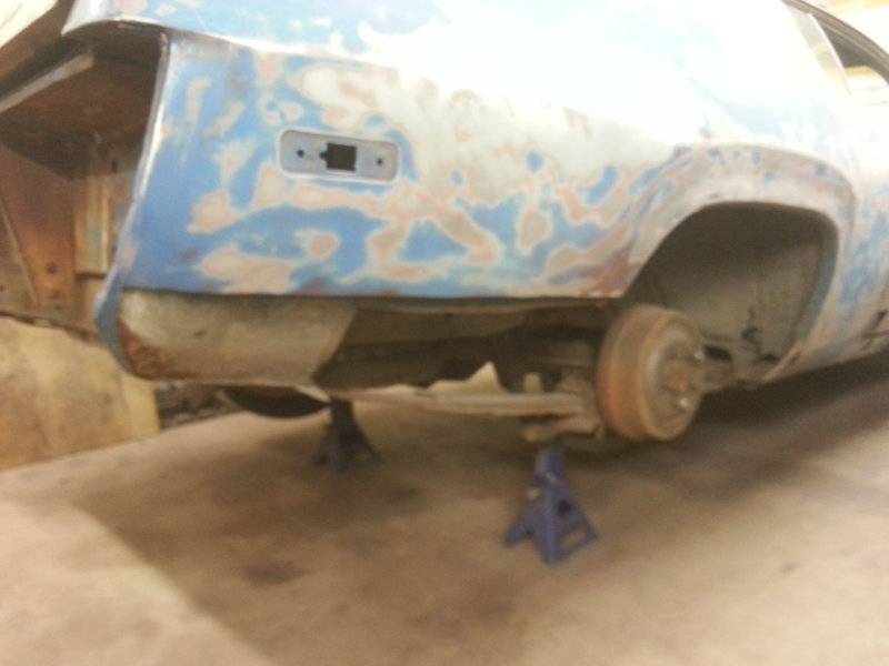

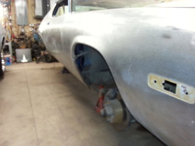

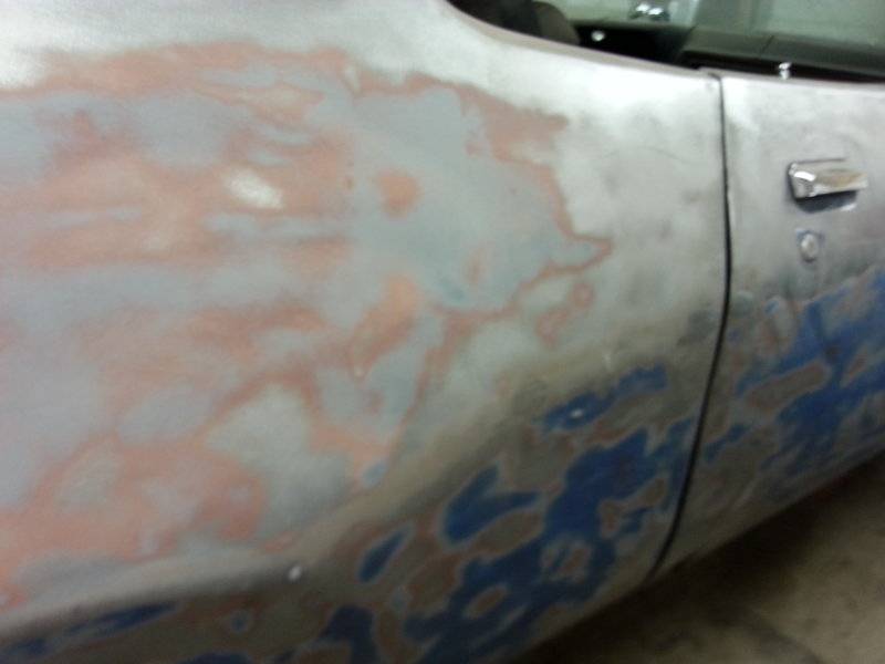

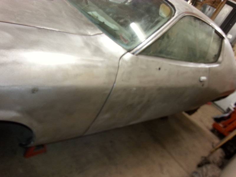

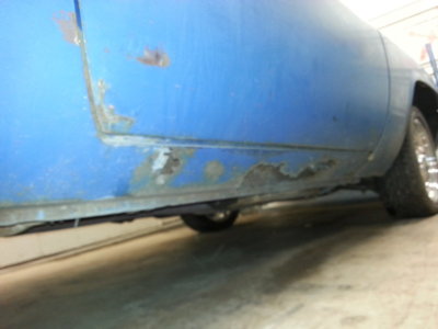

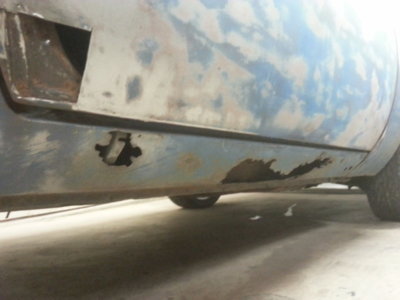

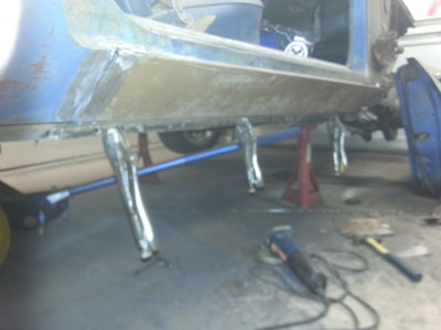

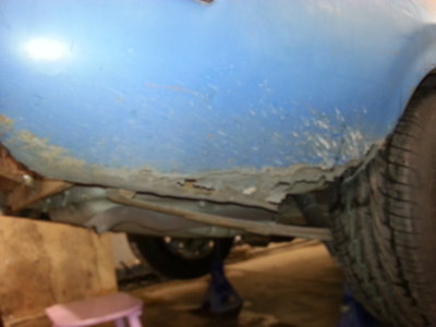

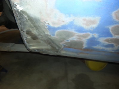

onto passenger side
20160327_220104.jpg 20160327_220118.jpg 20160327_220132.jpg 20160327_220145.jpg 20160327_220201.jpg 20160331_205252.jpg

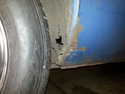

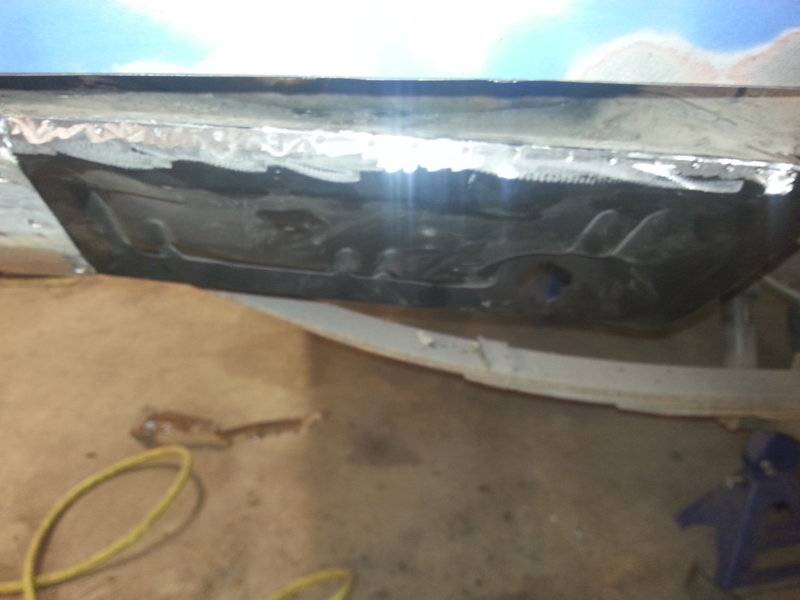

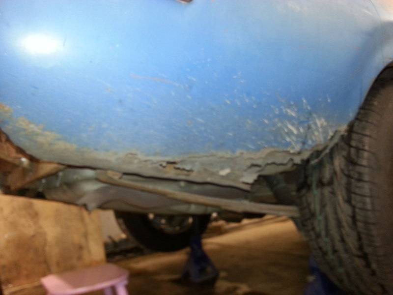

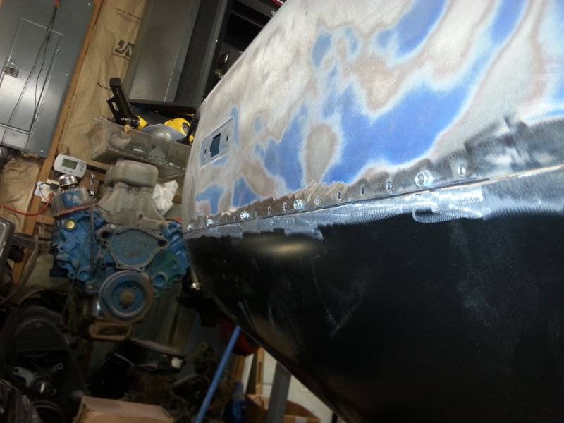

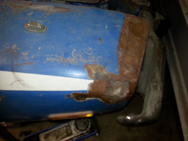

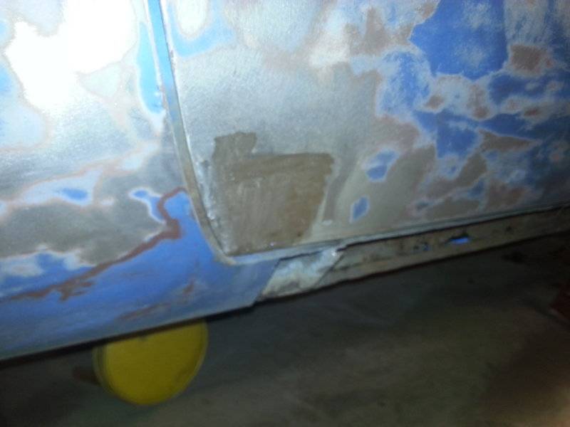

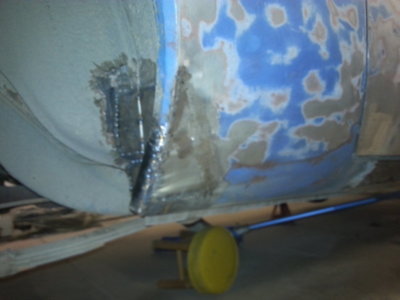

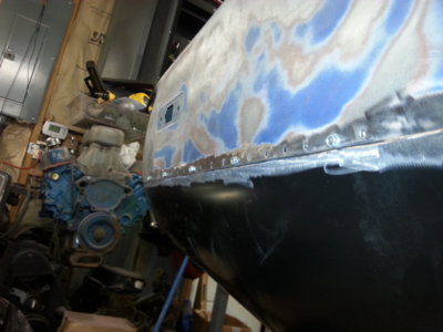

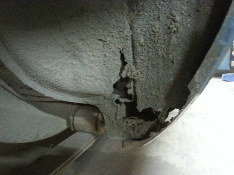

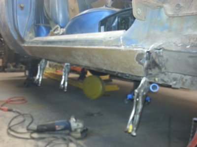

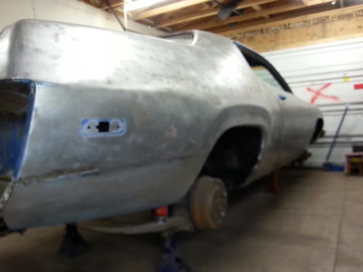

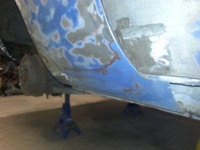

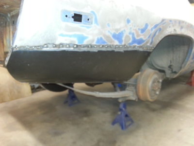

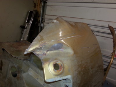

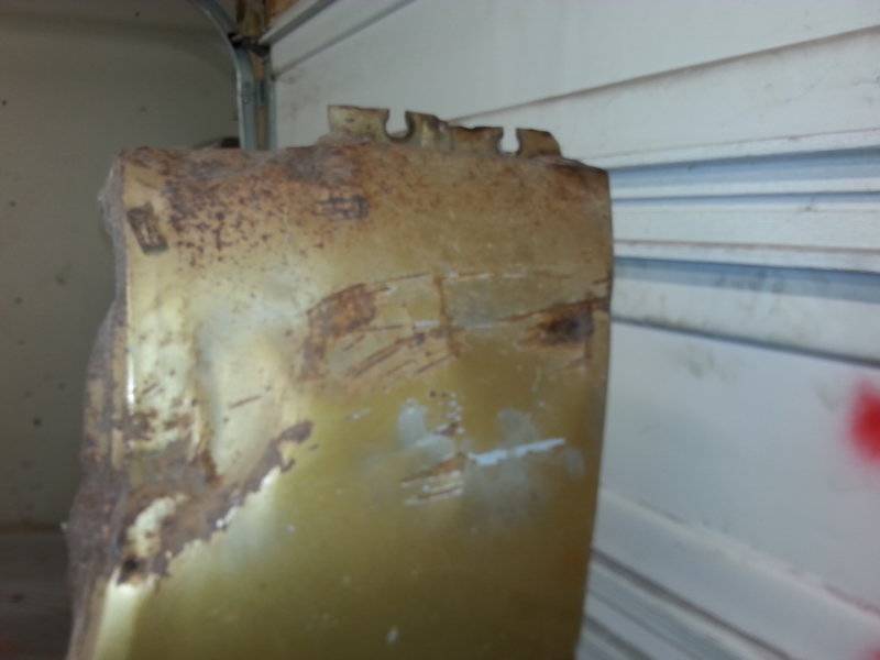

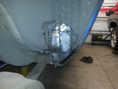

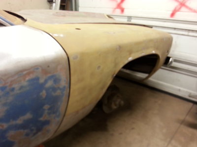

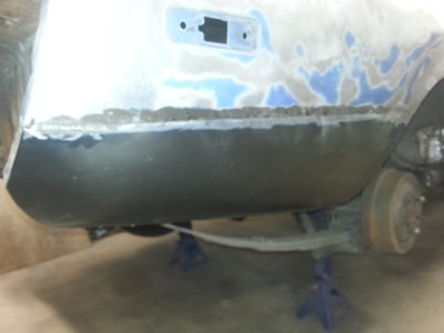

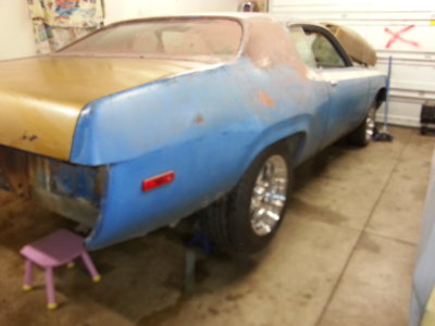

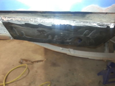

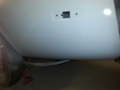

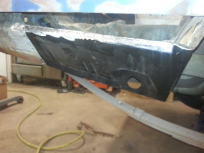

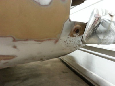

quarter went fast on this side not as much rust out
20160331_205231.jpg 20160331_205313.jpg 20160403_210322.jpg 20160403_210334.jpg 20160404_210025.jpg 20160404_210036.jpg 20160404_210051.jpg 20160404_210102.jpg 20160404_224146.jpg 20160404_224202.jpg

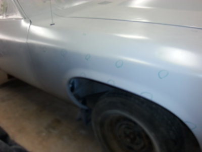

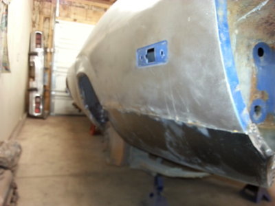

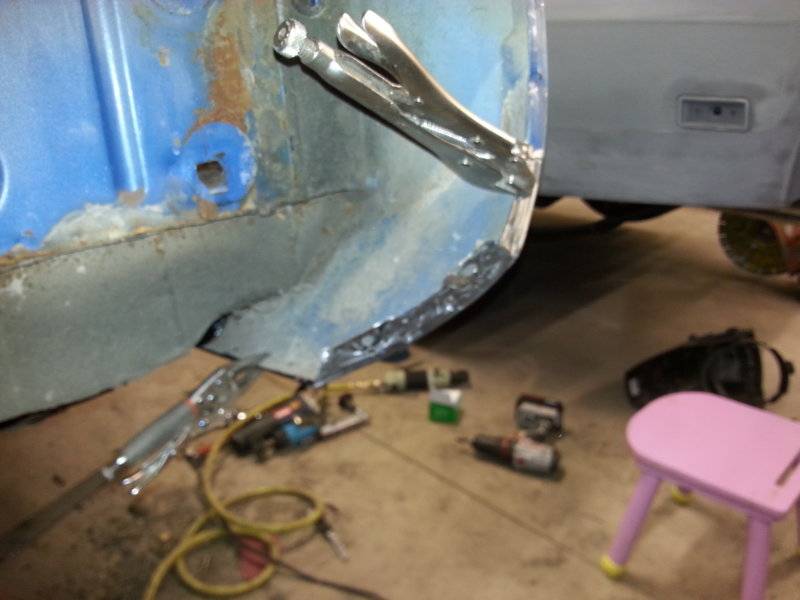

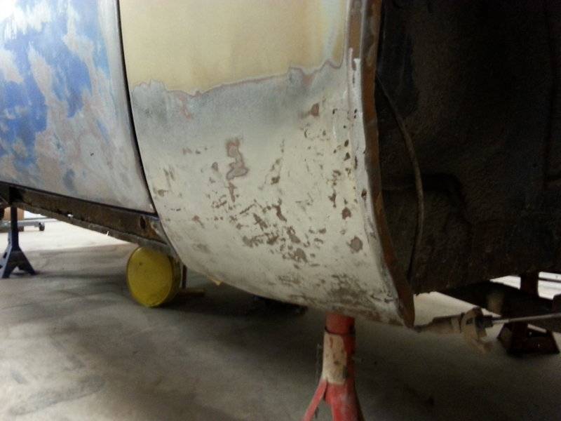

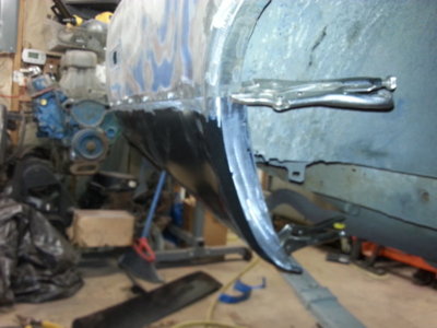

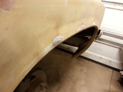

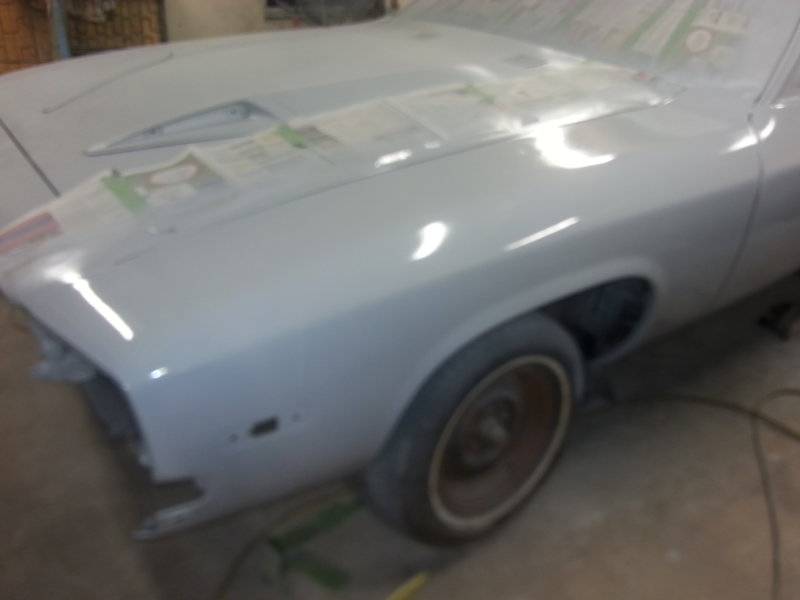

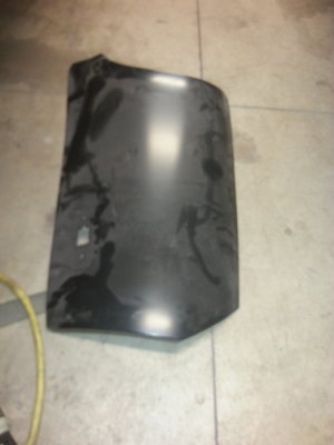

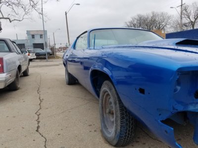

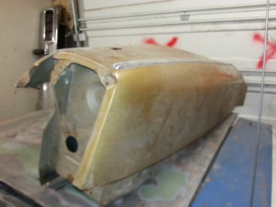

replacement pass fender was beat up but no rust out was able to hammer and Dollie
20160327_220214.jpg 20160327_220225.jpg 20160327_220313.jpg 20160327_220327.jpg 20160403_210418.jpg 20160403_210409.jpg 20160403_210346.jpg 20160403_210359.jpg

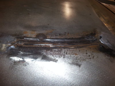

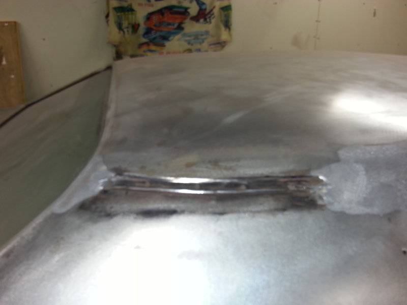

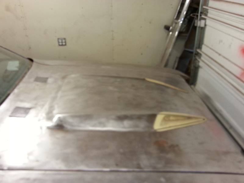

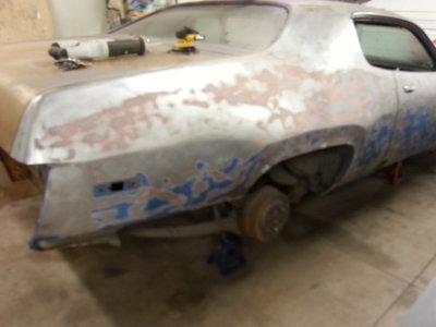

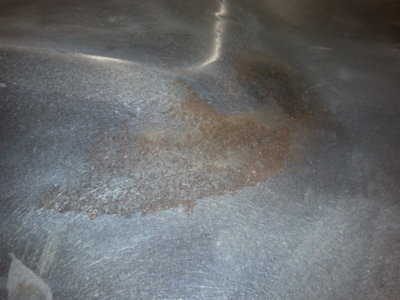

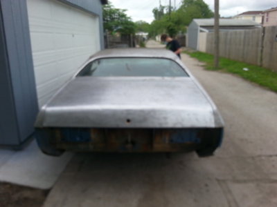

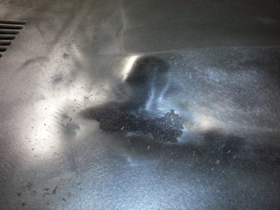

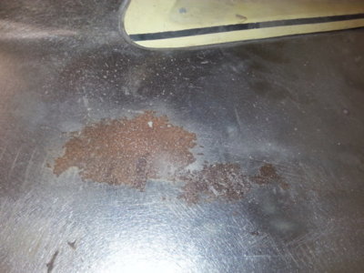

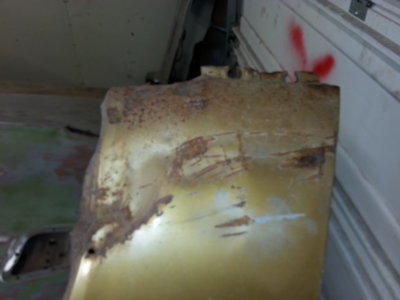

getting down to bare metal found a few spots that had deep surface rust
20160425_203554.jpg 20160425_203511.jpg 20160425_203618.jpg 20160425_203646.jpg 20160425_203716.jpg 20160425_203758.jpg 20160425_203840.jpg 20160425_203857.jpg 20160425_203909.jpg 20160425_203931.jpg

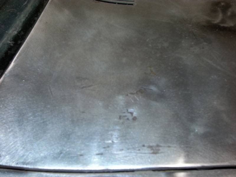

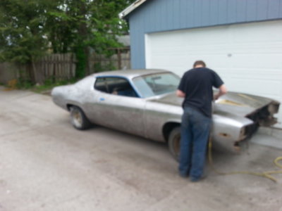

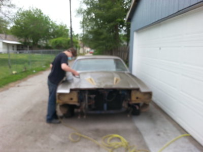

me and the boy took it out side in light of day to see any deep surface rust and sand blasted it before primer
20160425_203941.jpg 20160425_203953.jpg 20160501_155557.jpg 20160501_155614.jpg 20160501_155635.jpg 20160501_174815.jpg

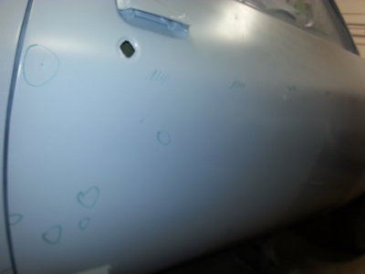

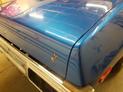

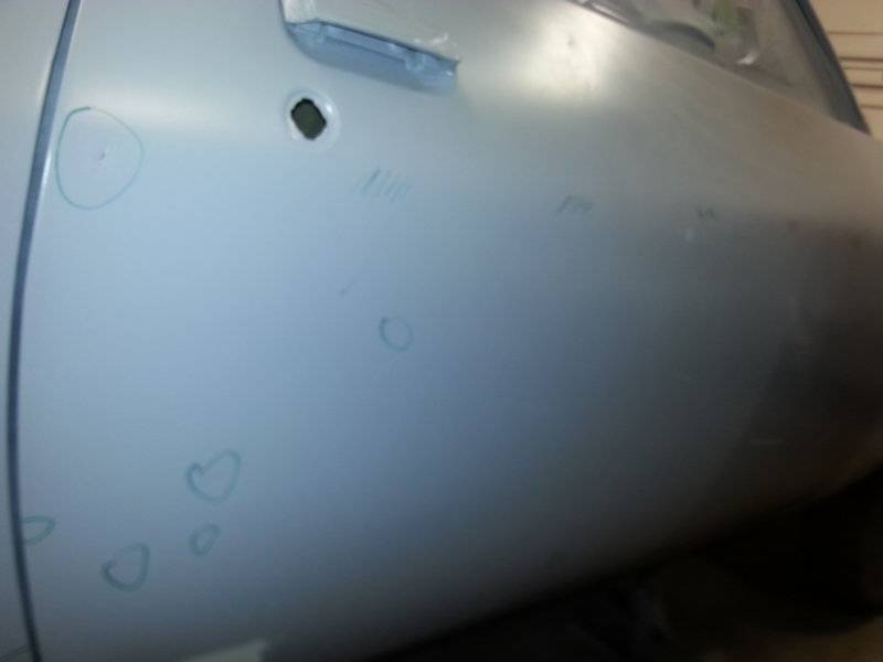

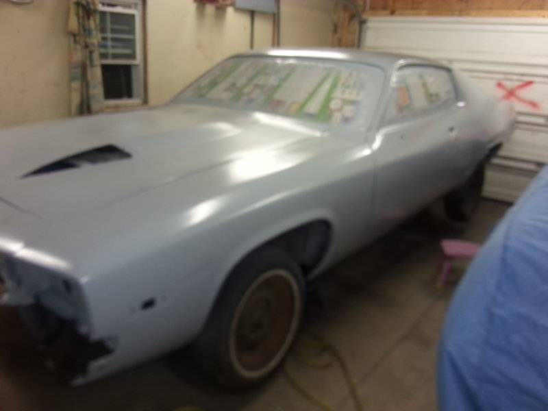

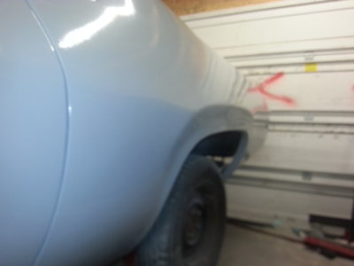

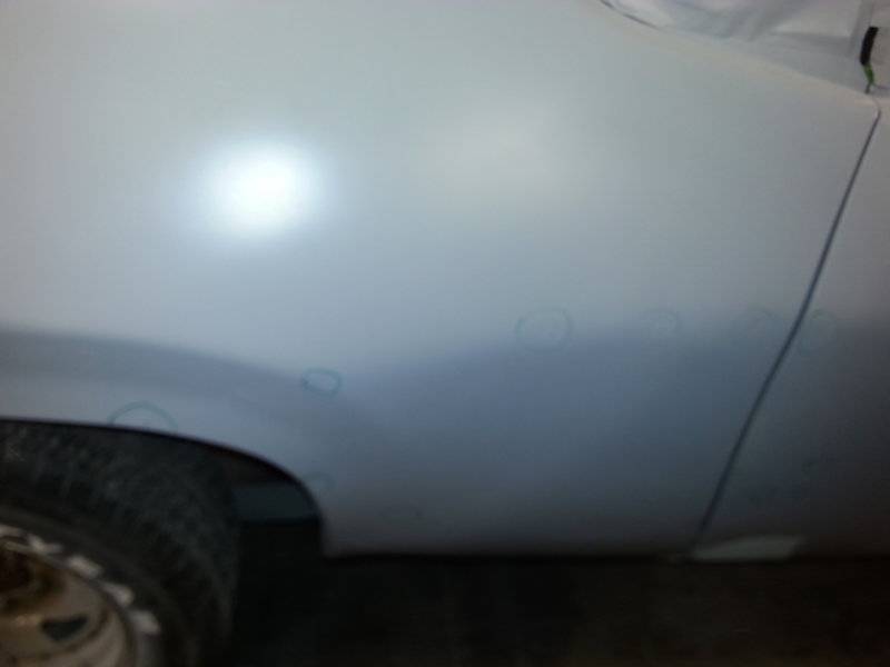

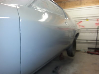

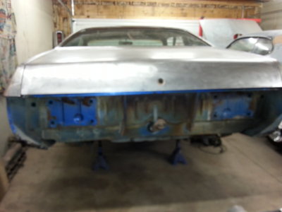

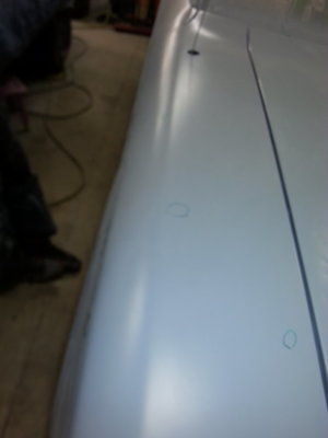

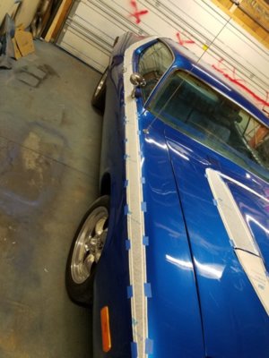

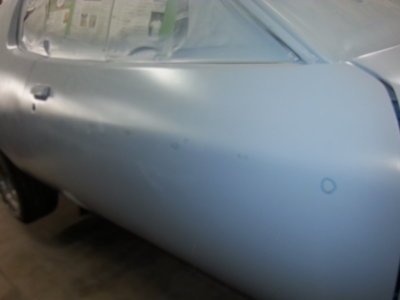

if you noticed i circled all the spots i could see while the car was shinny that would need attention.And now the sanding begins

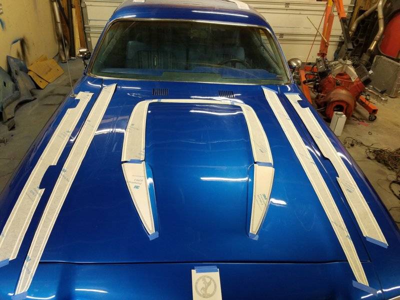

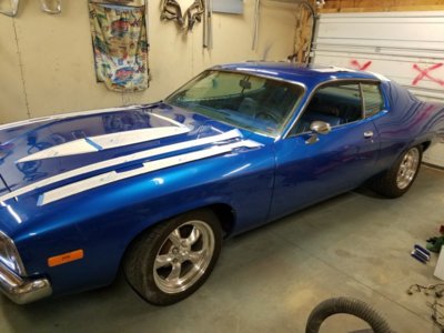

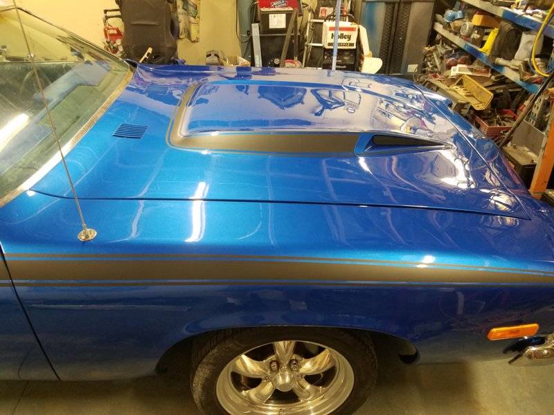

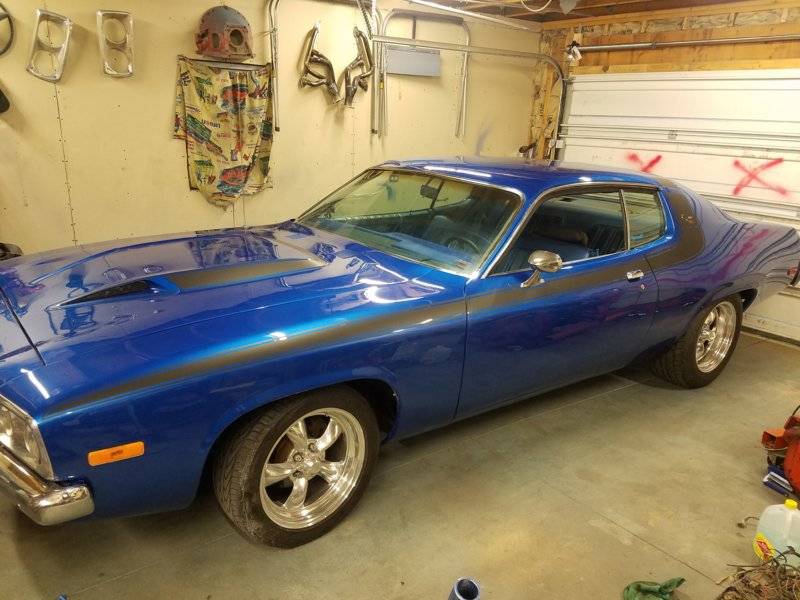

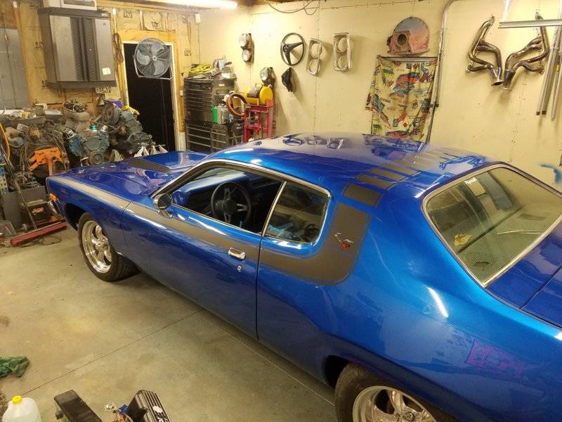

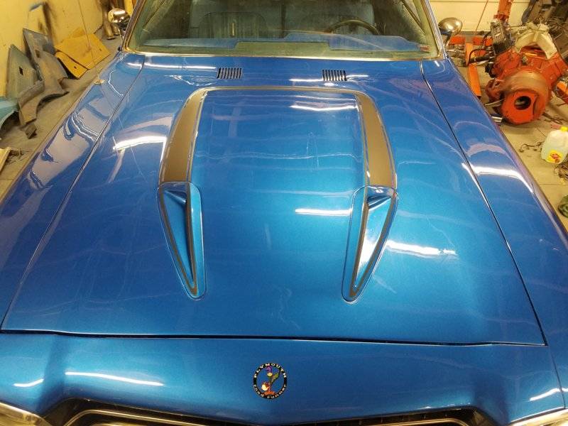

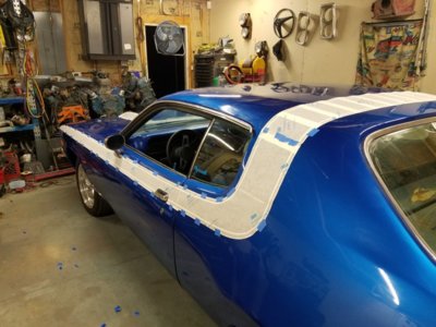

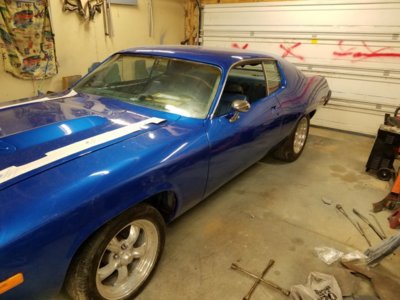

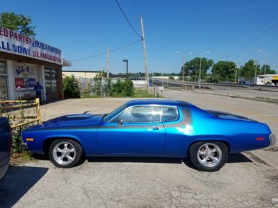

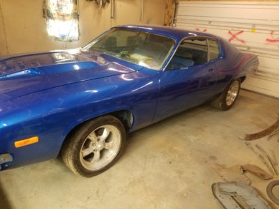

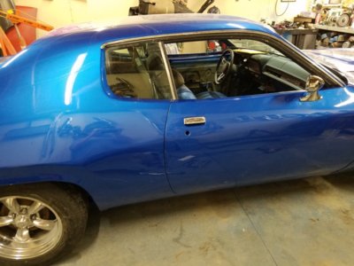

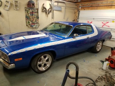

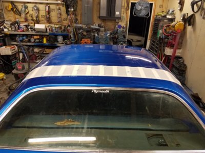

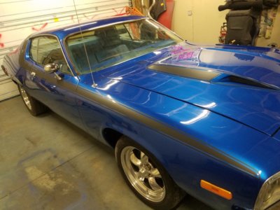

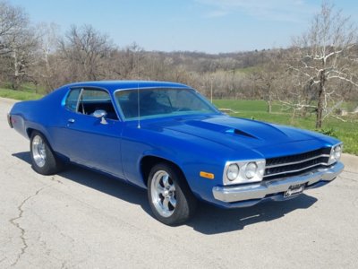

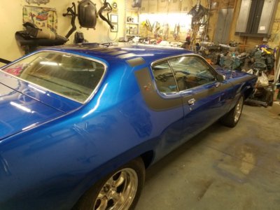

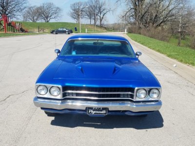

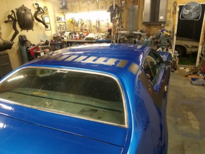

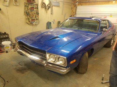

Thanks it only took 3 years. My duster took 7 years maybe my next one will be done in just a couple of years lol next one is 1973 charger rallye u code 440 mag.

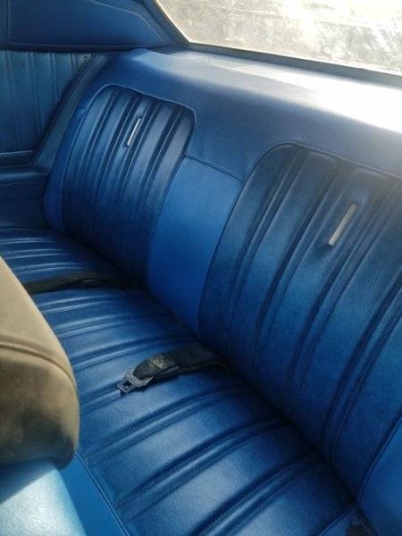

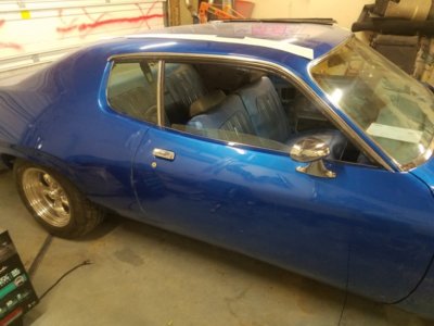

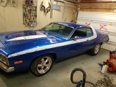

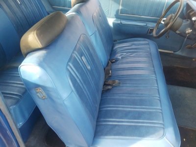

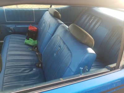

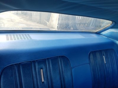

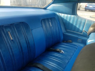

Interior. Got seat covers from legendary. And found the nicest panel I could use . Some had to be painted. Classic industry has interior paint 16 dollars a can . I got 4 cans and only took two cans for all the panels. Good stuff would recommend it.
20190310_171440.jpg 20190310_171500.jpg 20190310_171434.jpg 20190310_171504.jpg 20190310_171510.jpg
