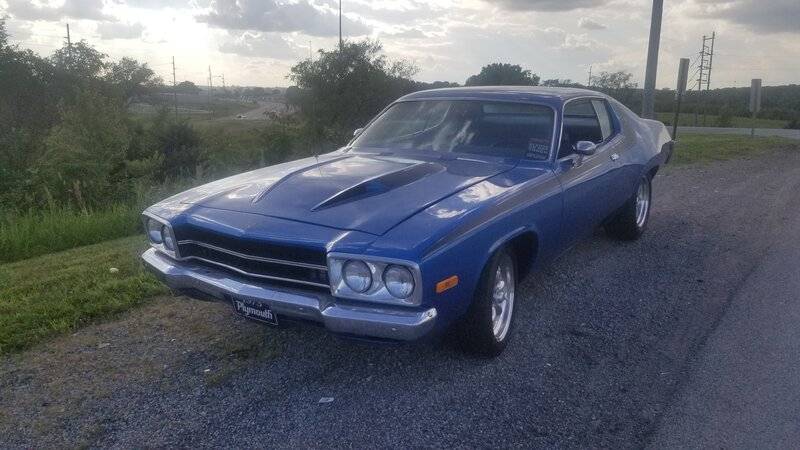

project daily driver

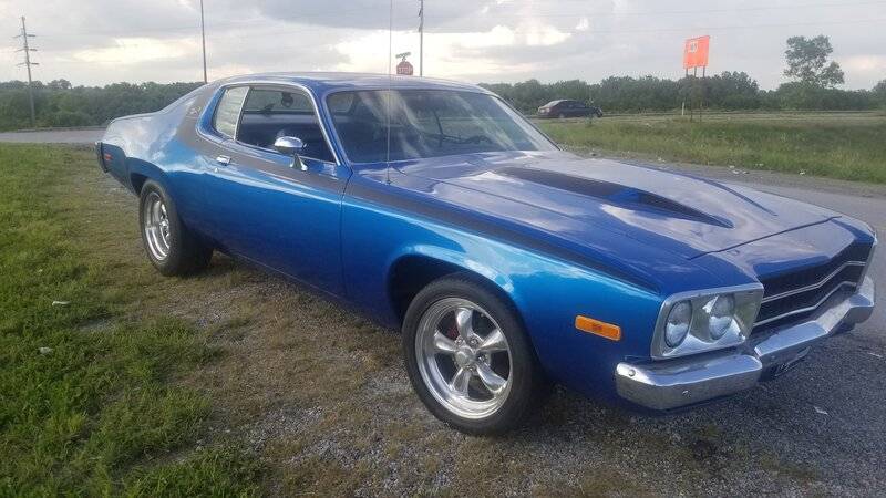

Excellent job and beautiful car.

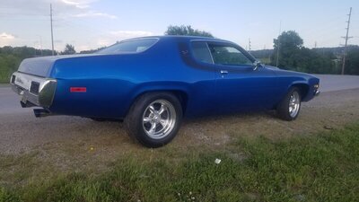

This will be second season I get to take it out to car shows. First season to not have to work on it. It's been a long road. But was a pleasure. I'm blessed to get the experience. And thankful for the knowledge on lone from God.

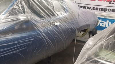

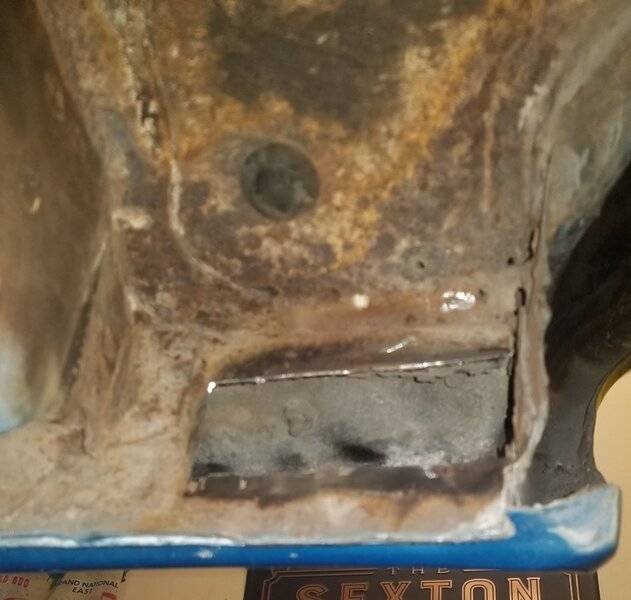

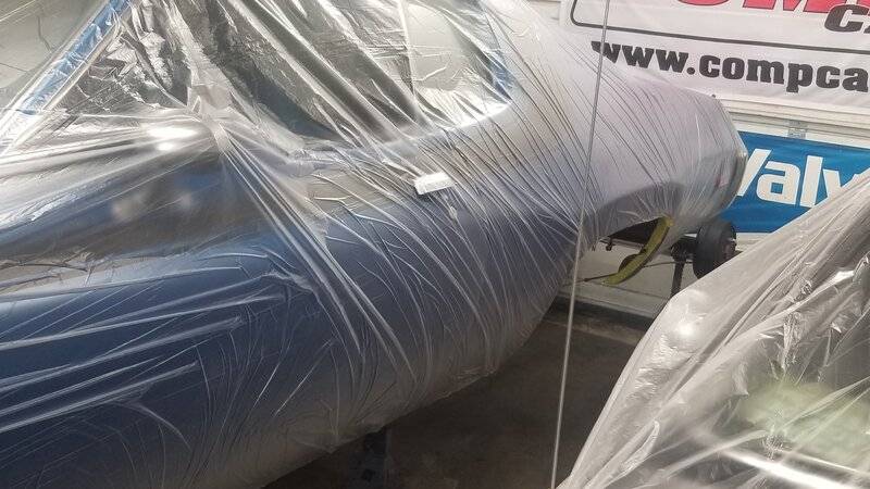

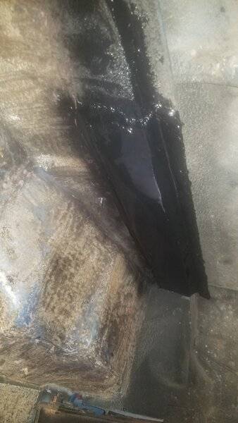

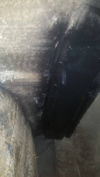

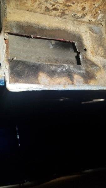

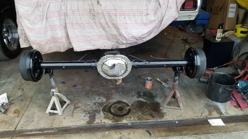

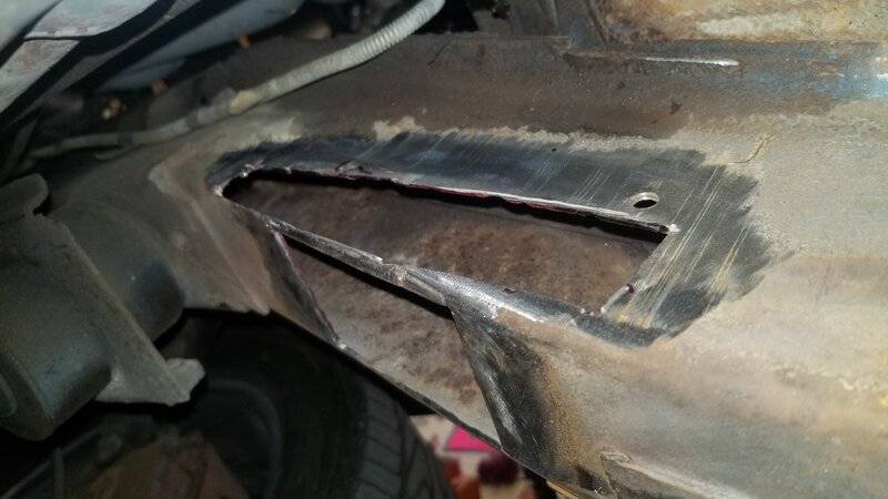

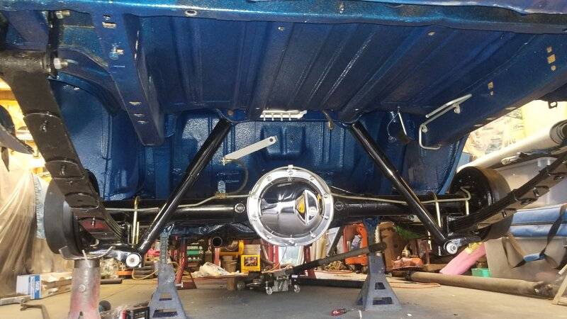

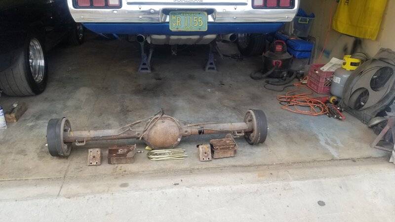

Finally after all this time I'm getting to the bottom side of the car rebuilt the frontend years ago and now I'm putting on new springs and bushings. Going to clean up bottom a bit and do some new under coating.

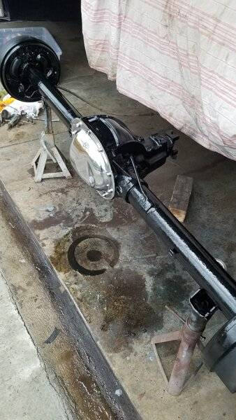

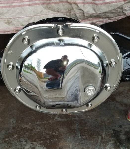

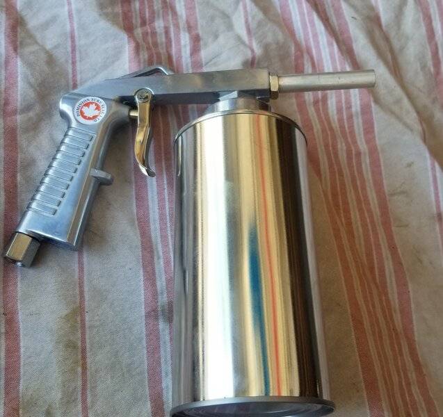

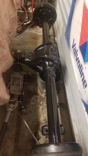

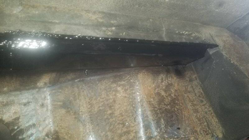

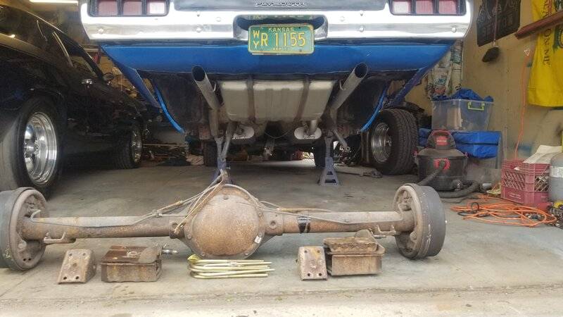

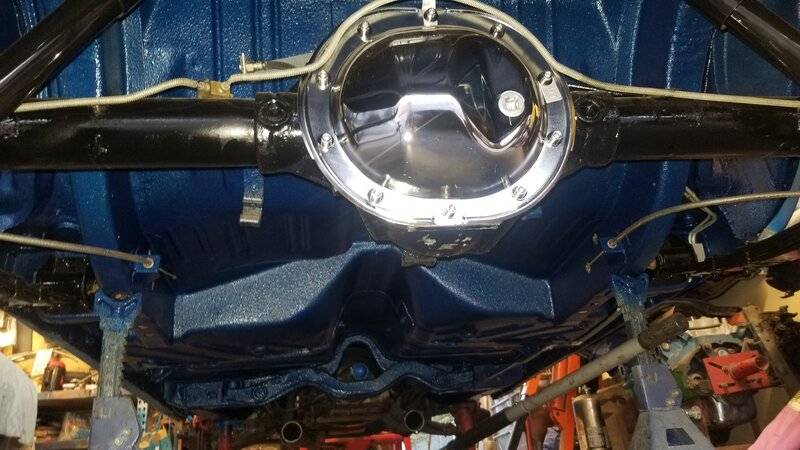

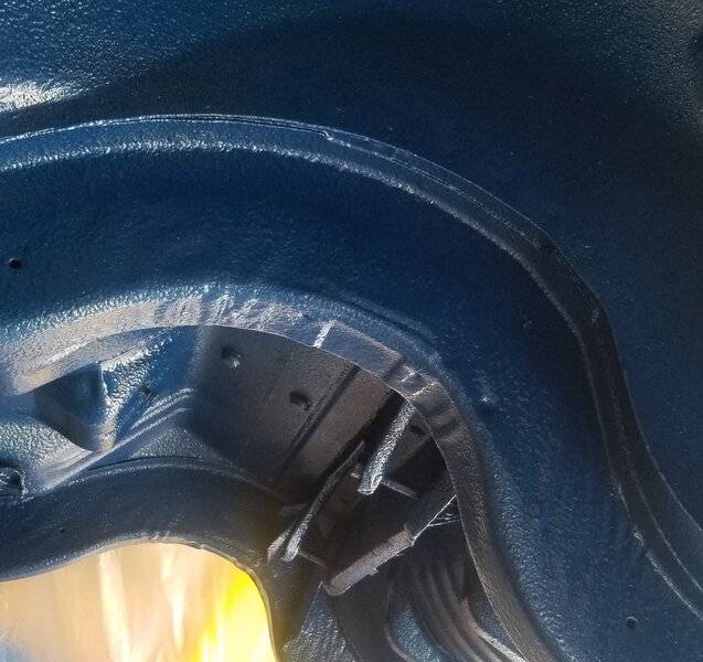

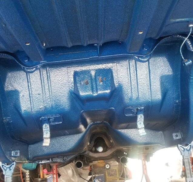

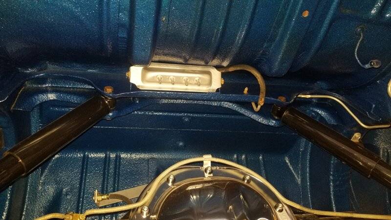

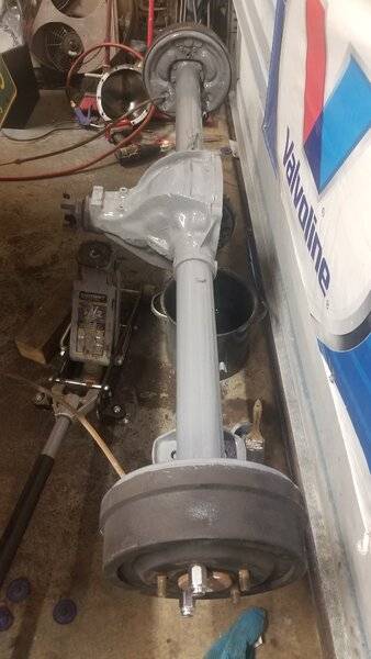

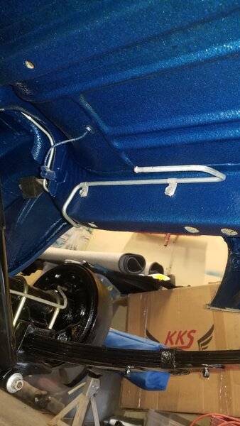

After a month and 1/2 of weekend warrior under this car all under coating scraped off, tinted blue armour bed coating sprayed 2 gallons, new leaf springs, new shackles,new front mount studs, new shocks, new fuel line front to back, redone exhaust to tuck it up closer to bottom. Cleaned all under car parts sand blasted and painted, all brackets transmission mount rearend cleaned new cover and painted with new oil,new exhaust tips.
