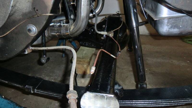

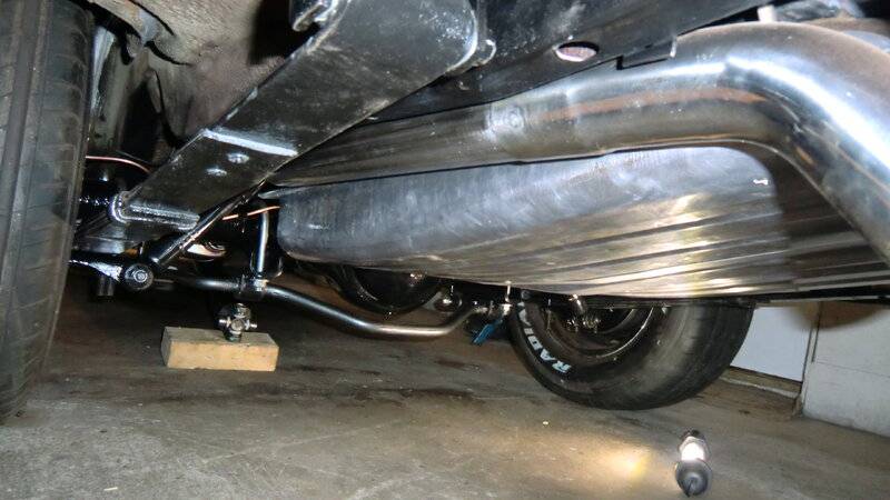

managed to lift the rear end in place with a jack.missed to order new original U bolts

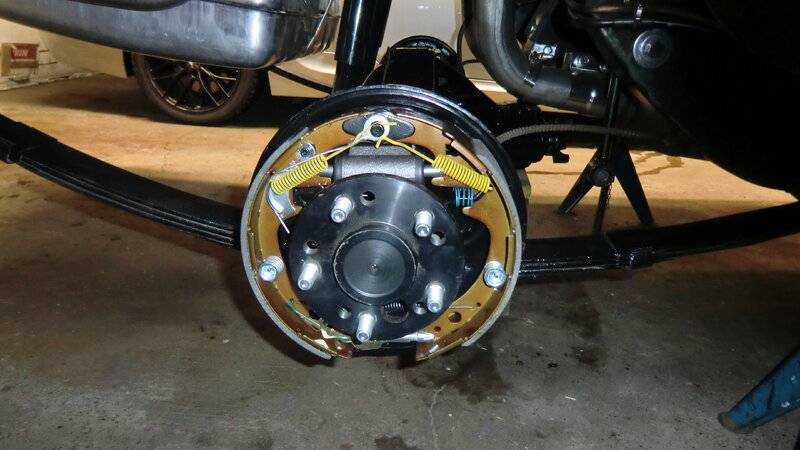

instaled new seal & backingplates.there is no
hurry to get it ready for the road winter is still precent
dr diff anti tapered axel kit is installed,a big improvment
flatened u bolts a little long but can be used if a want to try ss springs
clearence between leaf spring and tire 265x15

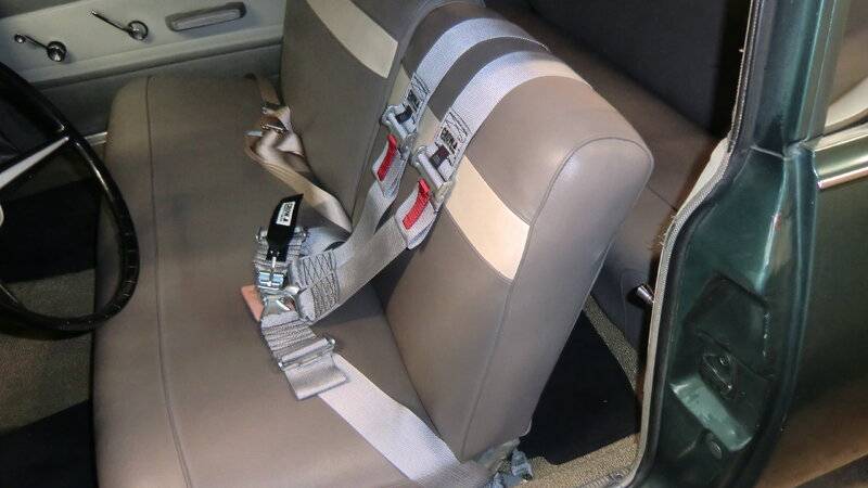

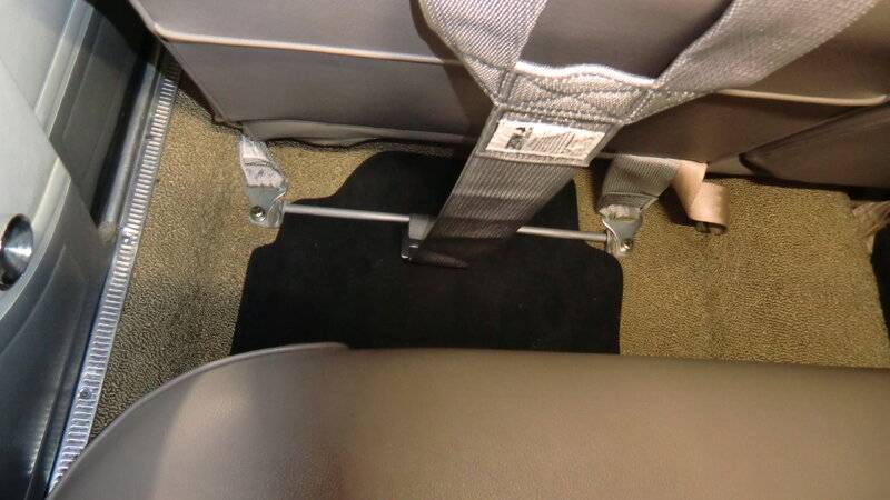

car on ground not much left to do on the projekt.going to install a safety harnes from CROW its ordered waiting for delivery
clearence between leaf spring and tire 265x15View attachment 1093908
Hows the clearance in front of the tire. Mine was close like yours looking at it from the rear but it was too close looking at it from the front. I should have used 4 -1/4" back space wheels in stead of 4 -1/2". Had to use 1/4" spacers.
Hi Kid! clearence in front of tire is 12mm= 0.472" got spacers with willwood discbrake conversion and a probably use them.have waited for mopar b body torque strap to appear in any supliers store but nothing has happened /Mike

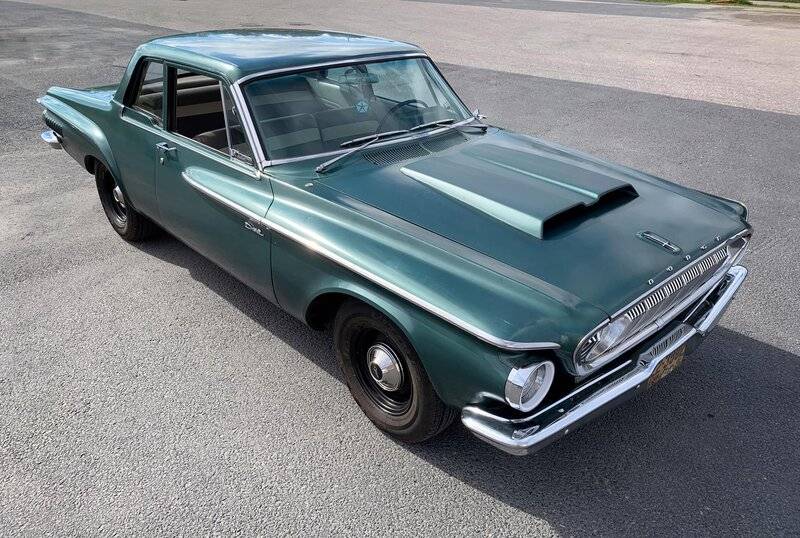

first drive checking for leaks, found that heater core leaks a little get fog on windshield.
the dart feels verry powerful gerbox shift nicly and the eaton trutrac works perfectly with no noice
a contrast compare to the vw 1950 25hp dart 534 hp calculated
but it`s fun driving despite primitivnes
