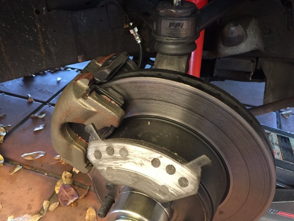

The replacement rotors are in from Joe, and they fit perfectly:
They also carry a completely different part number than the originals - G5311 / G11275W (Not to be confused with PRT5311, which is for a 2002+ Ford Explorer/Mercury Mountaineer) - and the UPC isn't even listed online.
Can't wait for the weekend. Got the calipers rebuilt and everything's ready to mount up!
-Kurt

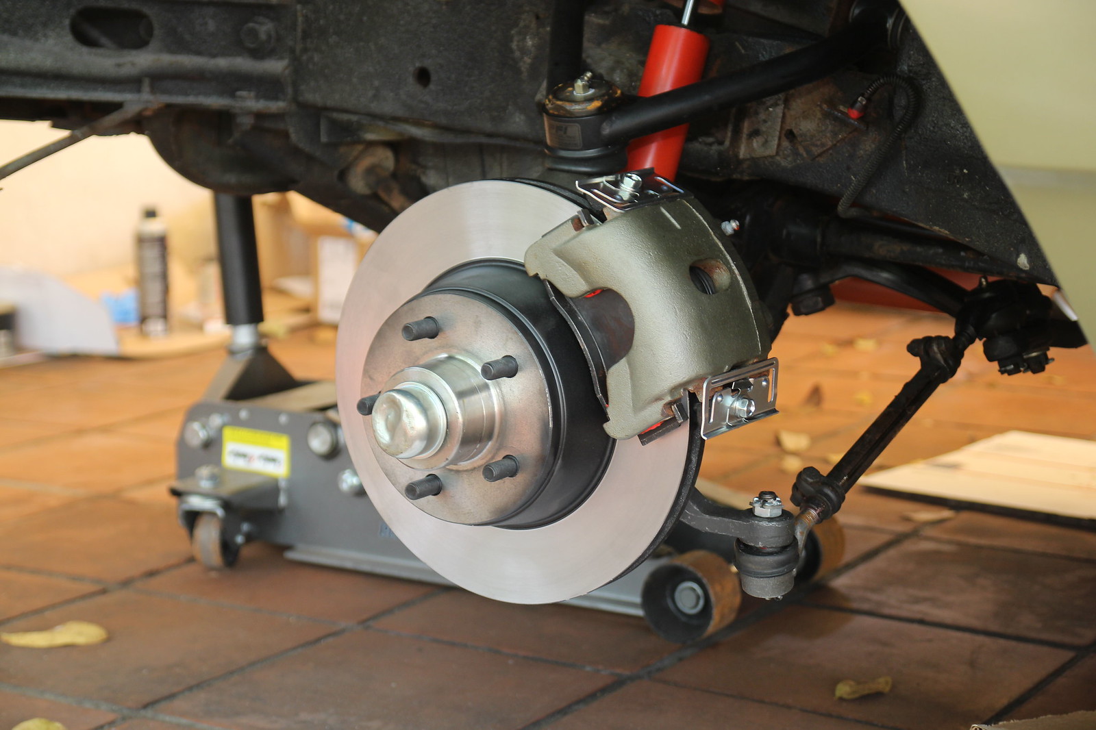

All's well that ends well - finally buttoned everything up today with the replacements from Bendix. Perfect fit. I quickly shot them with a bit of high-temp black paint before having one of the local shops machine the surface. I didn't have to mask off anything to get a nice look, and the pads have a better chance of breaking in evenly.
F/M/J Disc Brake Swap on '68 B-body by cudak888, on Flickr
FYI: Those drilled rotors that I tried earlier had a completely crap fit with the dust caps. Either way, I had to bash them to make them work. Not that concerned about it.
I also go over the '69 Camaro brake lines I used with this rear-facing F/M/J brake swap and a few other things - like the proper fit of those stupid anti-rattle rubber bands - in the post I made this evening in my main build thread: https://www.forbbodiesonly.com/mopa...t-refurb-and-big-fat-engine-swap.96118/page-9
-Kurt
