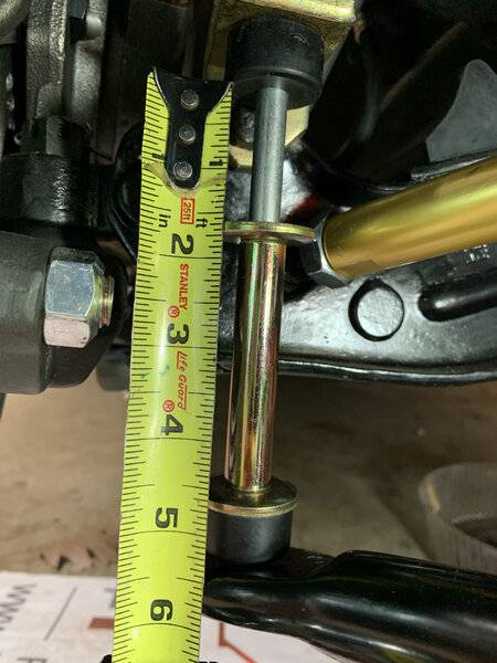

Thanks for jumping in James @PST . I am running the QA1 strut rods. The shaft diameter is 7/8" thick. Right now, I have not sent the car for an alignment, its still not finished. I adjusted the rods to the same length as the stock ones as a starting point. I do still need to align it and crank the torsion bars up a little too. Is it possible to flip the L bracket on the lower shock bolt? There is a little space between the strut rod and the long end link spacer. Whats hitting is the bottom washer. Also, the hump that goes over the center radiator core support is only about a 1/4" from touching the bracket.

James, @PST I just set the car on the ground, cranked the torsion bars up a little more and turned the wheels lock to lock and then let it settle in the middle and the washers are still touching. The front part of the sway bar that humps over the core support brace is about 3/8" from touching. Is it possible to flip the upper brackets and install it that way?
You could flip them around with no ill affect. But this the first time that I can recall having this issue. Can you double check the distance between end link eye to end link on the sway bar? It should be 44 1/2" on center If it were to narrow this could be the issue. I am just wondering if the thickness of the strut rods is part of the clearance issue.

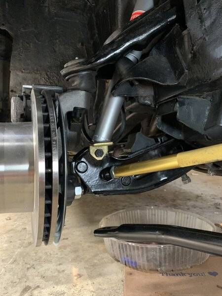

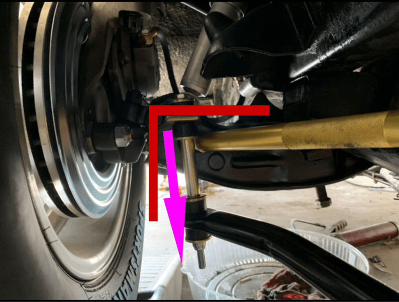

James @PST, I won’t be able to measure for a couple weeks as I’m away right now but here is a pic to show you the angle. The red lines are perfectly square to the ground and you can see the angle (arrow) the the sway bar links are at on both sides. They angle in and are not straight up and down. What’s the width of your strut rods? Is there a wider width sway bar that you sell that would work better? The clearance seems to be the height because of the way the brackets on the shock mount are. Factory control arm brackets sat higher than than the shock bolt. I just think if I flip the brackets that I’ll need longer stabilizer links because the sway bar itself can’t go up. Or it could be that I just need longer spacers because there seems to be extra threaded length on the bolt.

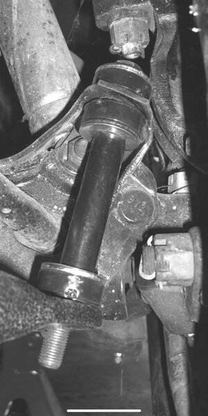

here is the factory control arm. I’m noticing how much higher the top bushing sits on this one above the height of the shock bolt vs where the bushing sits now on mine with the bracket on the shock bolt. I’m going to try flipping the bracket when I get home as that seems like it would position it relatively the same as the factory mount.

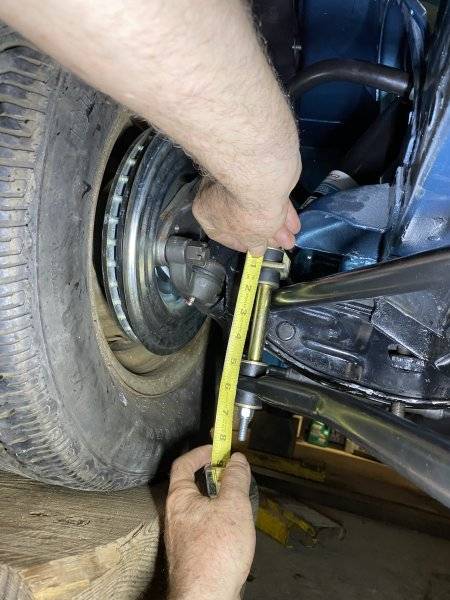

James @PST , just got back and pulled the sway bar links out and measured from the center of the hole to the center of the hole and I can confirm that the measurement is 44 1/2". I did notice that the supplied end links ran out of thread when tightening which makes me believe that the L brackets should be flipped on the shock bolt which would not only raise bushing from against the bar itself but would also allow the nuts on the end link to tighten and not run out of thread. Could it be that the instructions from PST that show the L bracket be wrong and in fact need the bracket to be switched? If so, I would need to use longer shock bolts and use washers to space the L bracket away from the control arm due to the lip on the arm
Flipping over the bracket would allow for more clearance in your situation. If you can give me the length of the bolts that you need we will supply you with new ones.

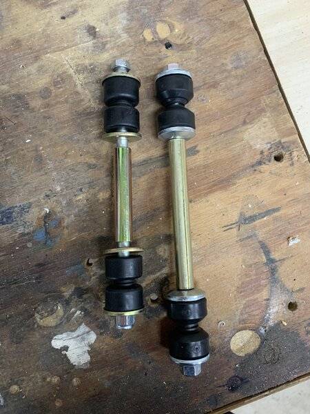

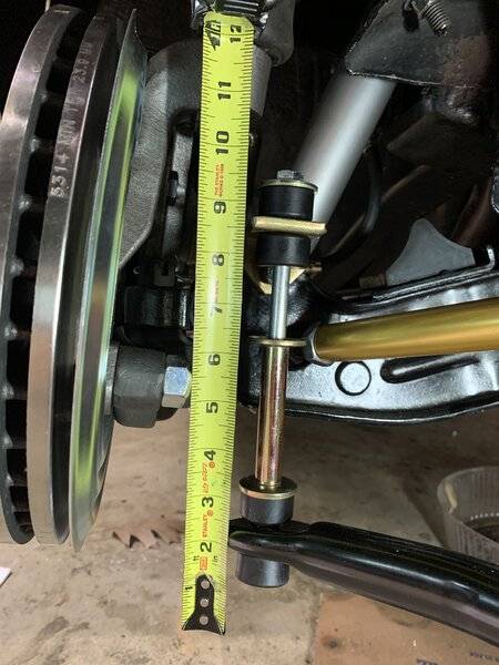

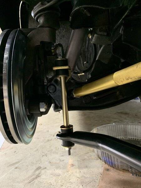

@PST James. I pulled it apart and flipped the bracket. Using the end link as a guide it looks like I would need a bolt that is 9-1/2” long with the spacer being approx 4-5/8” long to match everything up. Here’s a couple photos

All good now. James from @PST sent me knew end links that were longer. I flipped the top bracket on the shock mount and used the longer bolts and now we have lots of clearance to the strut rods. Thanks for all the help.

65 Sat- I came across this post last week because I have the same issue on my 65 Belvedere. Everything you ran into, I have as well. After all was assembled, do you think you could have used a 9” long end link instead of 9.5”? 9.5” seems like it would leave about 1” of thread exposed after tightening. 9” is what I figured might work best.
