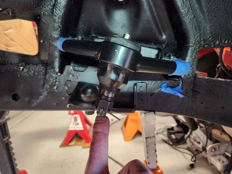

Hello all,
Starting to assemble front end which includes PST Tubular Upper control arms.
I fitted drivers side but see that the factory bump stop will not make contact with the arm.
Is this a problem and if so, can someone recommend bump stops that fit the application? I didn't see them on PST's website.
Appreciate and help...
When installed correctly, the ball joint mount is level to the ground. The picture above makes it look like the UCA is in correctly.
These should have been fitted with some way to contact the rebound bumper, maybe a section of flat steel welded to the forward tube.
I have a pair of PST tubular UCA in one of my cars. It sits PERFECTLY on the bump stop. Your install is wrong.
Right, I was thinking
So the one marked left is really the right side? When I compared other with it it looked like it would be much worse. Going to swap with other and post pics afterwards. Thanks all

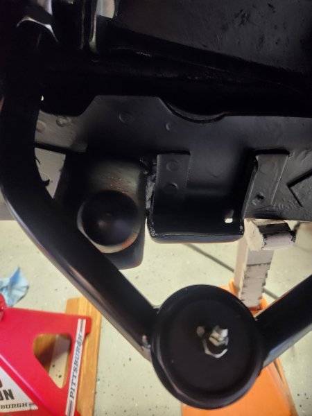

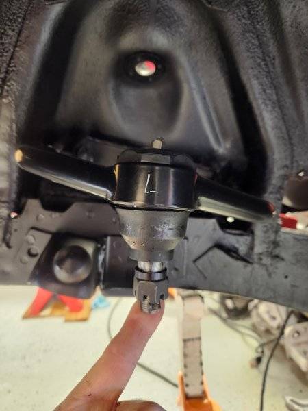

Thanks to all for their inputs. Here's images of the drivers side (left) but Upper Control Arm labeled as Right.
Looks worse aligning to bump stop and notice how the ball joint is tilted towards the front when parallel to the ground.
Looks like 1968VAGTX is right in that I need a different bump stop.
Would be really interested in what PST has to say?
Thanks all...
As I mentioned, the ball joint is level when the control arm is installed correctly.
CORRECT:
INCORRECT:
