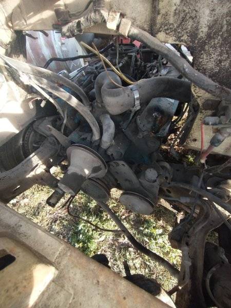

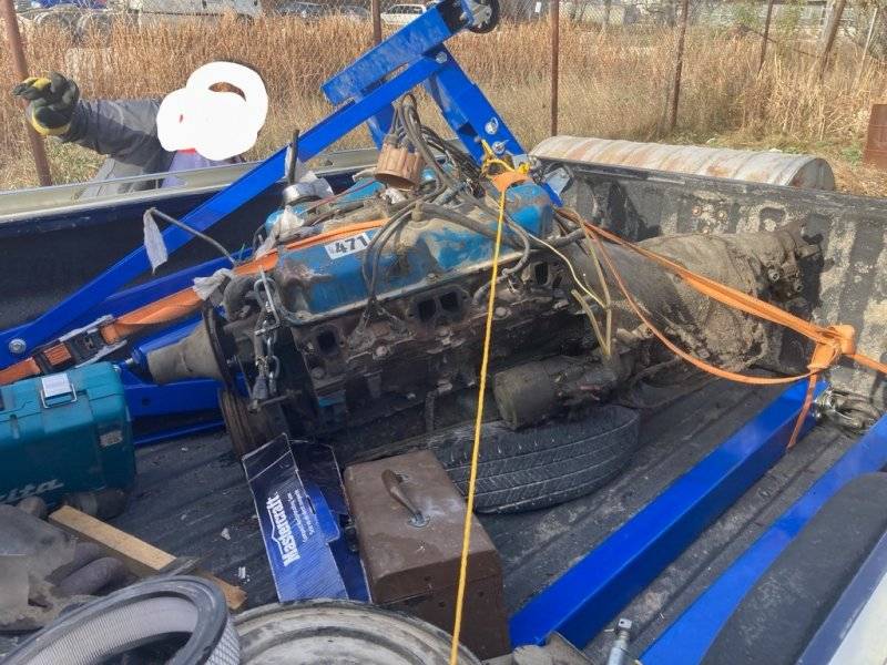

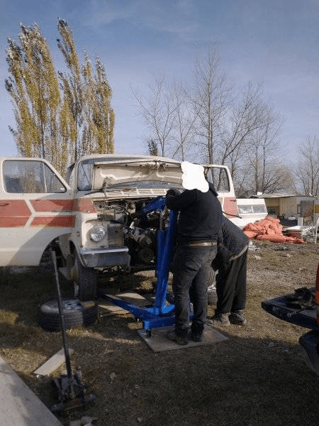

Ok! It has been removed. Unfortunately I had to leave the party and head to my real job while my Best Friend and our boys finished the removal. I'll probably take a closer look tomorrow and update you on what I find.

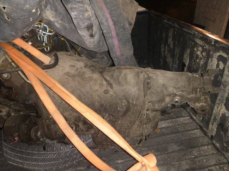

Likely good internals in the 727, unfortunately you would need to swap the tailshaft and housing to work in a car, not a big deal but just a detail that would have to be tended too. Your intake and TQ would be a worthy swap. As above, check for timing chain wear for sure and a compression test would be nice and is still doable on the floor although cold results will be lower.
I would bet being this motor home is a van based chassis. That it has a standard tail shaft and housing.

You covered the dude's face? Is he in the witness protection program or something?
