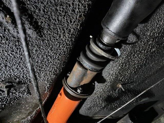

Hi folks, Newby here working through an engine swap on my 63 Sport Fury Convertible. I've read up on everything I can regarding pulling the drive shaft, transmission, engine, etc.
Tonight I was able to free up the rear of the driveshaft, and from all I've read, it should just pull out of the tail of the transmission. Mine will slide back/forth about 3" freely, but there is something stopping it cold when I try to slide it out. I pulled off the band clamps on the boot thinking it was the holdup, freed up the boot, but still something is keeping it in. Do I need to undo the nuts in the picture? I've got the shaft held up on a floor jack meanwhile, not going to force anything. Advice appreciated!
Remove the four nuts/bolts on the transmission flange, and it will DROP out. You are only exercising the ball & trunnion part of the shaft.
