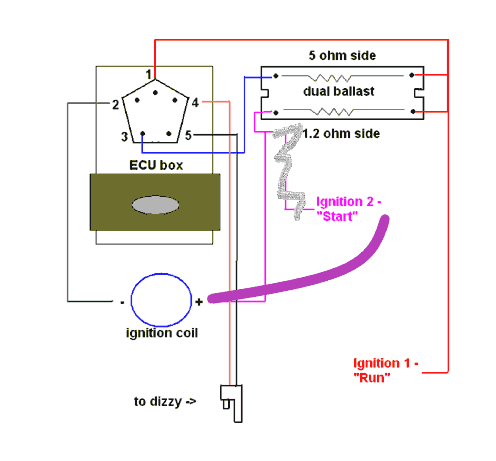

Hi, yes but my ballast has 4 wires in it two in and two out? so I don't know?? OH its all stock ..

Here's what I was trying to say, Ignition switch START wired right to coil not to the ballast (maybe) I've worked on a 75 but it was 35 years ago.
What is the condition of the battery cables and ground strap from engine to firewall?
What do you get for a volt reading at the positive side of the coil when you try to start and then let the key off to the run position?

It can crank the engine with bad cables, they will just have some additional voltage drop.
Because the ECU is grounded to the Firewall, it is possible to have the block ground and Firewall ground at different potentials (a ground loop problem) if there is no block to firewall ground strap.
Usually, it the ignition wants to fire at the release of the key cranking, it could indicate a ground loop problem.
You could test with jumper cables from battery ground to a good block ground (In addition to the original ground cable), and from block ground to firewall / ECU case?

Isolate and sequentially eliminate any variables.
I agree to make damn sure the ECU is grounded.
Poor ground there could cause all sorts of starting and running issues.
I'd personally use an alligator clip jumper to ground it and leave that in place for the remainder of the testing.
If the OP jumps the coil to the battery and then jumps the relay (with a known good ground on the ECU), the car should in theory start and continue to run until the jumper to the coil is removed.
If it does not, there is a bigger issue, as that basically bypasses all the system that could be involved in "the problem".
