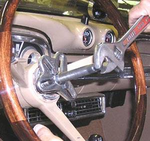

Don't use the claws kind puller, need to remove the center cap of steering wheel, and will find the threated holes for the bolt kind puller
not a Mopar, but same procedure
Yup....don't even think about using claws on a steering wheel! If you need to, get a repair manual for the car you're working on because the info is there....
And notice that the picture shows a harmonic balancer puller... it only costs about $5 more and you can use it to pull both harmonic balancers AND steering wheels (2-bolts). It's a piece of cake. There is one spline on the male end of the shaft & female hole in the wheel that line up so the steering wheel will only go back on one way. You will see it if you look.
