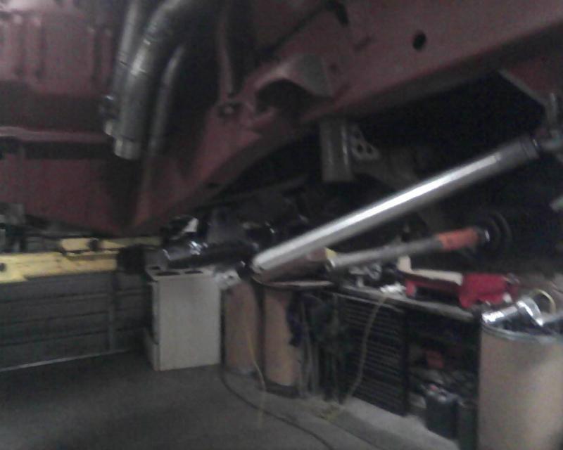

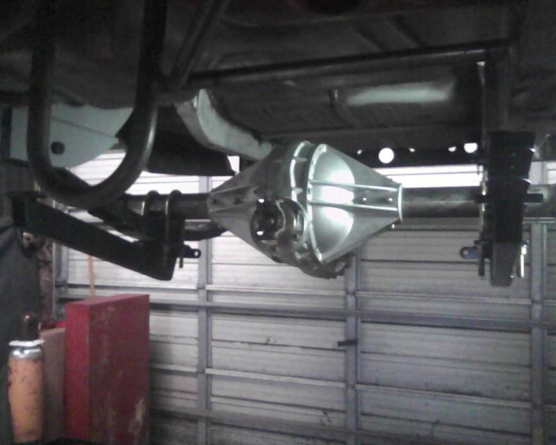

Think I may put a buld page up to show progress. Can I do that on my Profile ? So far here is where I am at with the drive line. Rlc.jpgLlc.jpgQC3.jpgQC2.jpg
Is that a quick change rear I see?? Friggin bitchin!!
YEP !!! It has a 31 spline Detroit locker in it and a 4:86 R&P. The Sper gears I have I can run 4:11,4:39,4:86, for rite now so I think I can tune it in close so far ? But its 15 min gear change !!
But I must tell ya its BIG !!! Like a FAT chick on a Sportster !!!! LOL!!

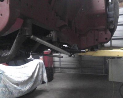

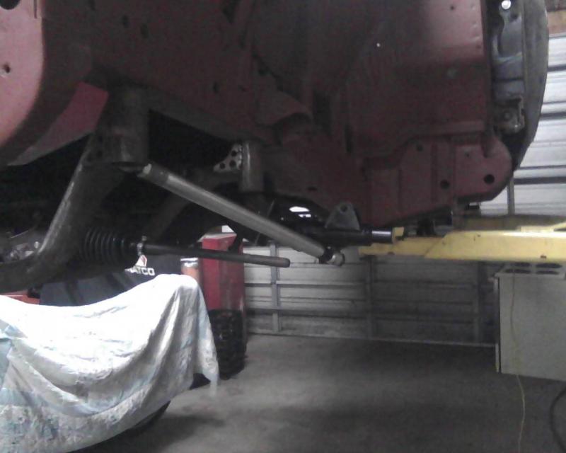

Got my front on today and must say I REALY like the QA1 arms. Also started to Mock up the motor and my fuel injection intake idea.Rf.jpgLF.jpgMtr3.jpg

That is too cool TJ and I imagine a first (the quick change) here on FBBO. I kept meaning to ask you about that. You should start a thread about your build with appropriate title. Just go to the restoration section or wherever you feel appropriate and start the thread like this one. I don't think we have a modified or handling section so resto section is closest I imagine.
Is that a QA1 K member? I've been looking into them, but what I found there was no definitive answers to whether a R&P could be used...maybe I just haven't been looking in the right places...that would be awesome...

No it is Not. I bult this K,member in house and it has No motor mounts or steering box mounts as it is made for a Rack and motor plates.
The QA1 has the motor mounts and the steering box mount the intergradedid into it. I was talking with them and thay don't offer a K,Member for a rack. I am not sure if there is one that uses a rack and stock 'T' bar setup thats why I bult my own.
