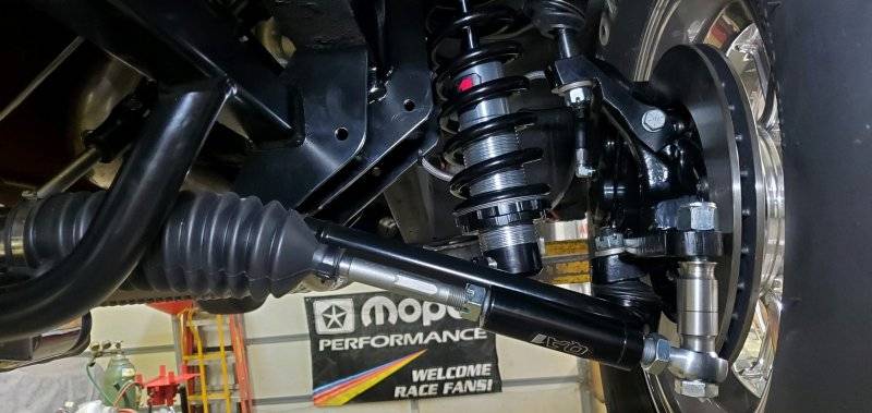

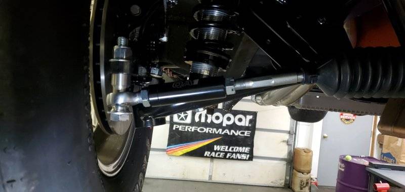

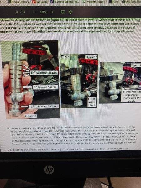

It definitely has less travel. I own the exact same car with the stock stuff. Turning tight into my hoist bay mine will make it in one try. The QA1 car will not. Also it needed double the suggested spacer on the outer tie rod to get the bump steer anywhere near to close. That cantilevers the tie rod pretty far away from the steering knuckle. It appears that they have the rack mounted to low for extra pan clearance. That means the tie rods have to be low as well. Pic #1 is with the suggested spacers. notice the tie rod angle and lower control arm angle. Not even close. Pic #2 is where I roughed it in before alignment. QA! said I knew nothing about bump steer. Then a few months later the owner the owner received this sheet (pic#3) from QA1. Looks like what I did months before. My drag car has zero bump steer with 95% factory stuff. Runs thru the 1/4 over 147 mph on a regular basis. The big weight savings is trimming the K frame, manual steering and light brakes.
