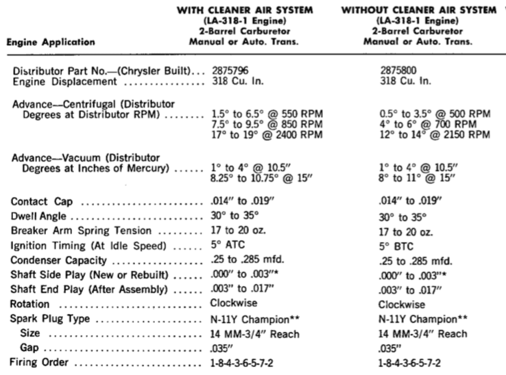

What in the F? Totally screwed me up on that one! ...it's all BTDC, where's the positive # coming from? .....come to think of it, why is After TDC even on the tape/balancer? Who the hell uses that side?!!LOL new math. Where ever you set the initial you add the total mechanical to it. Starts as a negative number then past 0 and final result is positive if that makes sense. -10 +30 = 20
No, 1st thing is to open up the distributor and see what number is on the plate.So I have -18 initial now, that means I would add another -18 to get -36 total?
I think that the ATDC marks are a byproduct of points. As the points get older and develop arc spots and if the rubbing block wears they don't open as far and the timing becomes retarded. So it's possible to put a light on the car and see the timing go late.What in the F? Totally screwed me up on that one! ...it's all BTDC, where's the positive # coming from? .....come to think of it, why is After TDC even on the tape/balancer? Who the hell uses that side?!!
Timing does not effect dwell but dwell does effect timing. You might loose a degree or two with wear but not enough to go "after top dead center". If the points were that worn the engine probably wouldn't even run.I think that the ATDC marks are a byproduct of points. As the points get older and develop arc spots and if the rubbing block wears they don't open as far and the timing becomes retarded. So it's possible to put a light on the car and see the timing go late.
Timing does not effect dwell but dwell does effect timing. You might loose a degree or two with wear but not enough to go after top dead center. If the points were that worn the engine probably wouldn't even run.
Many stock specs are close to 0 or after top dead center especially CAP cars (clean Air Package)
Curious, if the timing is retarded, wouldn't that make the engine run hotter than it should?On a precomputer carbureted car, one way to get under the HC and CO limits is to retard the ignition timing. This will slow the idle and provide a longer, hotter burn.
Possibly but not enough to cause overheating.Curious, if the timing is retarded, wouldn't that make the engine run hotter than it should?
Sorry but that is just incorrect. It's always negative you are going further BEFORE TDC as you add advance.
For example you start at -10 initial add 26 more centrifugal as you speed up the motor and advance to -36 Before Top Dead Center.
