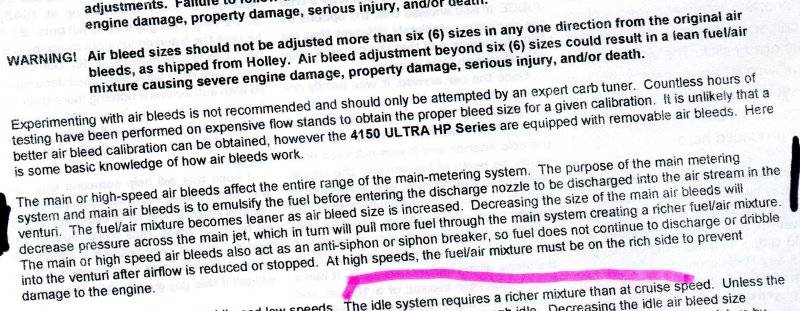

Below from Holley....
Before changing the air bleeds, I would try some bigger power valve feed restrictors.
