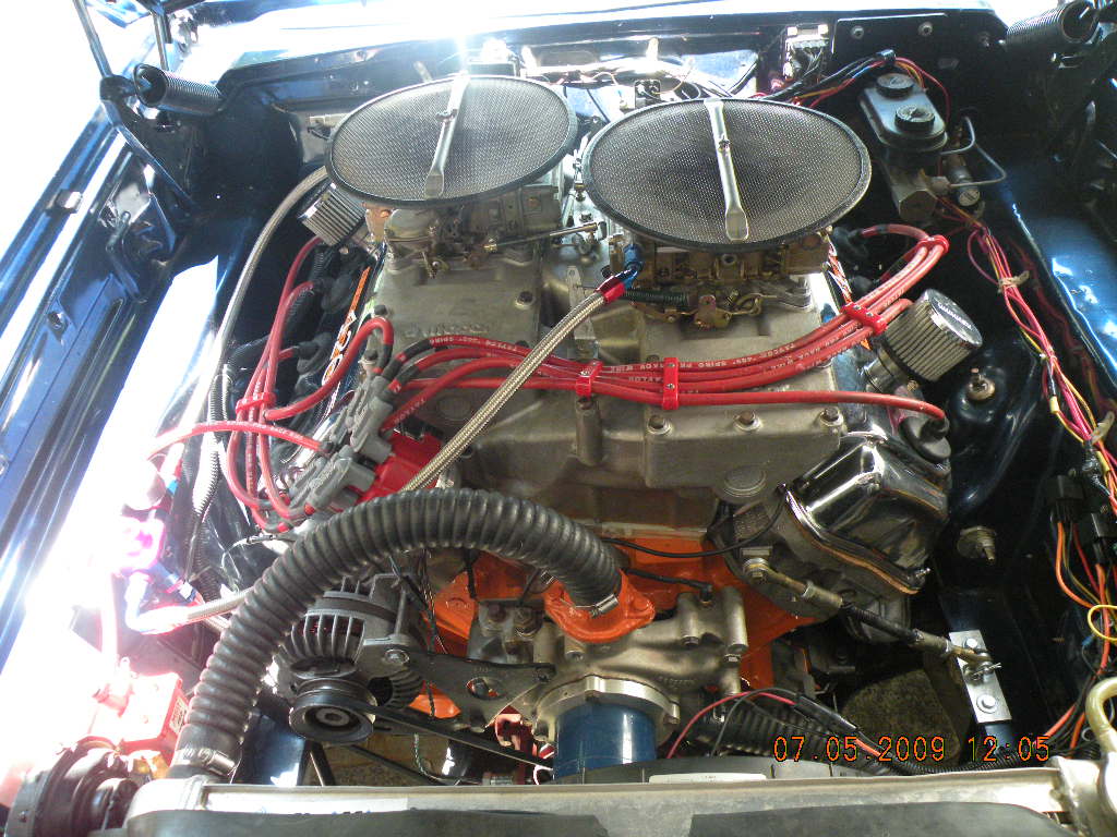

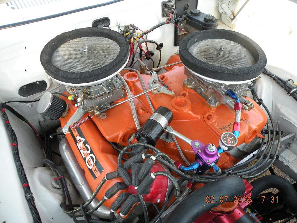

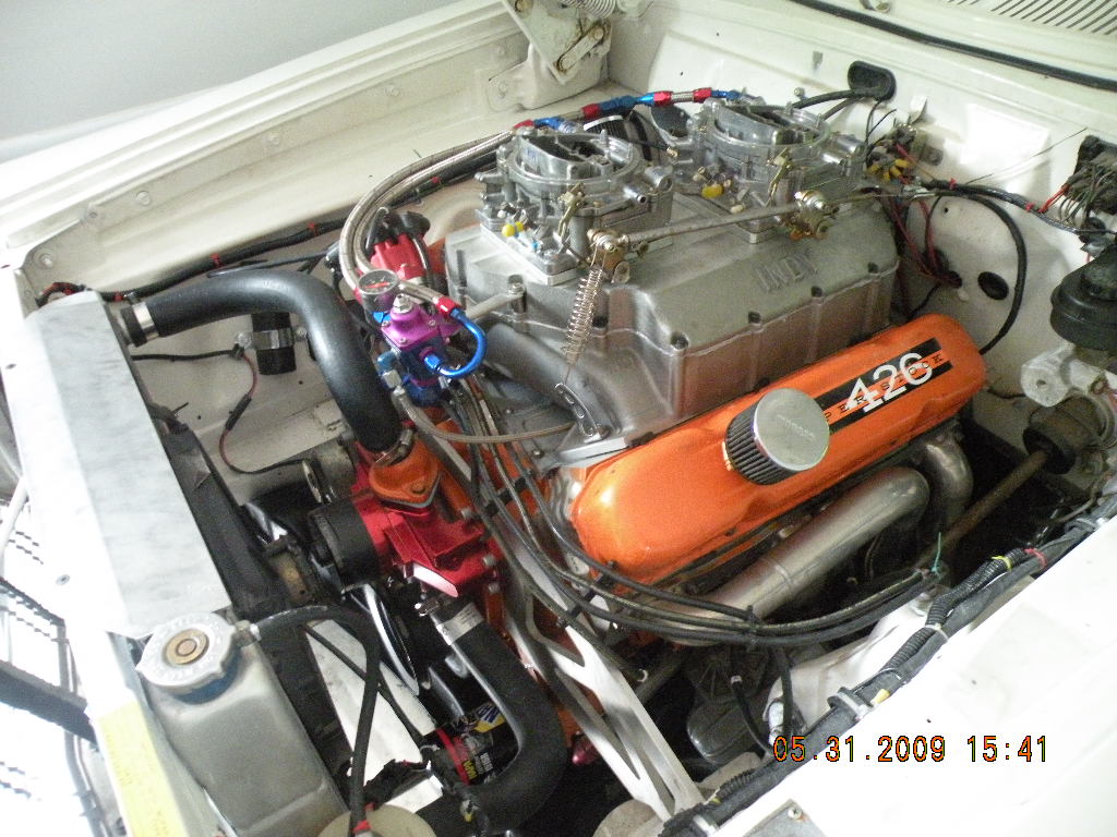

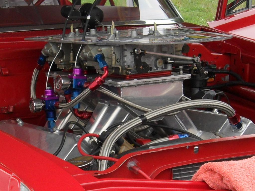

NGK R5672A-9 vp race fuel 108 octane 12.66 comp. indy sr stage 1 port

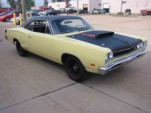

Throught my experience with Racing Sleds and working in speed shops. Autolites are the best for high compression/high cylinder pressure applications.
yes autolites are good too. i run them in my pure stock A12 Superbee
