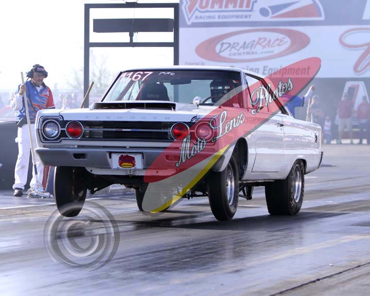

Im trying to get a handle on Hoosier 30 x 10.5 x 15 Radial slicks.
I have heard that you need to run 22 lbs at the track for them to work also having a fairly heavy car you would think you would need more air pressure. WRONG!!!!
1st pass was spinning like I was on the street. Couldn't hook whatsoever.
So there was a guy there who was running them on his Camaro and he weas sdame weight as mine and he said he runs 10 lbs.
anyone have any real world experience with radial slicks not drag radials.
