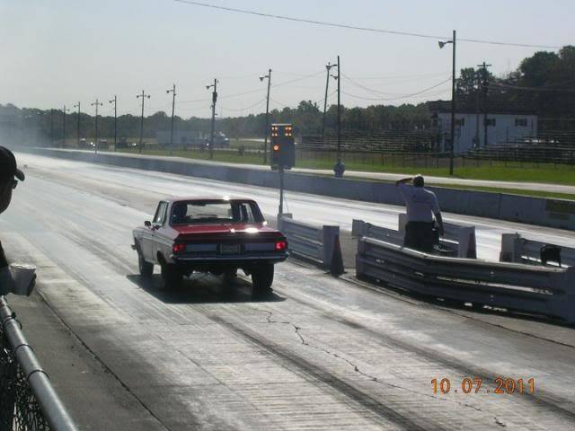

I just put them on my hemi belvedere to try out again this weekend. going to try 14-15 lbs. 1st pass. If I hook ill keep going up in PSI till it spins. I am only giving them 1 shot, if I spin they come off and the 29.5 x 10.5's M/T go back on for the rest of the day.
15lbs. chattered the tires like it had teeth .i thought i was going to lose my teeth on the hit. Looks like 17.-18.lbs. next time out.
