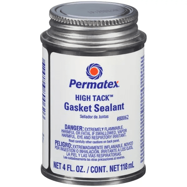

Snap-on Tools made a great pair of Corbin Clamp pliers....a little better leverage, swivel end holding the clamp for positioning.....plus I have always used Permatex red "Hi-tack" sealant on I.D. of the new hose ends for a leak proof fit-up......just a thought......

Never used the INDIAN HEAD matetial...preferred High Tack......easier clean up......just another way....BTW....the Snap On pliers are ~ $32.00
