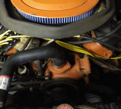

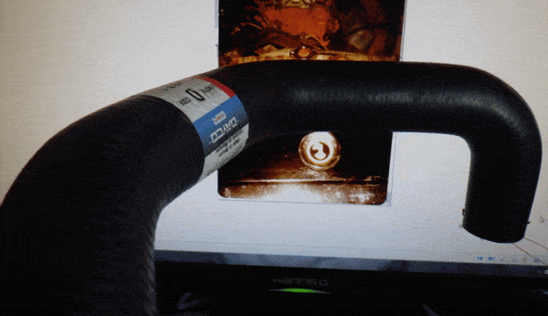

If you need something to get by maybe a Dayco 71281 trimmed to suit can help..........................
Here's the fit with a straight neck and 26" radiator............Dayco71281B.gif
