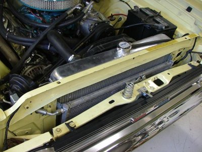

I've got the ECP 26" with a shroud in my GTX. It runs about 190 in the DFW heat but goes to 200 with the A/C on.
That is working well then Don. How long have you had the ECP?
I just bought the car but the radiator is fairly new. I need to add a coolant recovery system to the car.
