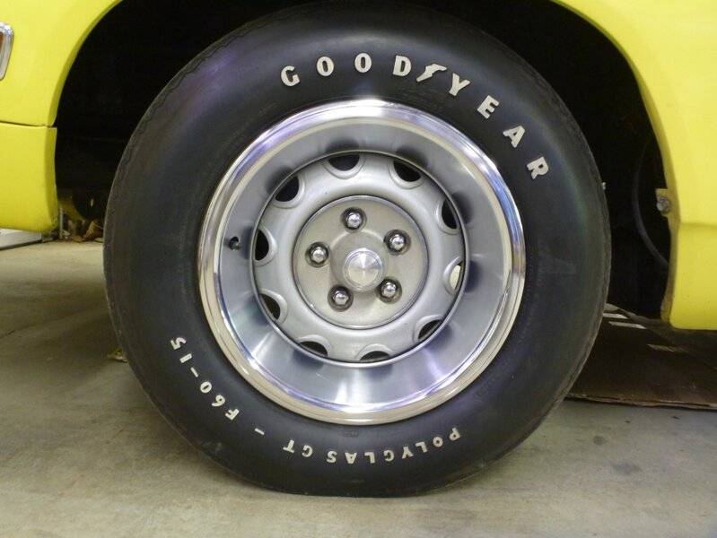

The rubber dries out and acts more like a sponge absorbing oils and leaching chemicals from inside the tire leading to browning. A problem since before there were even RWL tires, 50's and 60's and 70's tires were mainly W/W. The Redlines and RWL tires of the 70's were for performance type cars are were in the minority of tires sold. There were white grease crayons for touching up these problems. They sealed the rubber and being a grease would soften the rubber on the surface.

Ditto on the Radial T/A I gave up on them when Kelsey came out with the retro lettering on a radial, unfortunately I think they only have one size, fortunately it was my size FR70-14 nice white letters
